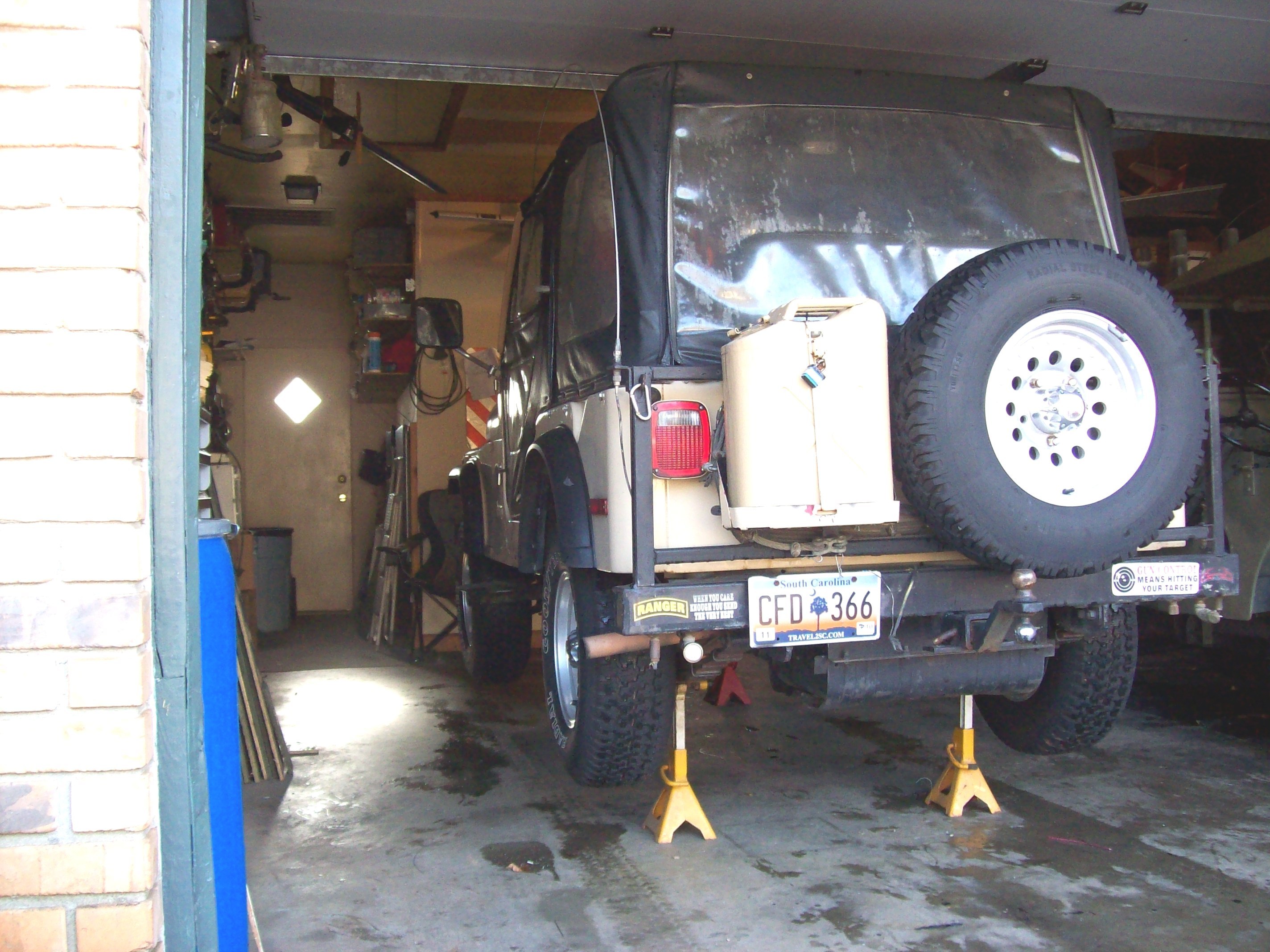

I have a Jeep that has an older 304 V8 installed w/3 speed manual transmission and transfer case. It runs fine but in 2wd the drive shaft turns but the rear wheels do not. It will drive in 4wd, but not 2wd. I have pulled both 2 piece rear axles and neither are broken. I have looked closely at the ring & pinion gears as well as the spider gears and they all look fine with no debris in the rear end case. The ends of the axles also look fine, no damage on the splines going into the rear end. I did find that the hub splines had spun on the drivers side axle, and while it needs fixed I don't think this is why the Jeep will not drive forward, as the right rear is the primary driver (it does not have posi-trac). Any help would be greatly appreciated!

GONNA GIVE YOU A COUPLE OF WAYS TO TEST THE CRAPPY 2 PIECE AXLES
1ST WAY)
PUT THE REAR AXLE UP ON JACK STANDS
IN 2WD SEE IF THE WHEELS WILL TURN WHEN IN ANY GEAR (THE WHEELS ARE NOT UNDER LOAD, ONE OR BOTH WHEELS MAY TURN)
IF YOU GET TURNING (IN THE AIR), YOU MOST LIKELY HAVE STRIPPED THE AXLE/ HUB
2ND WAY)
IF YOU HAVE A STANDARD DIFFERENTIAL (NOT A POSI-TRAC) ALL POWER GENERATED THRU THE DIFFERENTIAL WILL TURN THE AXLE/ WHEEL THAT HAS THE LEAST TRACTION
THIS ALSO GOES FOR A MUFFED UP SPLINE IN A 2 PIECE AXLE (THE AXLE WILL SLIP IN THE HUB, BECAUSE THE THE WHEEL HAS YOU ANCHORED TO THE GROUND AND IT'S JUST SO MUCH EZier FOR THE "NOW WOLLERED OUT" HUB TO ALLOW THE AXLE TO SPIN INSIDE OF IT, RATHER THAN TURN EITHER WHEEL
REMOVE THE DUST CAPS THAT ARE OVER THE AXLE NUTS
HAVE YOUR PAL STAND ON ONE SIDE OF THE JEEP THEN THE OTHER, AND WATCH THE NUTS AS YOU LET OUT ON THE CLUTCH IN 1ST GEAR WITH BOTH WHEELS ON THE GROUND. IF THE NUT SPINS ON ONE SIDE, IT'S TIME FOR NEW AXLES! (IF YOU ARE REAL ALERT AND THE OLE 304 AIN'T MAKING A GOSH AWFUL ROAR, YOU CAN USUALLY HEAR THE STRIPPED AXLE MAKE A STRIPPED KINDA RACKET
IF THE HUB(S) HAVE EVER BEEN REMOVED FROM THE AXLES, MANY TIMES THEY JUST WON'T "BITE" OR MATE UP AGAIN AND WILL STRIP. THESE PUPPIES REQUIRE 250 FT-LBS TO CUT THEIR OWN SPLINES. USUALLY WHEN ONE STRIPS, IT INTERNALLY CUTS GROOVES 'ROUND AND 'ROUND THE AXLE AND HUB. THESE GROOVES KINDA ACT LIKE LOCK RINGS AND IT IS IMPOSSIBLE TO REMOVE THE HUB WITH A HUB PULLER (OR ANY OTHER TYPE) GENERALLY, YOU CUT THE AXLE OFF WITH A SAW-ZALL AND REPLACE THE AXLE AND HUB
