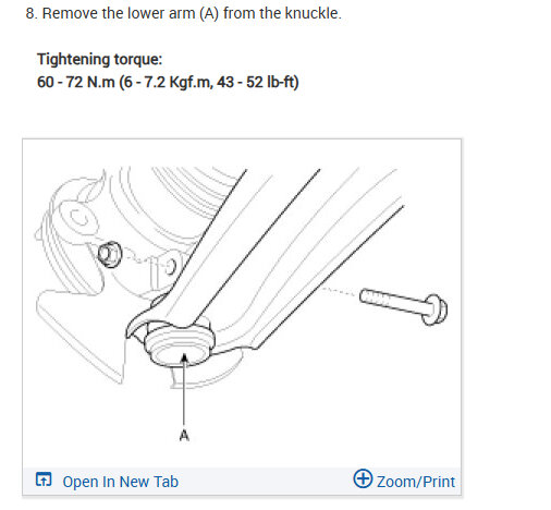

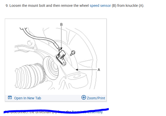

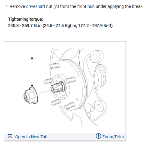

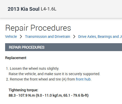

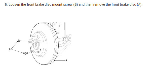

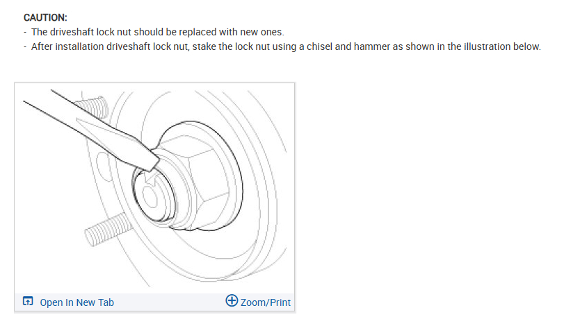

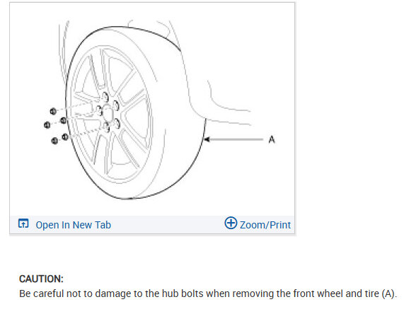

Do I have to take the tire off to take apart the driveshaft assembly to take the transmission out?
2013 KIA SOUL
140,000 MILES • 1.6L • 4 CYL • 2WD • MANUAL
JEFFREY BALDWIN
  • 5 POSTS
Transmission removal.
Dec 1, 2024 at 8:45 PM
  • 110,194 POSTS

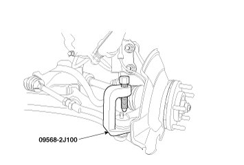

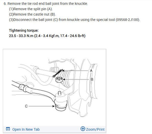

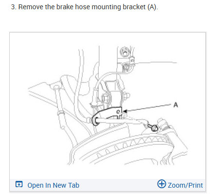

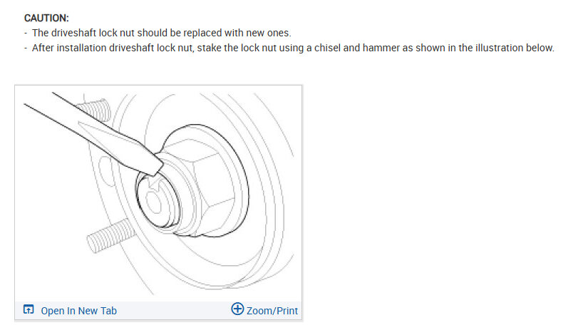

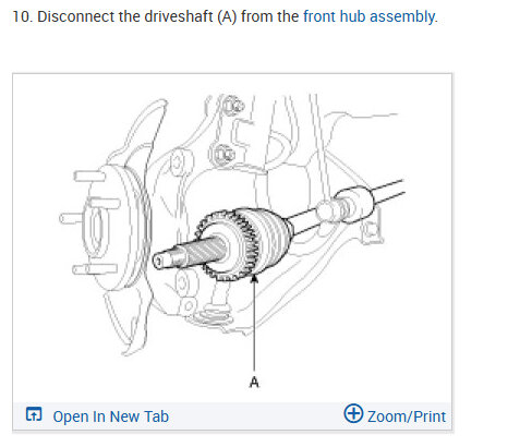

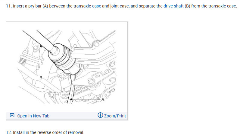

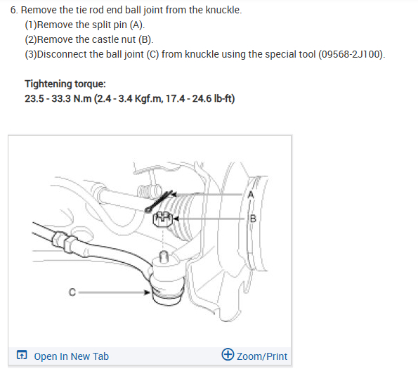

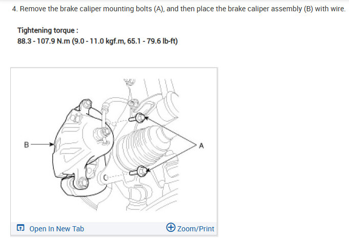

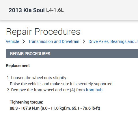

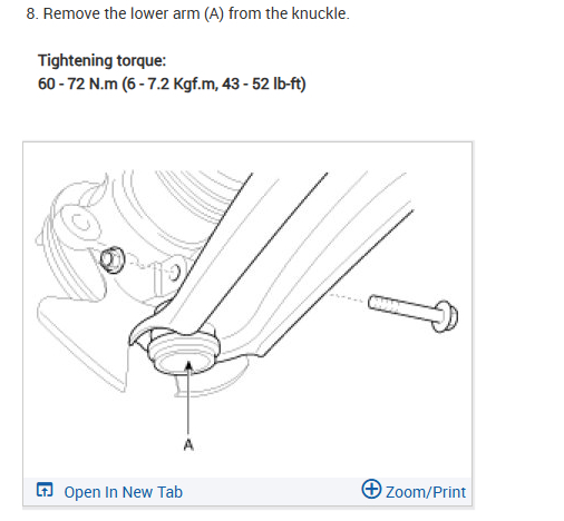

Yes, you need to remove the wheel. Then you will see the hub nut. That needs to be removed, along with a few other things, to remove the CV axle.
I attached the directions for removing the axle below. Please review them and let me know if they help or if you have questions.
