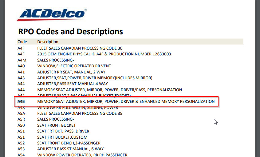

it seems that the memory seat module has stopped working. my seat, pedals and mirrors will not work. i have checked fuses and all wire connectors to make sure none of them came loose. i'm not to handy with a meter.

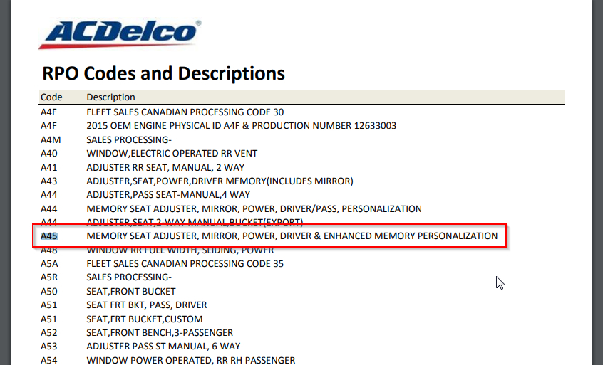

Does your vehicle have sales code A45? I attached what it is but basically memory seats, mirrors, and pedals.
If so, that could add in some items. You mentioned the memory seat module but we just need to confirm this. Also, can you confirm that is it is only the driver side that does not work? Does the passenger side mirror and seat work?
