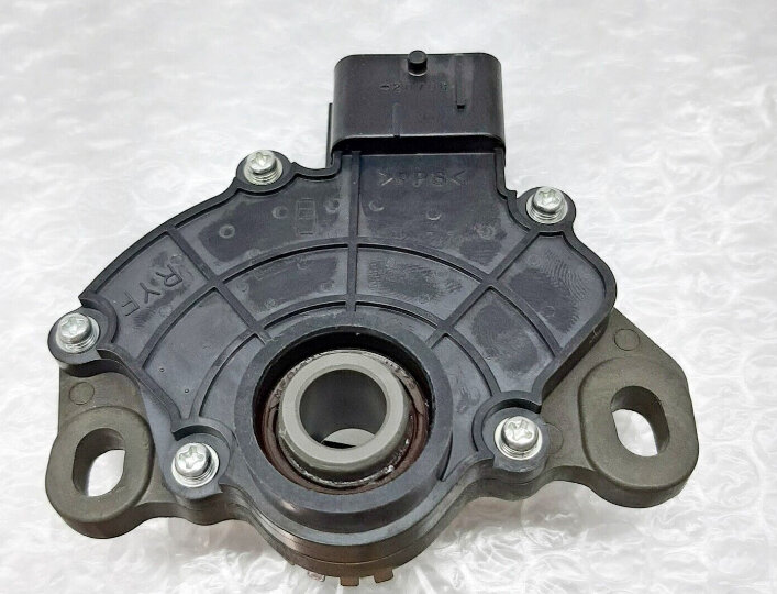

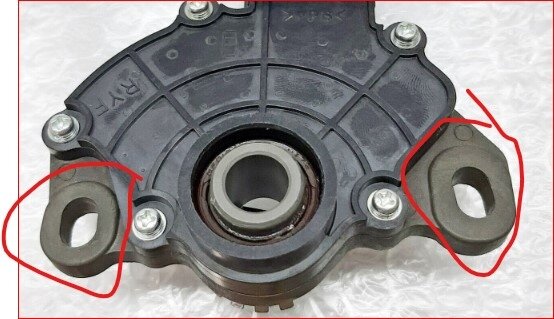

I just noticed that the shifting time is adjusted, it usually shifts from 1st to 2nd at 2,000 RPMs. Now it is at 2,200 RPMs. Will the position affect the shifting? I mean you can install the sensor, but it is not snug fit. It can be lean a little to the left or right as the hole for its 2 bolt are not circle, they are oblong.
Jan 31, 2024 at 1:43 PM
SIMARUN08
  • 30 POSTS
This bolt hole make the sensor move a little when installing.

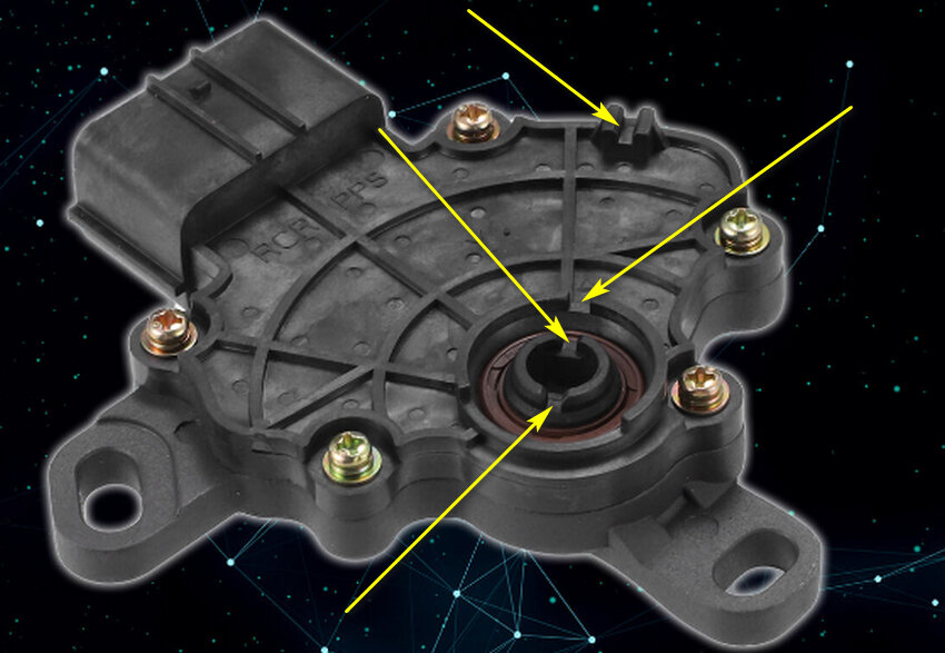

The transmission range sensor must be installed with the transmission set in Neutral.
On the range sensor there are alignment notches which must line up, see image below.
With the switch installed ensure that the 4 notches make a straight line with the transmission in neutral.

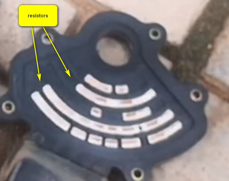

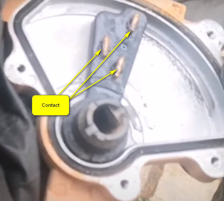

If the new sensor has been installed correctly, I can only assume that a difference in internal resistance could cause this shifting difference.
The range sensor uses a bunch of resistors which it uses to determine the transmission position.
See images below of internals for the range sensor.
Cheers, Boris
