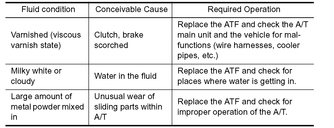

Fluid Condition Check
see pic 1
see pic 2
Inspect the fluid condition.

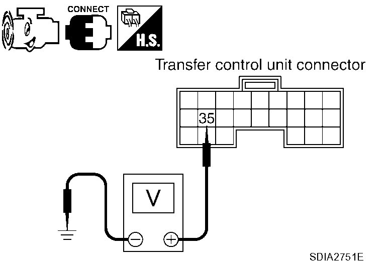

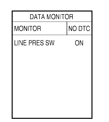

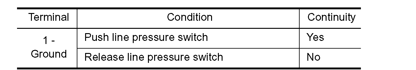

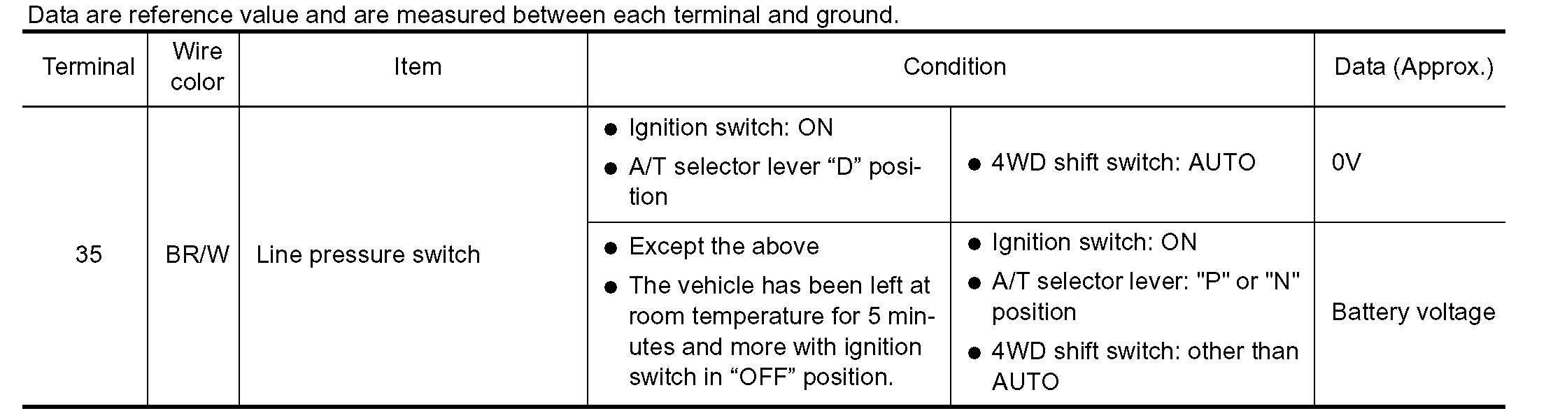

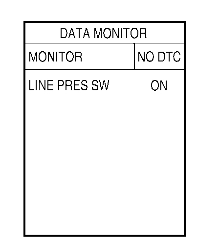

It sounds like it is related to a line pressure issue. There are a few electronics such as a line pressure switch. Based on what you are describing, it sounds like the pressure is low.
What needs to be done is a line pressure test. Here are the directions for doing it, but it is somewhat involved. Take a look through them and let me know if it is something you are comfortable doing. The attached pics correlate with the direction. It does require a scan tool and basic electrical testing equipment. Here is a link you may find helpful:

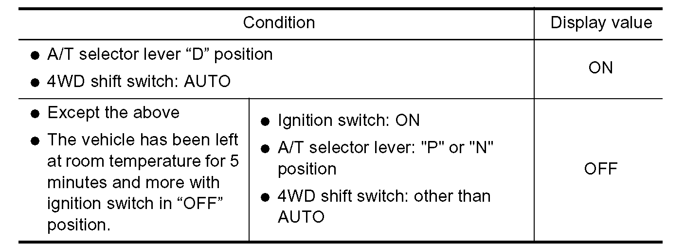

CONSULT-II REFERENCE VALUE IN DATA MONITOR MODE

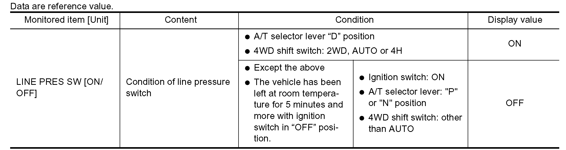

1. CHECK LINE PRESSURE SWITCH SIGNAL
With CONSULT-II
1. Start engine.
2. Select DATA MONITOR mode for ALL MODE AWD/4WD with CONSULT-II.
pic 3
3. Read out ON/OFF switching action of LINE PRES SW while operating 4WD shift switch.
pic 4
Without CONSULT-II
1. Start engine.
pic 5

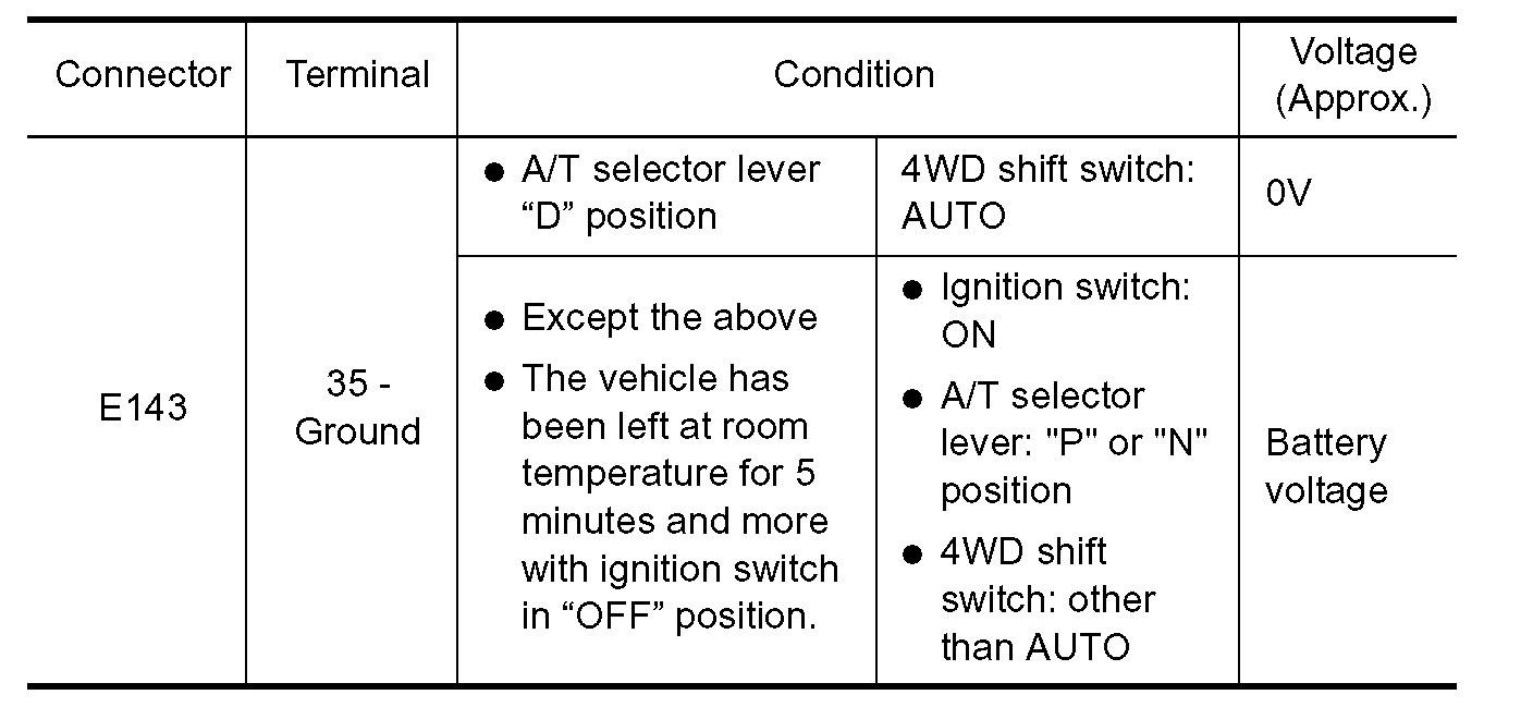

2. Check voltage between transfer control unit harness connector terminals and ground.
pic 6
OK or NG
OK >> GO TO 5.
NG >> GO TO 2.

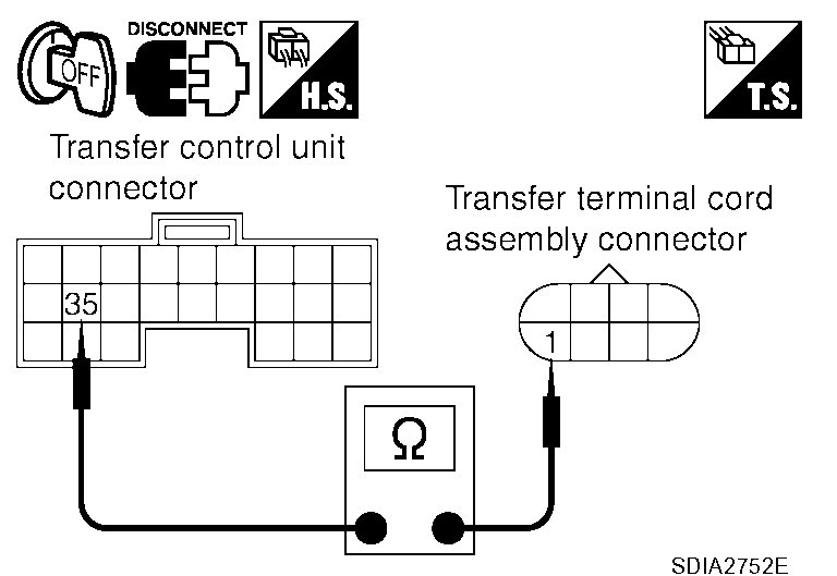

2. CHECK HARNESS BETWEEN TRANSFER CONTROL UNIT AND LINE PRESSURE SWITCH
1. Turn ignition switch OFF. (Stay for at least 5 seconds.)
2. Disconnect transfer control unit harness connector and the transfer terminal cord assembly harness connector.
pic 7
3. Check continuity between transfer control unit harness connector E143 terminal 35 and transfer terminal cord assembly harness connector F56 terminal 1.
Continuity should exist.
Also check harness for short to ground and short to power.
OK or NG
OK >> GO TO 3.
NG >> Repair or replace damaged parts.

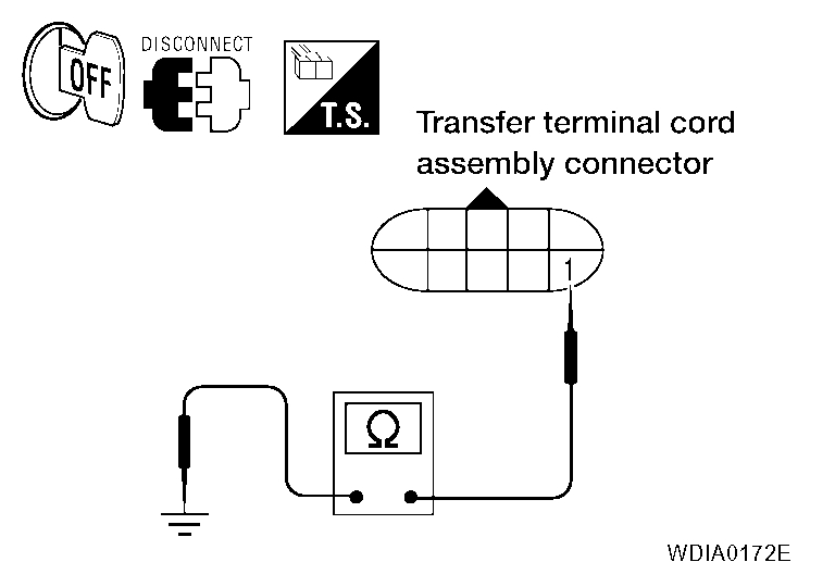

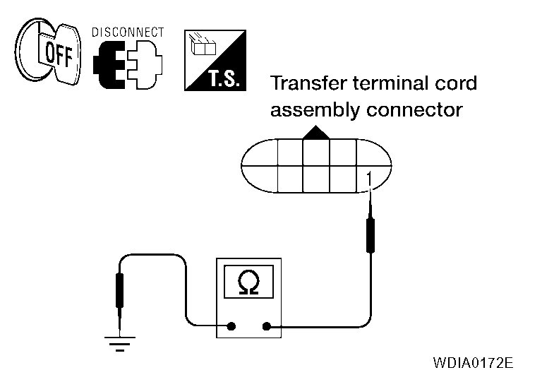

4. CHECK LINE PRESSURE SWITCH
2. Remove line pressure switch.
pic 8

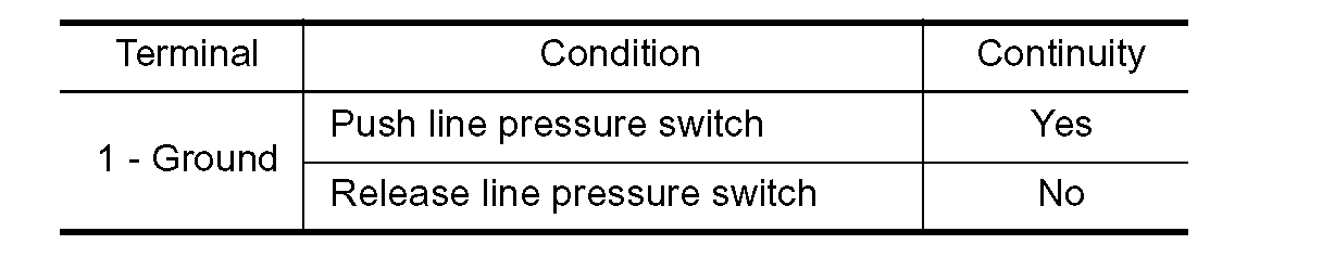

3. Push and release line pressure switch and check continuity between terminal 1 and ground.
pic 9
OK or NG
OK >> GO TO 5.
NG >> Replace line pressure switch.
pic 11
