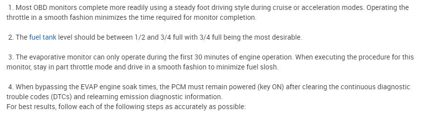

I have read about needing 1/2 to 3/4 full gas tank.

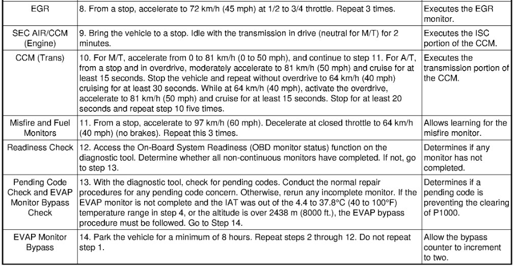

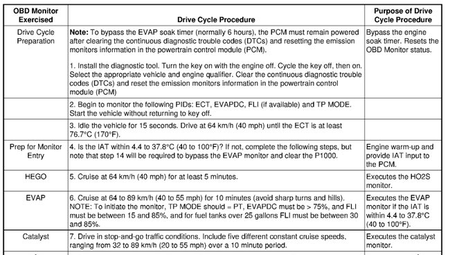

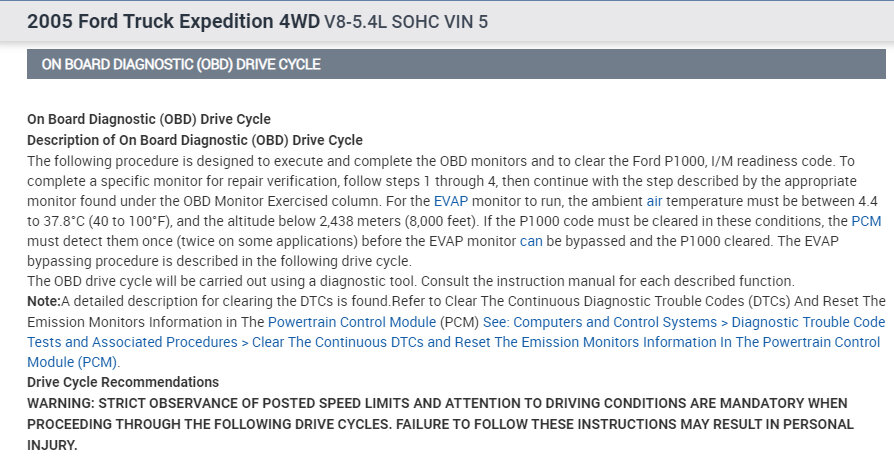

The drive cycle will vary, but half to three-quarters of a tank of fuel is listed. I attached the drive cycle information from my manual below. Take a look through it and let me know if it helps answer your question.

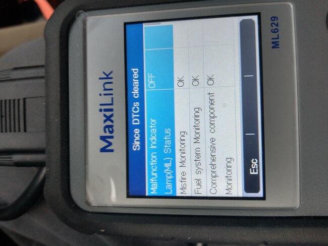

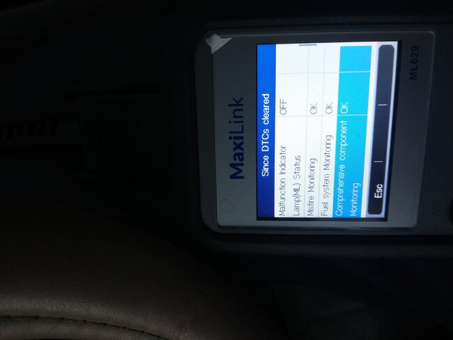

I completed all of the monitors tests
Except for the cat monitoring.
I am looking at the "Since DTCs Cleared"
And not the "This Driving Cycle"?
Look these pics and see what you think.
I see under step # 7 in drive cycle docs you provided, how to complete catalyst monitor.

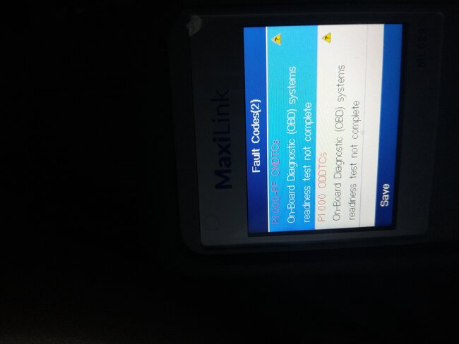

I still have the P1000-FF CMDTCs
showing readiness not completed. See pic.
Do I clear these after I complete cat monitor test?
Thank you,!

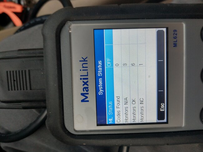

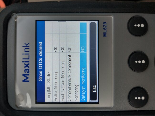

Pic with cat monitor showing INC
Mar 17, 2023 at 8:01 AM
OREO101
  • 103 POSTS
And I just drove the car and followed the drive cycle directions, and the cat monitor is still showing as INC. I guess I will just keep driving?
Mar 17, 2023 at 9:24 AM
  • 110,248 POSTS
The catalyst is always the last one. Keep driving. Hopefully, it won't take much longer.

I drove more miles and the cat monitor was finally completed.
I still have no CEL.
So, I parked my car and scheduled an inspection.
I do not want to drive until inspection, so I don't get another CEL! You have been awesome helping me out!
