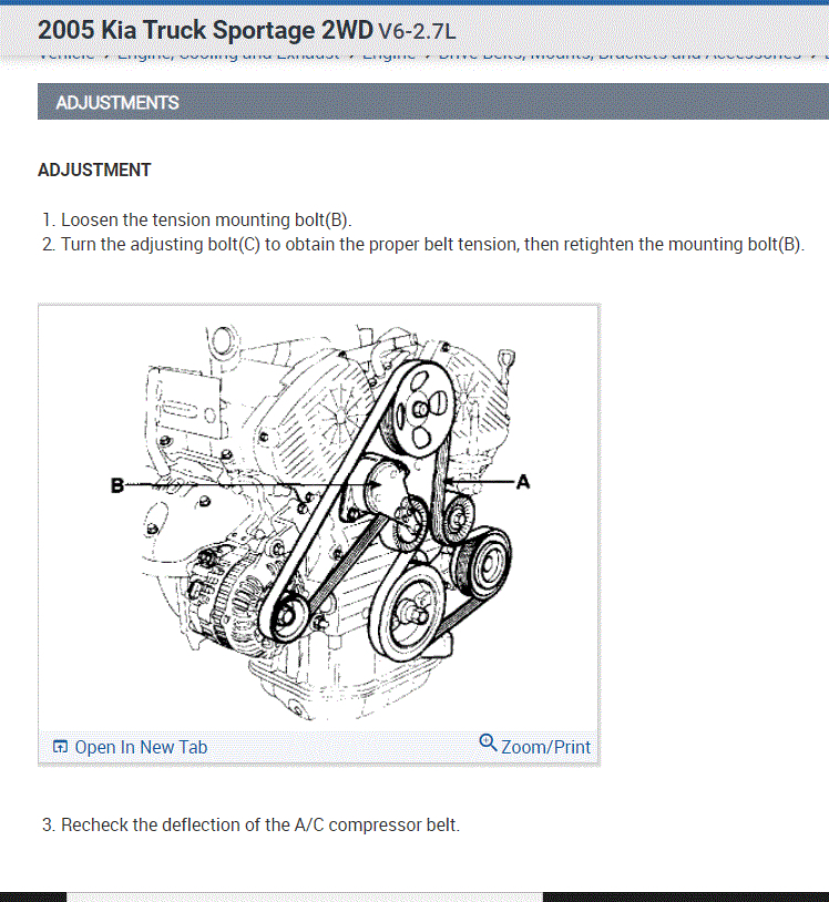

having problems putting drive belt on.

Are you sure the belt is the correct length? Also, make sure you have it routed properly.
If you look below, it provides the directions for adjustment. Take a look through it. It may help you get it installed. Also, here is a link explaining in general how one is replaced:
Let me know if this helps. If it doesn't let me know exactly what is happening to prevent you from getting it into place.
See pic below.

I have the belt on but it doesn't fit on all the pulleys and it's the same as the old one. it seems like tensioner is not moving far enough.

Do I have to loosen the alternator?

With a spring tensioner you don't need to move anything if it's the correct belt. Was anything other than the belt changed?
