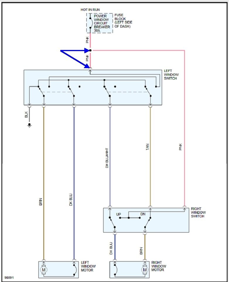

The power window wont go up or down with the switch. I have tested the switch and its working. I have tested the wires going to the switch and theres power. I have tested and I have power going to the plug the goes into the motor and I have power there as well. Since I'm working I took the power window unit out of the door and I tested it with a battery charger and the unit goes up and down BUT, when I use the actual plug and plug it into the window unit I get nothing. I need help please.

There's a couple of things you didn't mention. The first is checking for a good ground. The best way to do that is to press a switch for that window, then measure the voltages on the two wires at the motor. If you find 12 volts on both of them at the same time, the ground circuit is open. You'll also find 12 volts on both wires regardless if you press the "up" or "down" switch.
Next, are you using a digital voltmeter or an old-fashioned test light with an incandescent bulb inside? For this type of problem, the test light can be more accurate. If you're using a voltmeter, to be valid, the readings must be taken with everything plugged in. That means back-probing alongside the wires where they go into the plugs. A common cause of this is broken wires between the door hinges, and arced contacts on the switch. All it takes is a tiny spot of carbon where the wire arced apart for the voltmeter to falsely "see" 12 volts, but you won't get enough current to flow to run the window motor. With the motor or switch unplugged, no current tries to flow, so the voltmeter can give you a false reading. Test lights require current flow to operate. They will correctly show 0 volts when there's a break in the circuit.
Some vehicles have their power window switches in the center console. For those, each side is an independent circuit. If your switches are on the driver's door, both the 12-volt supply and the ground circuit for the passenger windows flow through the driver's master switch assembly. That means if the passenger window works, the wires between the hinges should be okay.
There's one exception that I pointed out in this diagram with the two blue arrows. If the pink wire is broken between those two points, the driver's window will be dead but the passenger window will still work. This is an aftermarket diagram. I'm trying to find the location of that splice on GM's original diagram, but it is very hard to follow.

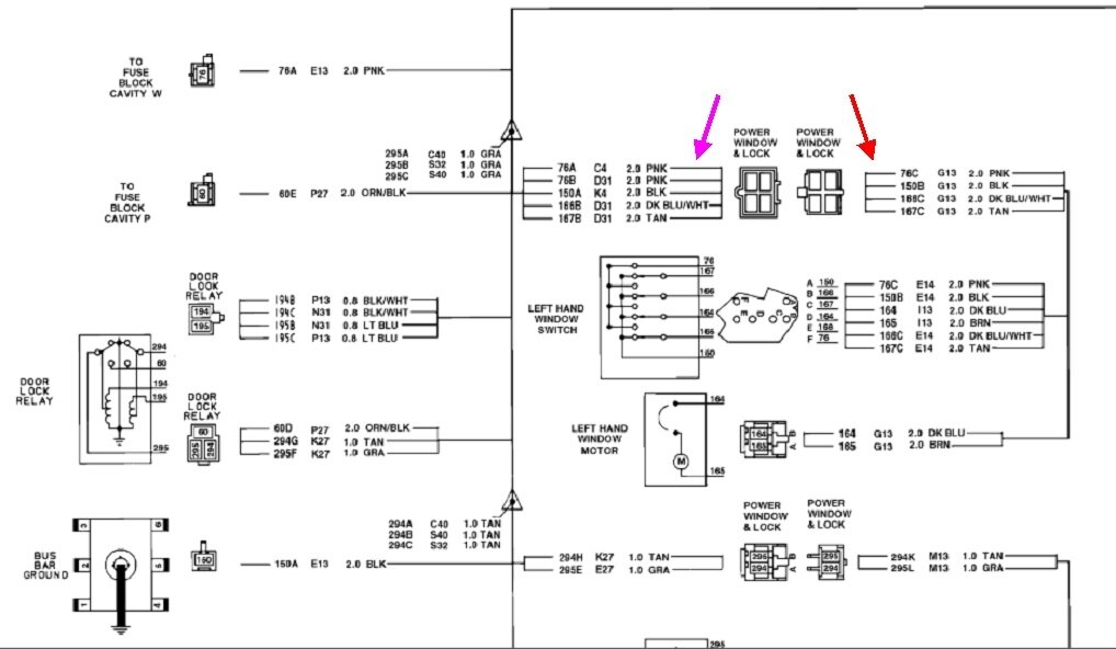

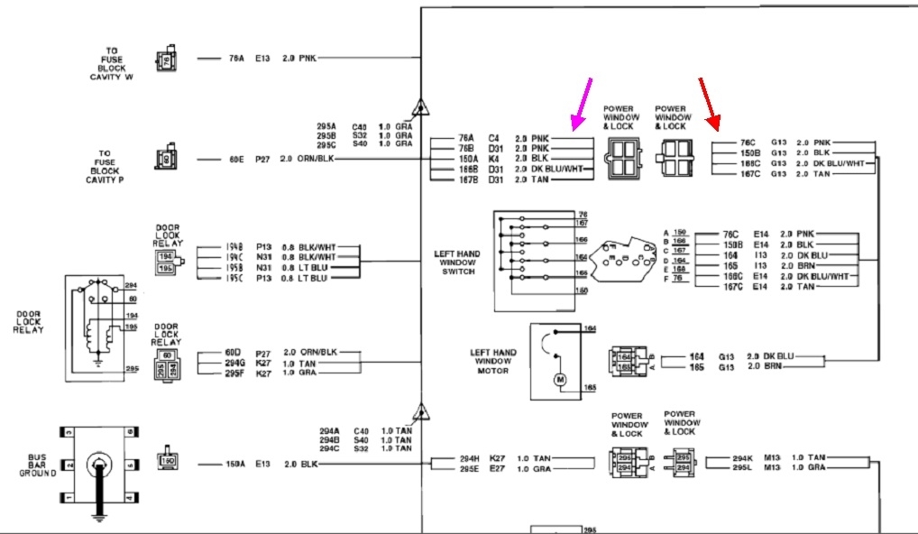

Here's a partial diagram from GM. What's noteworthy is the four-terminal plug at the top. The right side shows four wires, (red arrow), but there's five on the left side. That implies there's two pink wires in one cavity, meaning that's where they made the splice. That connector is a perfect place to find a bad connection. Don't unplug it yet. Do a visual inspection on the outside for signs of corrosion. If you don't see that, back-probe alongside the wires to measure the voltage on the side with two pink wires together. You should find 12 volts. If you do, measure on the pink wire on the other side of that connector. If you find 0 volts there, the terminals aren't making a good connection inside that connector.
Neither diagram shows the location of that connector, only that it's between the switch assembly and the fuse box. My suspicion is it is under the dash, near the left "A" pillar, possibly behind the left kick panel by the driver's left knee. It is only used on the assembly line to install different parts at different times. If terminals are corroded or damaged in that connector, the wires can be cut off and spliced together. You'll need to strip the insulation back far enough to find shiny copper wire. If it's a dull or dark brown, solder won't adhere to that.
