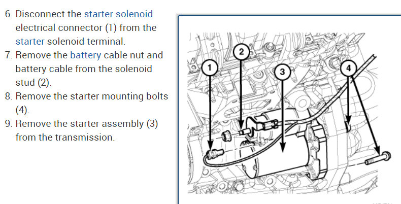

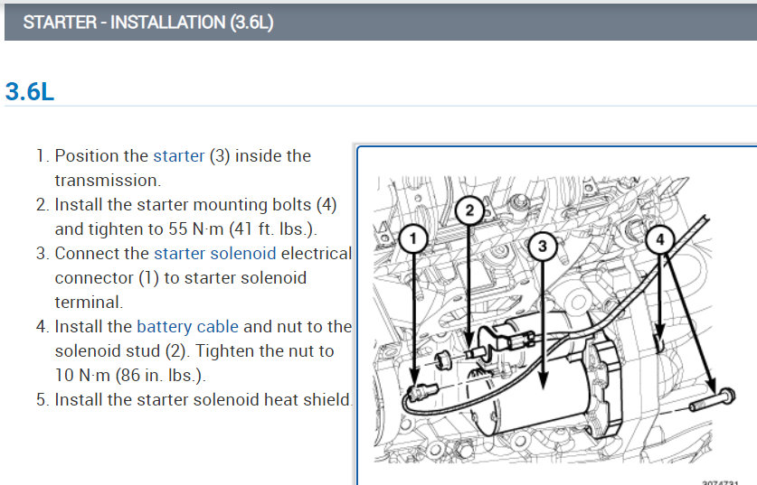

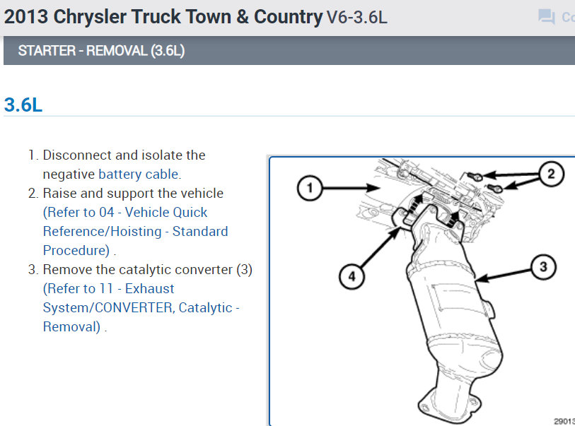

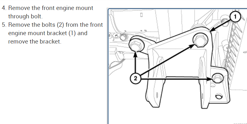

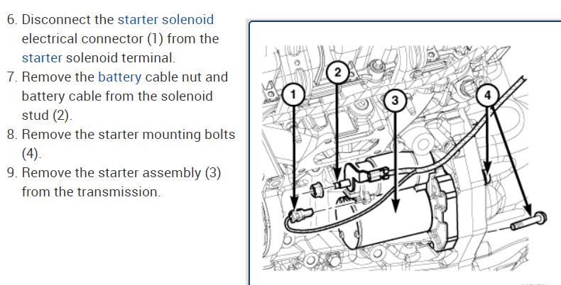

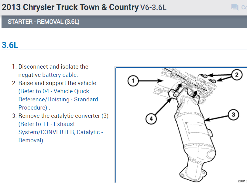

I have to tend to agree with you. This sounds like a starter issue. I think even though the motor is spinning something is faulty and the drive isn't engaging to the flywheel and starting the engine. Once the starter is removed you can take it to any auto parts stores and they will test for free. Here are a few tutorials for you to view relating to starter function and replacement:
https://www.2carpros.com/articles/how-a-starter-and-solenoid-works

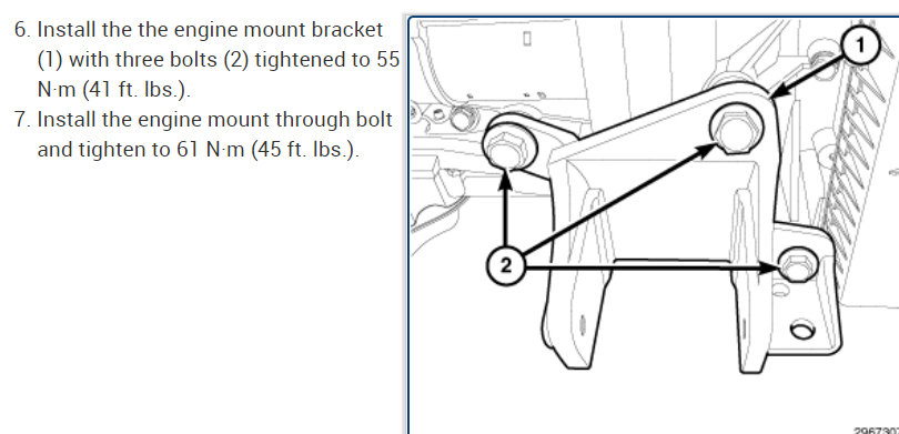

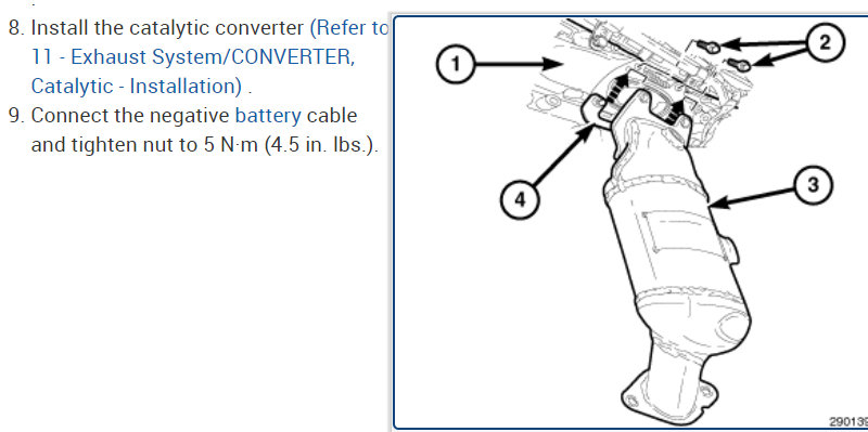

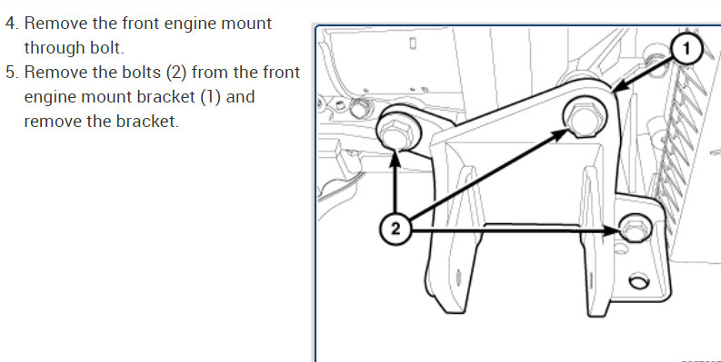

I've attached picture steps below for starter replacement below for your van. Hope this helps and thanks for using 2CarPros.
