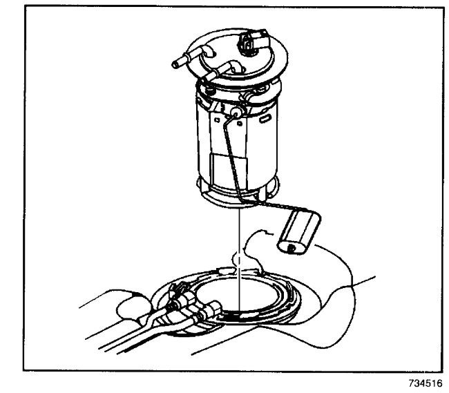

The most common cause is low fuel pressure. I would check the fuel pressure first.

Good information, but I would start with a fuel pressure test to verify sufficient fuel to the injectors.

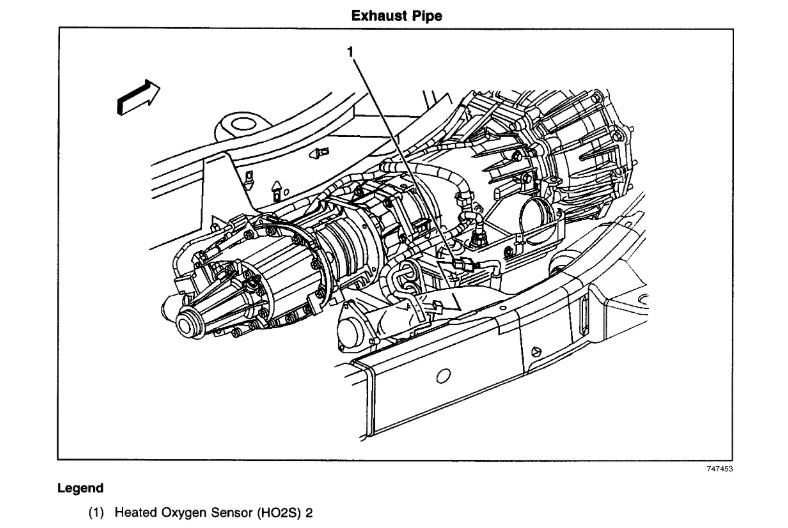

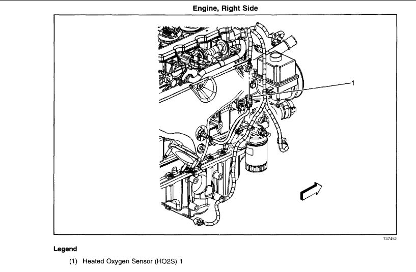

Where are the o2 sensors located on my vehicle? And is there a gauge I can borrow from the parts store or can I monitor the o2 with my OBD II?
May 8, 2019 at 9:06 PM
You can rent a fuel pressure tester at a parts store.
Yes, you can monitor the sensors with a scan tool, not a code reader.
