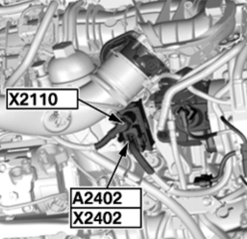

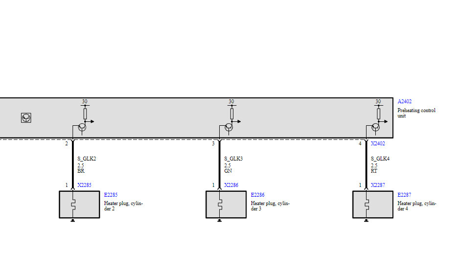

4A79 LIN/BDS: preheating control unit missing.
4A74 LIN/BDS: preheating control unit missing.
These codes can be set if the preheating controller is faulty.
This module is located at the bottom of the intake manifold, behind the oil filter housing.
A good video:
https://youtu.be/lApreDlURPk

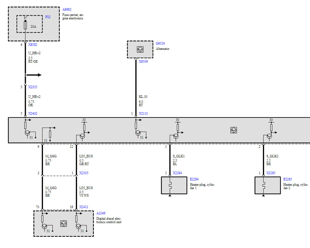

Suggest checking voltage supply to preheating module first.
12V is supplied to pin 5 at connector X2402 on orange wire.
This is supplied from fuse F02(20A) in engine bay fuse carrier, under driver's side windscreen scuttle.
Connector X2402 is the rectangular connector at the preheating module, see image 3.

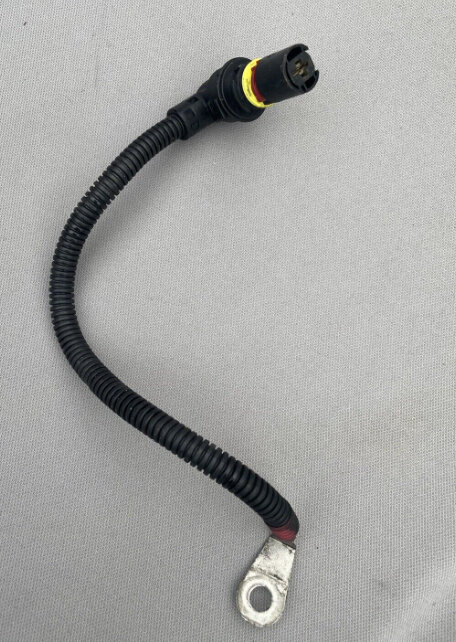

Constant 12V is supplied to pin 1 at connector X2110 on thick red wire.
Connector X2110 is the round connector at the preheating module.
This wire comes directly from the alternator, see image 4.
Perhaps an issue with the preheater module is causing the alternator fault?
This can be checked using a voltmeter.
