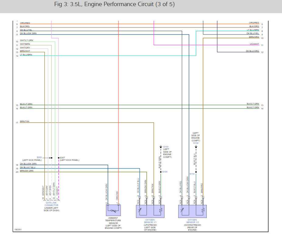

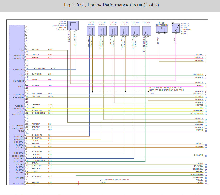

I am replacing the downstream O2 sensor. The wiring harness on the car is missing. I need a wiring diagram to know what wires to match the wires on the new sensor to.
Feb 5, 2023 at 10:46 AM
  • 55,583 POSTS
Sure, here are the engine wiring diagrams which include the oxygen sensor wiring. I have also included a guide to help you check the connection once the repair is complete.
Check out the images (below). Please let us know if you need anything else to get the problem fixed.
