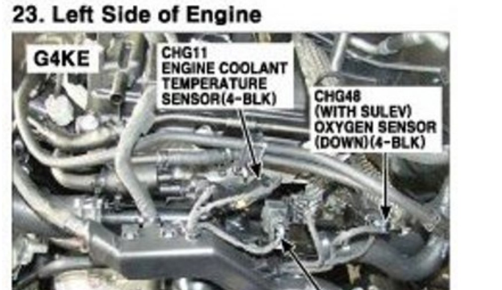

Is the downstream O2 sensor electrical connection located within the front console?
Dec 10, 2018 at 12:06 PM
Good afternoon,
The sensor connection is under the hood. I attached a picture for you to view of the location. Check out the diagrams (Below). Please let us know if you need anything else to get the problem fixed.
Dec 10, 2018 at 2:18 PM
BUSMECH45
The replacement will need to be clipped into the wiring harness. Following the wires from the downstream sensor, they disappear through a hole towards the passenger interior. How do you access the wiring harness?
Apr 25, 2021 at 12:21 PM
You will need to lift the rug inside the car where the wire came through. The connector is under the seat.
