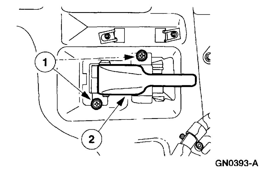

From the outside all doors on the car open. But from the inside the two back doors will not open and the child lock is not the problem. Any information will be helpful.

The inside door trim has to be removed. once it is removed, it just unbolts. the door releases are common for breaking as they are made of cast aluminum. you can get these at a parts store. ask the counter for them in Dorman. they make these replacements and they are reasonable in price.
