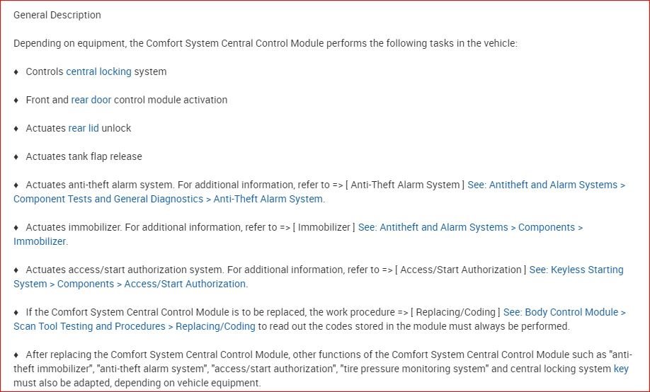

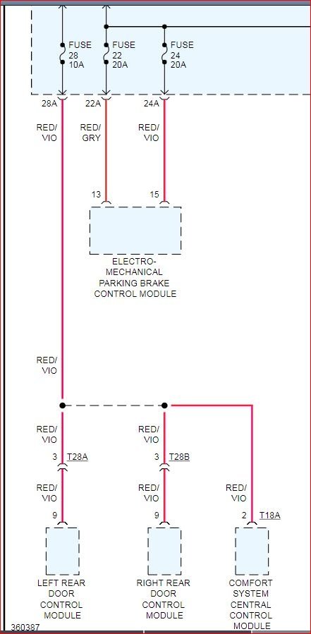

I looked through the wiring diagrams on this and it appears there are not fuses or relays solely for the door locks. The fuses are for the door modules that ultimately control the door lock actuator. There are multiple fuses that cover each door module so it is unlikely that each fuse blew. Plus even if they did, it would not effect just the door locks as the entire door module would be off line.
Also, it looks like the Comfort System Central Control Module is responsible for telling each door to open or close the locks. So the fact that all locks are effected, this would make sense that this module is the issue. Lastly, the CSCCM has a circuit board that would allow for only the lock system to fail and not affect the other things that it controls.
Take a look at these attachments and see what you think but it appears they may be correct.

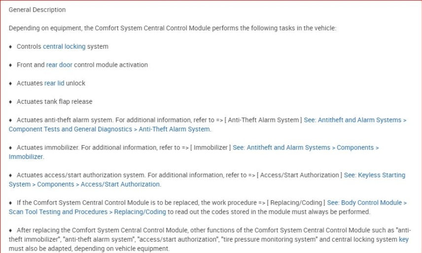

In your case, this would be the comfort system central control module. This is what controls the locking system through each door module. I attached the info for this module.

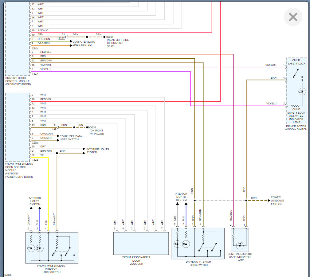

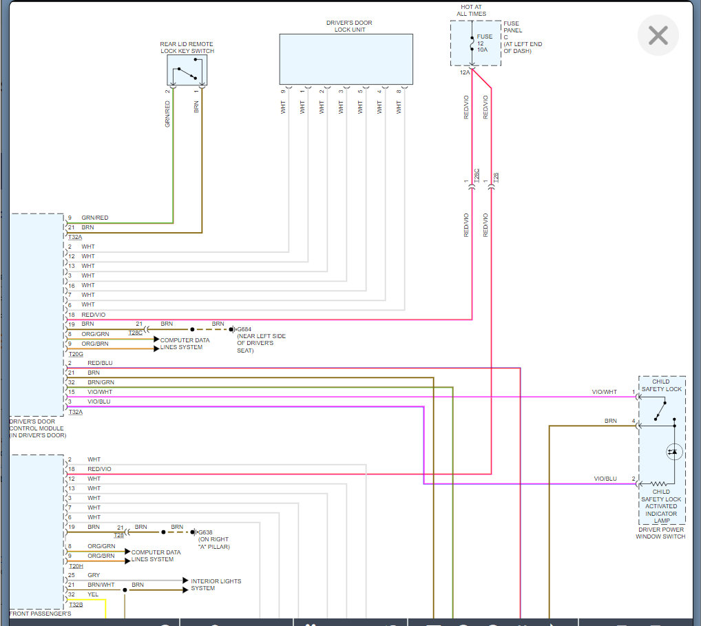

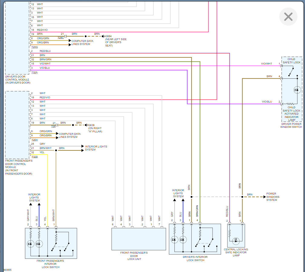

What I would do is start with the driver door and check voltage at the lock unit and work back until you find where you have the proper voltage.
I attached the wiring diagrams below.
