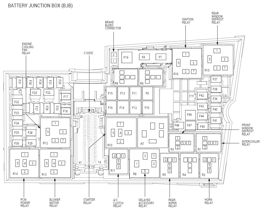

Hi, I recently replaced my drivers' doors and driver’s passenger side door. Now my windows will not go up and down and the locks do not work. Also, it says the driver's side passenger door is open when it's closed now.

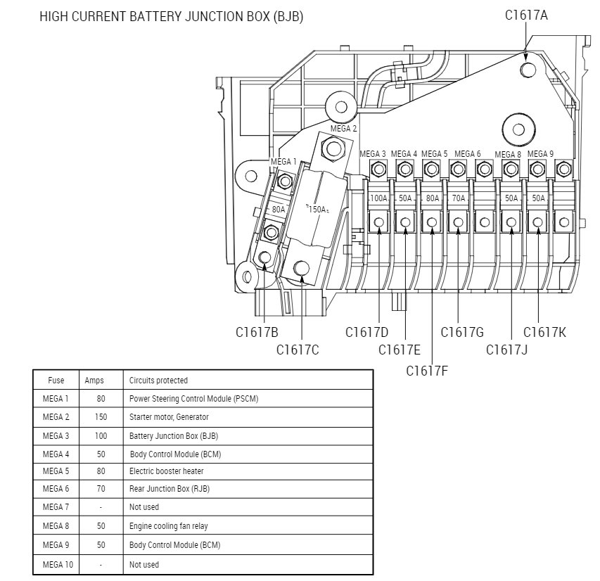

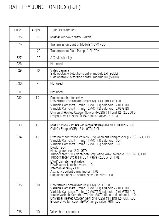

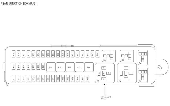

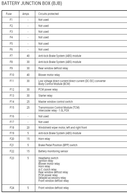

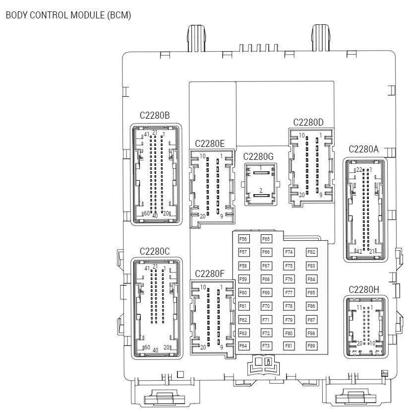

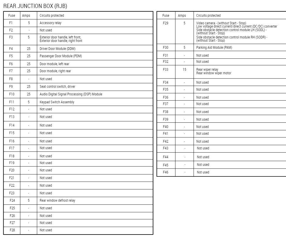

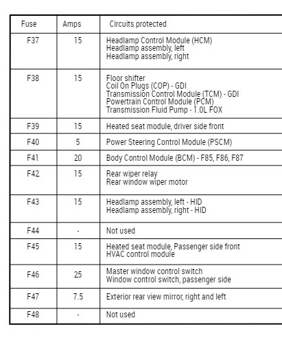

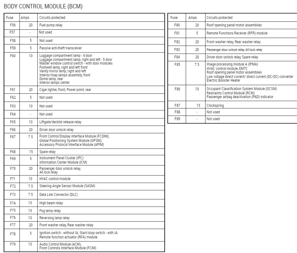

I would remove the door panel and recheck the electrical connectors, also the main wiring harness connector inside the car at the kick panel needs to be checked as well. If they seem okay, I would start by checking the fuses with the systems on. Here is a guide to help and a guide to help you check the fuses:
Check out the images below. Please let us know what happens.
