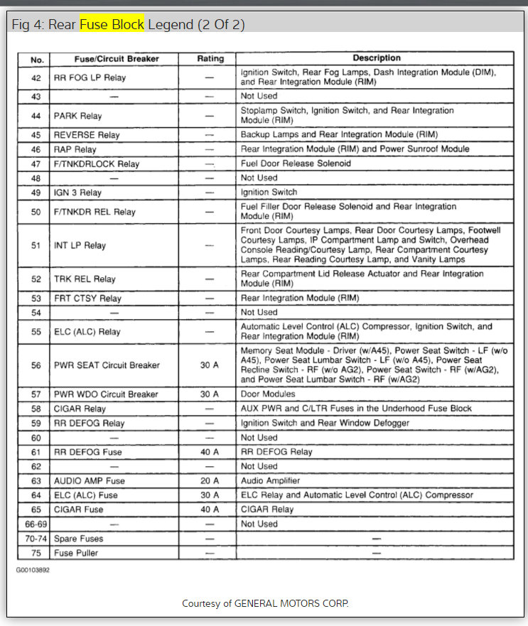

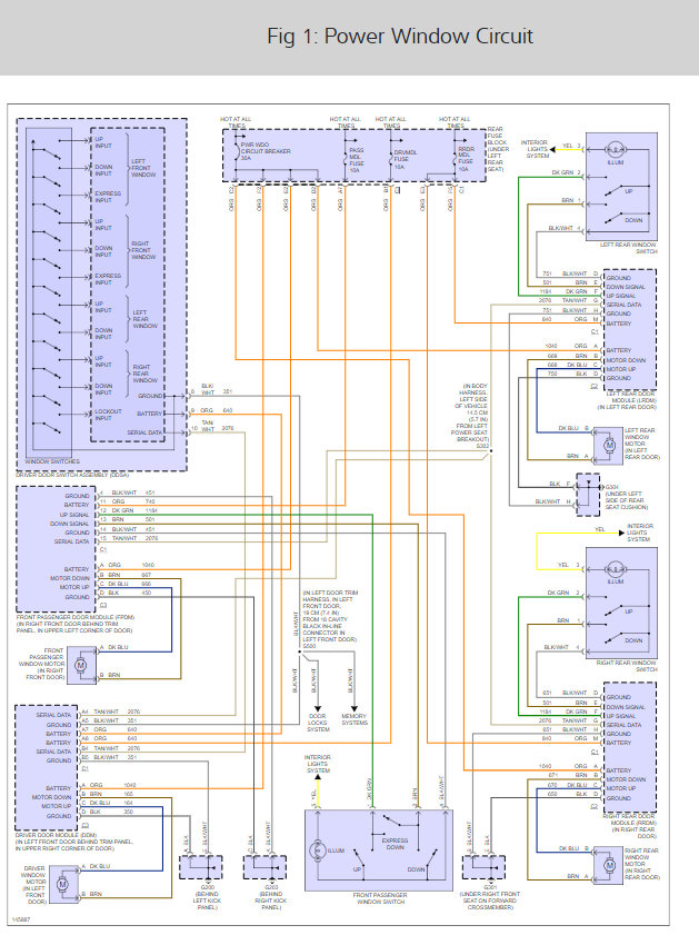

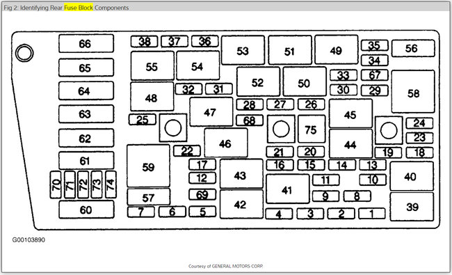

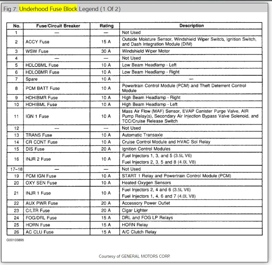

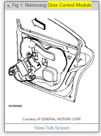

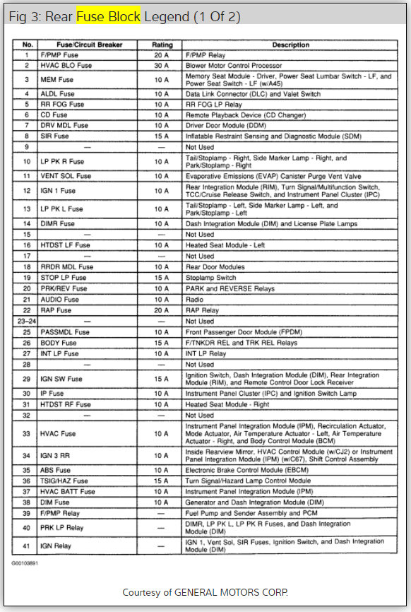

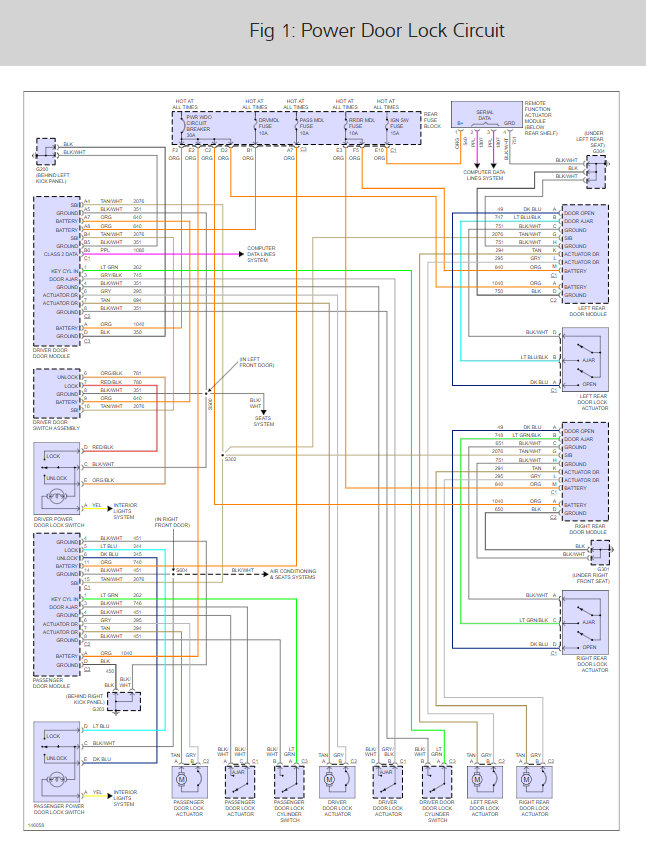

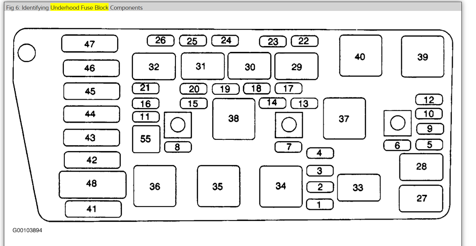

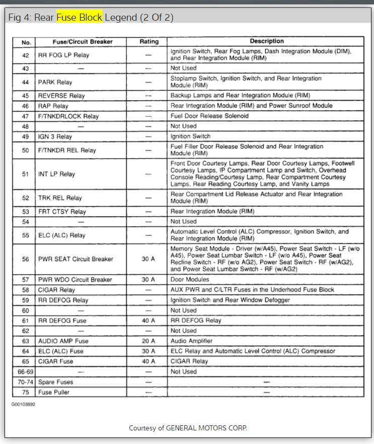

Hi, I have a problem with the doors in my car. the right two doors not answer any commands. window not roll down, not lock doors and the mirror no working.
Mar 26, 2018 at 4:37 AM
  • 55,399 POSTS

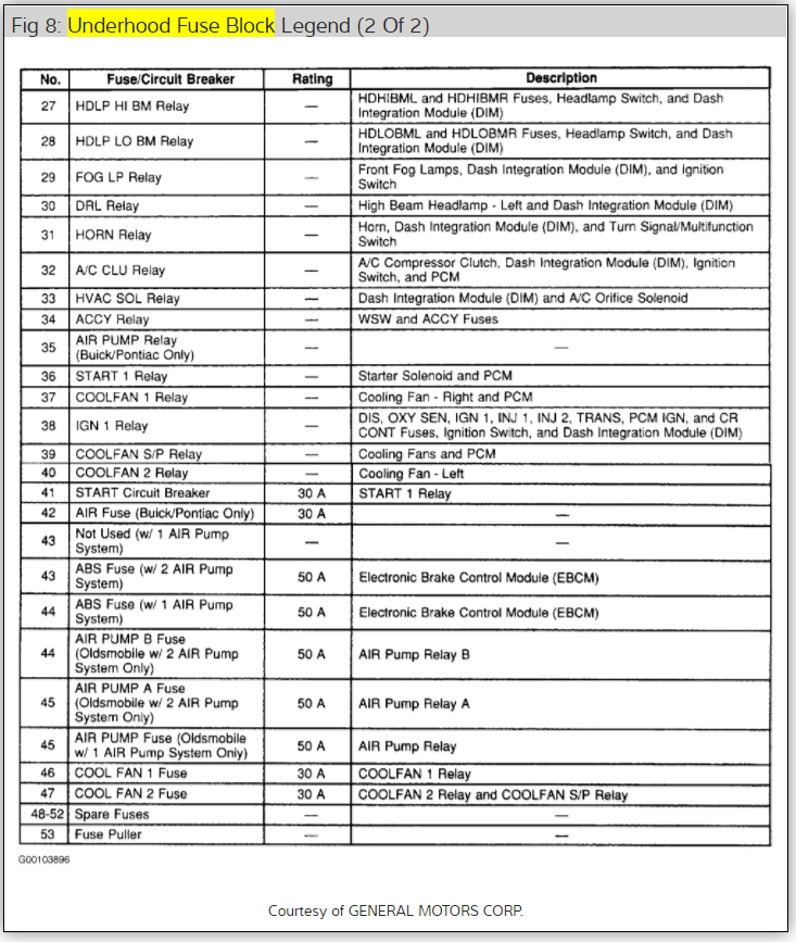

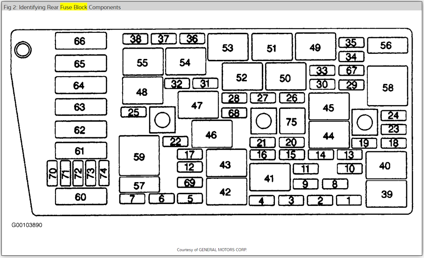

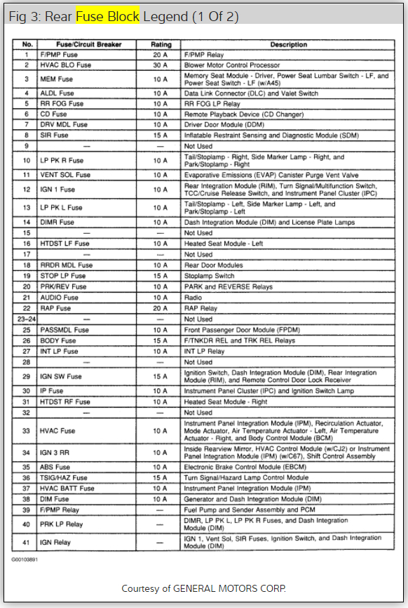

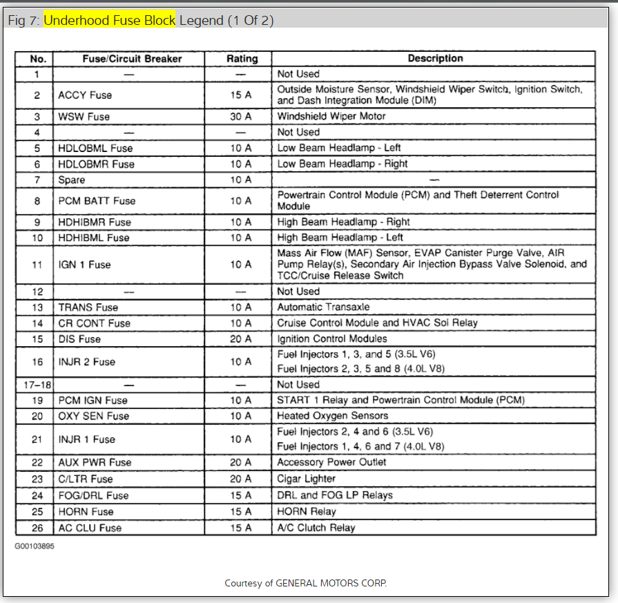

This sounds like a problem with the passengers side door module but to be sure lets take a second and check the system fuses. here is a guide to help show you how to check the fuses. See where the system is losing power my bet is the door module
Here are the window and door lock wiring diagrams so you can see how the system works.

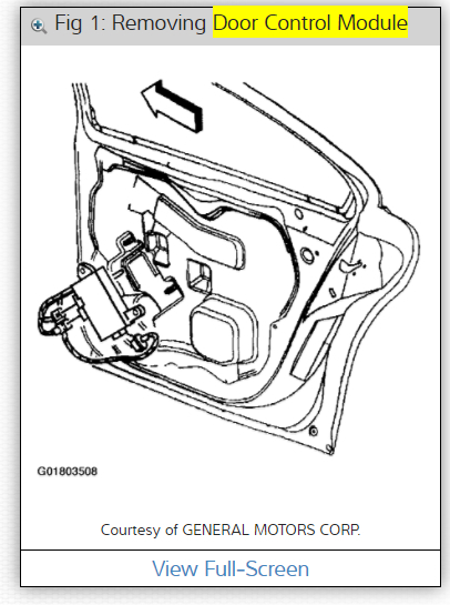

Thanks for the help, but that did not work. I checked all the fuses and everything is okay and I was replaced door module a couple days ago and nothing. my mind is burning I do not know what can I do next to fix this. any another ideas? thanks
Mar 27, 2018 at 1:06 PM
  • 55,399 POSTS
I would use this guide to see what you are losing power.
Use the wiring diagrams above it could be the drivers side module.
