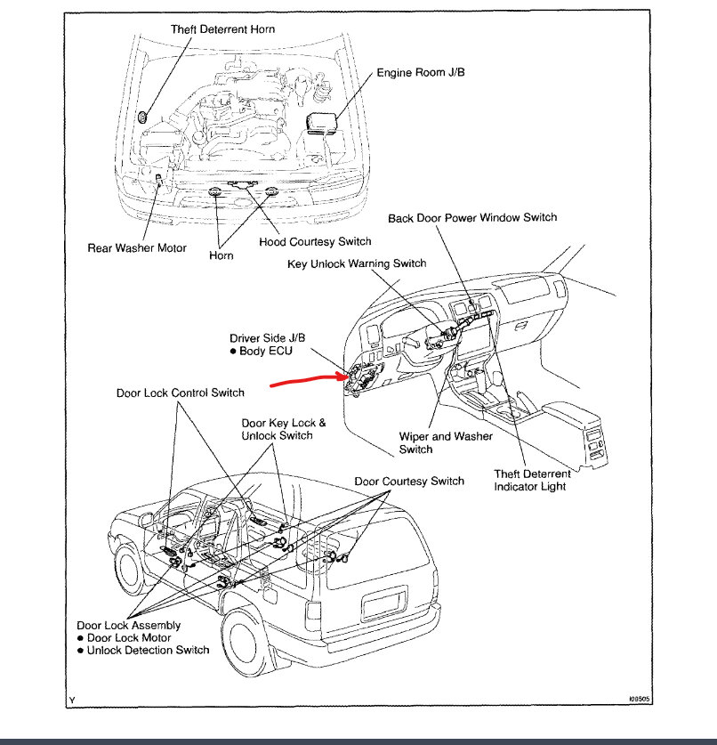

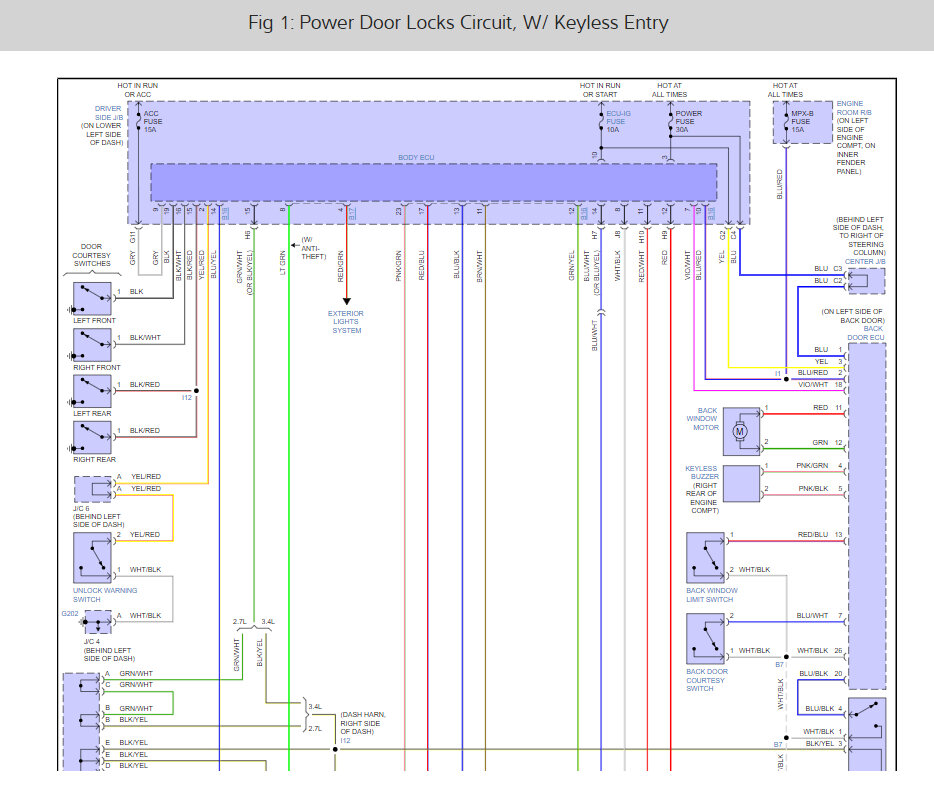

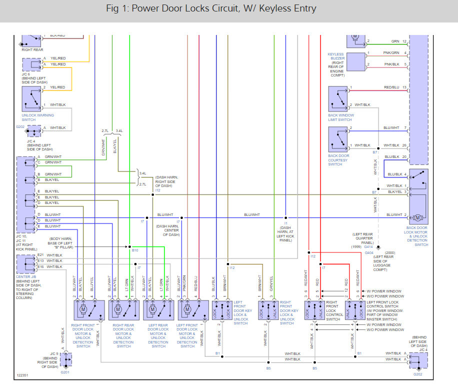

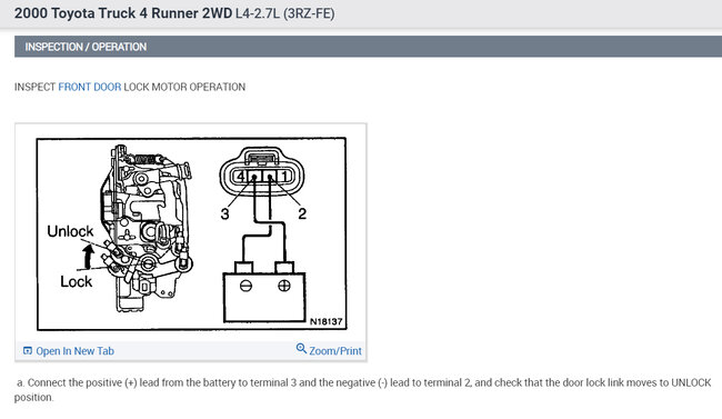

Does the truck have an aftermarket alarm system? If so, it will need to be removed. If not with all doors closed pull on each door and move it around a little to see if you get the system to react this is telling you the door close switch inside the door is going bad, also there is a BCM involved which can cause the issue as well. Here are the door lock wiring diagrams so you can see how the system works. Here is the BCM location as well in case you need to replace it. To confirm the BCM failure you should do a CAN scan. You can get a CAN scanner (Controller Area Network) from Amazon from about $32.00.

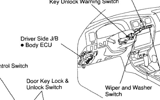

Okay, that is a good clue that you reset the system and fixed it for now. This will be a module or controller problem (BODY ECU). You will need to get a rebuilt unit which will come preprogrammed for your car, search Goggle or eBay for a service that does this. Check out the images (below). Please let us know what happens.
