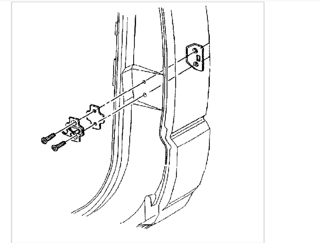

I've had to duct tape my driver side door to keep it shut, even so it still leaks when it rains. I have to climb in from the passenger side and over the center console to get to my seat. When it wasn't duct taped it would be really hard to shut, and when you would turn a fair degree, it would occasionally fly open. Why is it doing this? What do I need to fix?

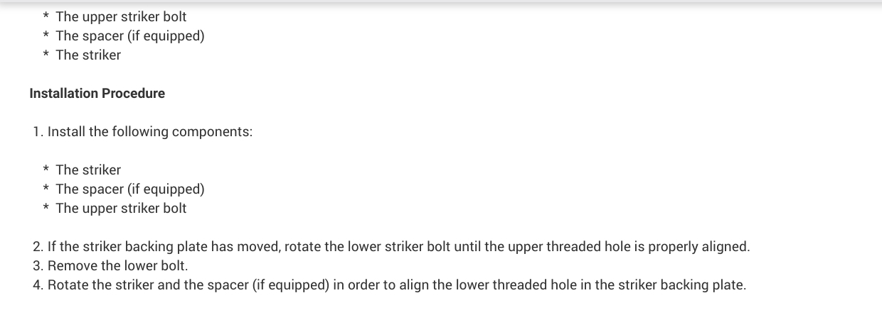

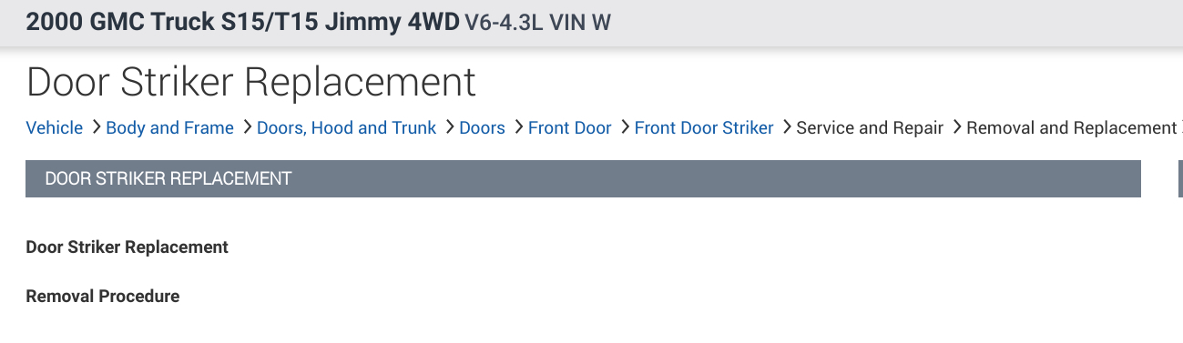

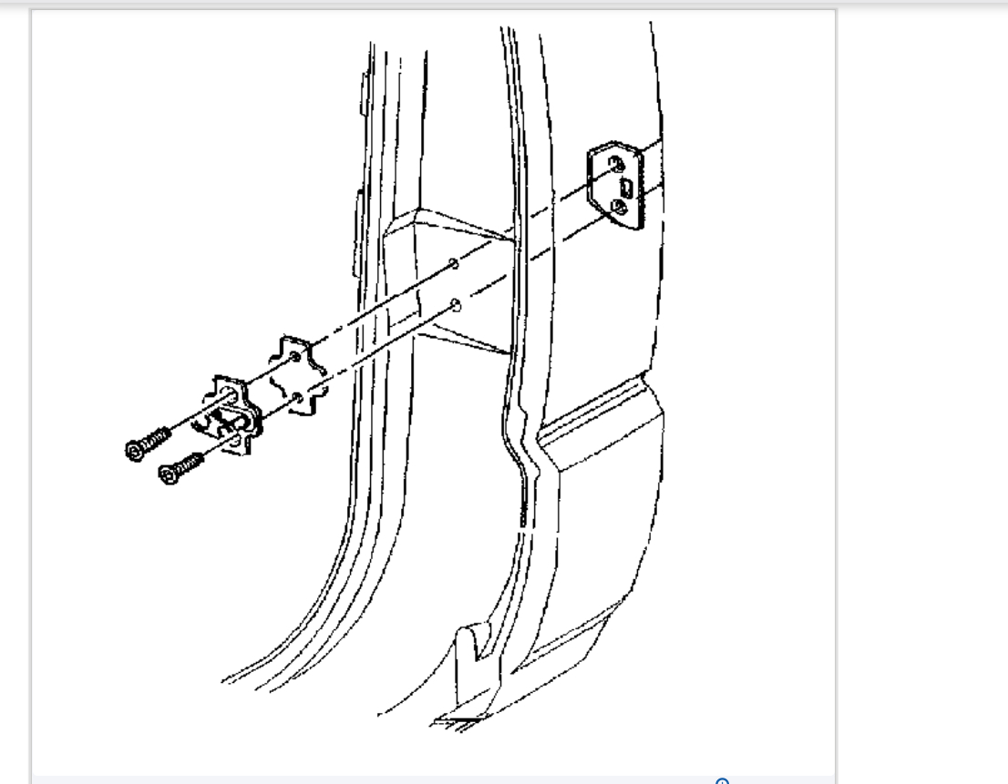

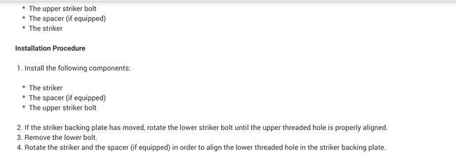

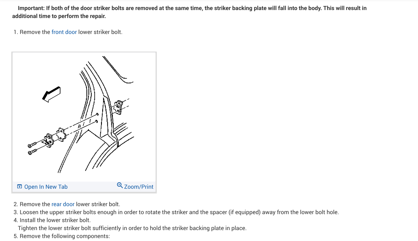

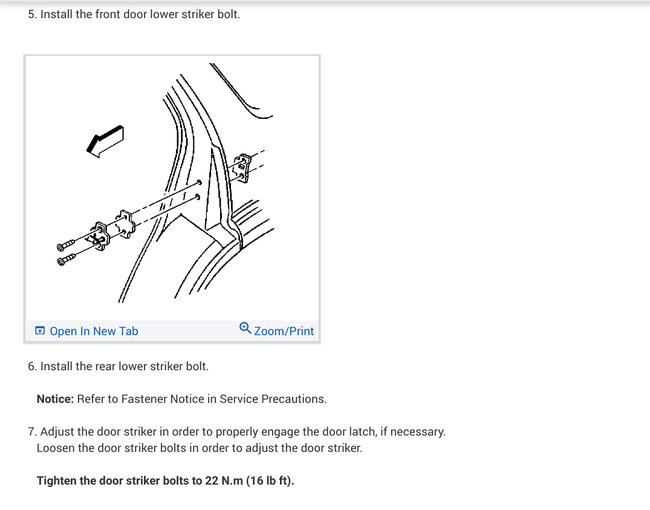

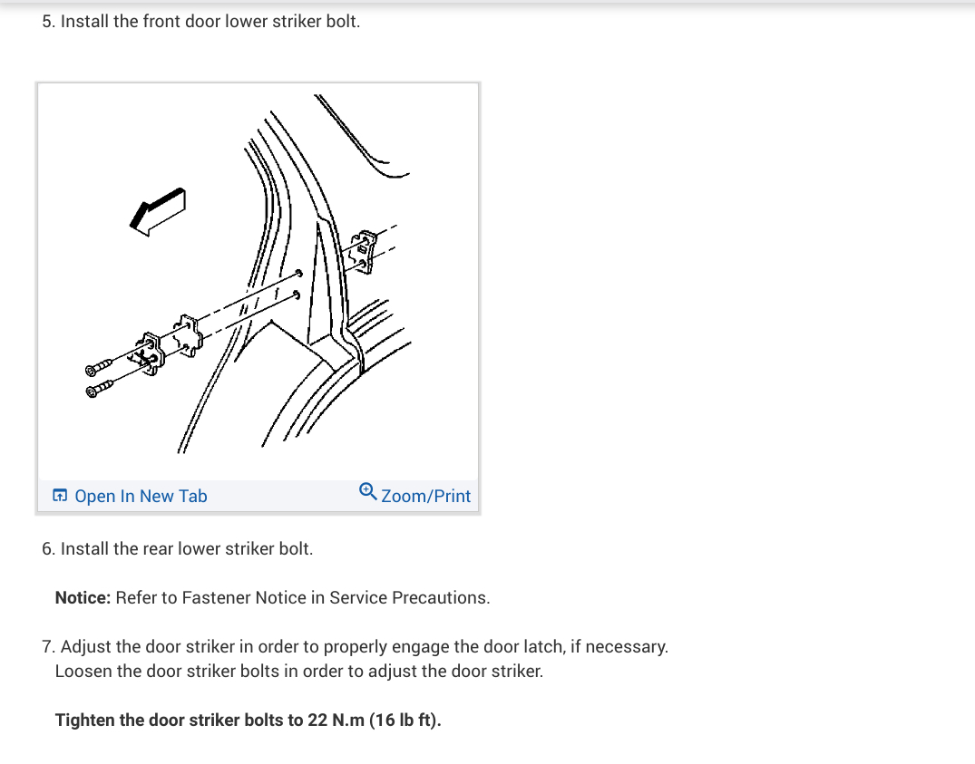

This could be a problem with the door striker. In the diagrams down below I have included the instructions for the removal and installation of the door striker for your vehicle. Please go through this guide and get back to us with what you find out.
Thanks,
Alex
