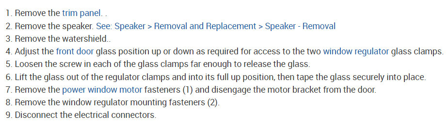

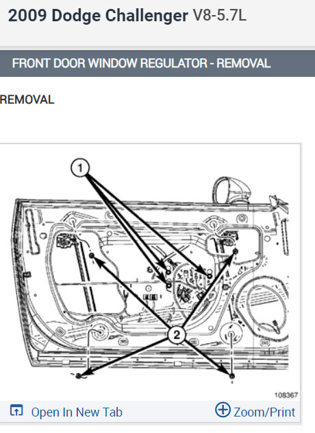

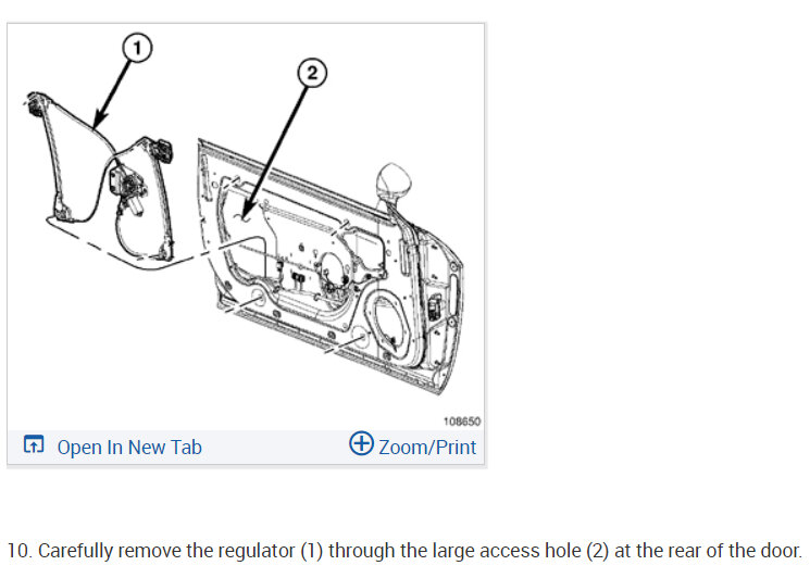

I did what you said now when you close the door the window goes up for a few seconds then down about a 1/2 inch back up then down back up then down. I assume you got the picture. You can bring it down about halfway and it stays. Now what do I do? Thanks for your help!
Aug 20, 2024 at 3:55 AM
  • 55,694 POSTS
To me it sounds like you have a window regulator that is bad, can you hear the window motor working when the window goes down? if not then I would replace the regulator. Here is how. Check out the images (below). Please upload pictures or videos in your response of any problems so we can see what to help you with.
