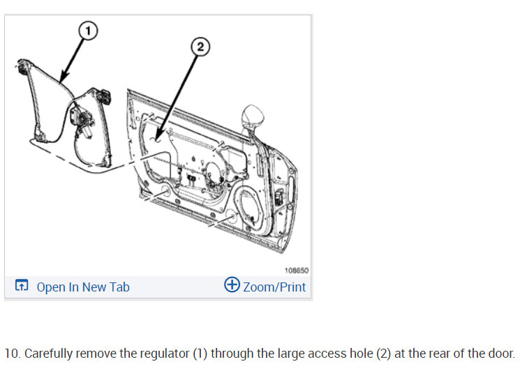

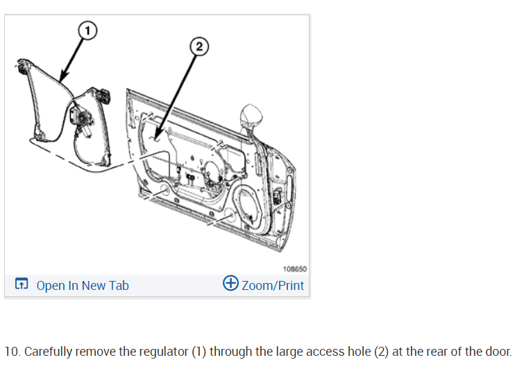

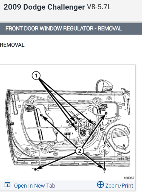

To me it sounds like you have a window regulator that is bad, can you hear the window motor working when the window goes down? if not then I would replace the regulator. Here is how. Check out the images (below). Please upload pictures or videos in your response of any problems so we can see what to help you with.
