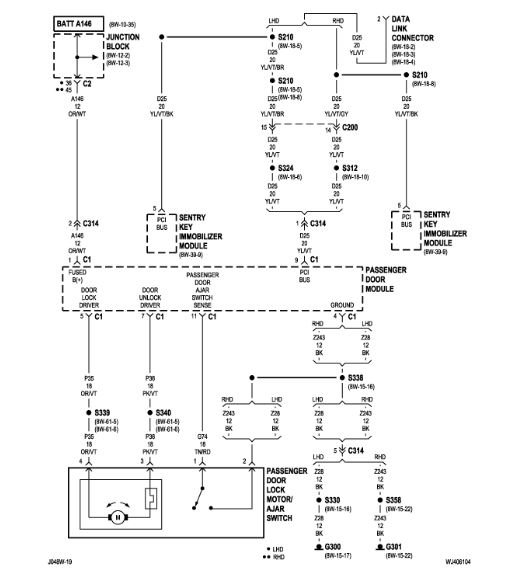

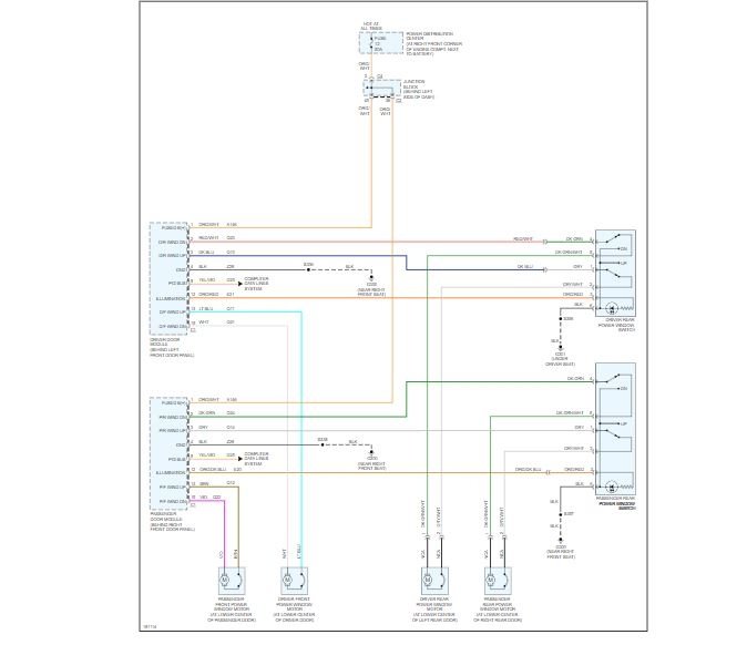

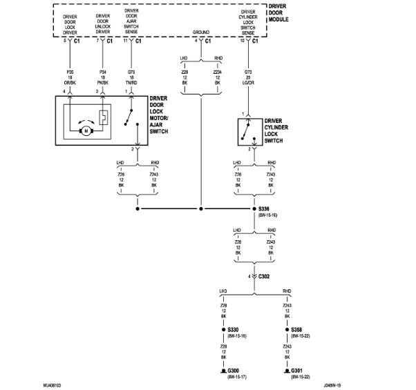

My body to door wiring harness has been fixed several times by the looks of it. Someone has spliced wires, all of the same color (ugh).
The original wires going through the body are too short now to work with for splicing repair.
Can I purchase a replacement wiring harness from the fuse panel to the door jam in order to get the correct color matching wires? The previous repairs have left too much bulk inside the protective rubber boot with all of the spliced wiring.
