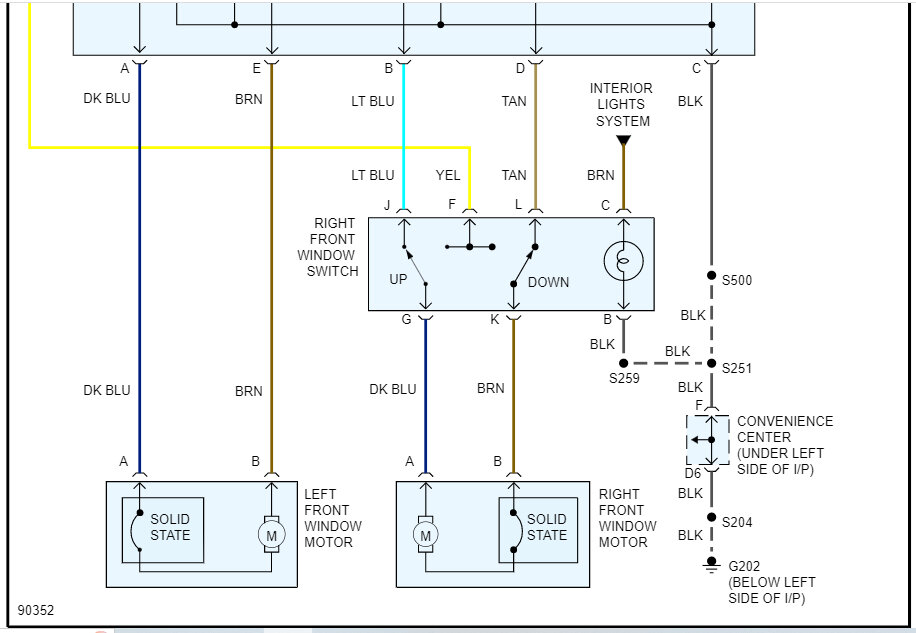

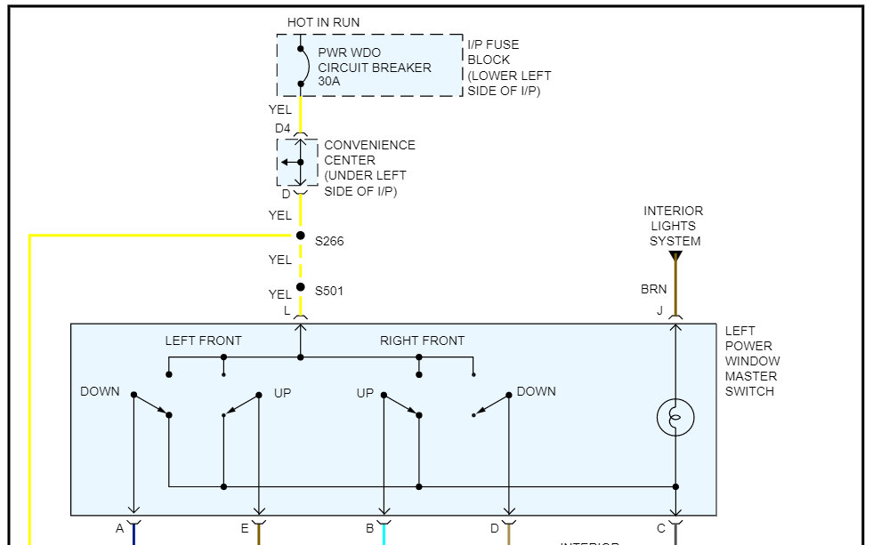

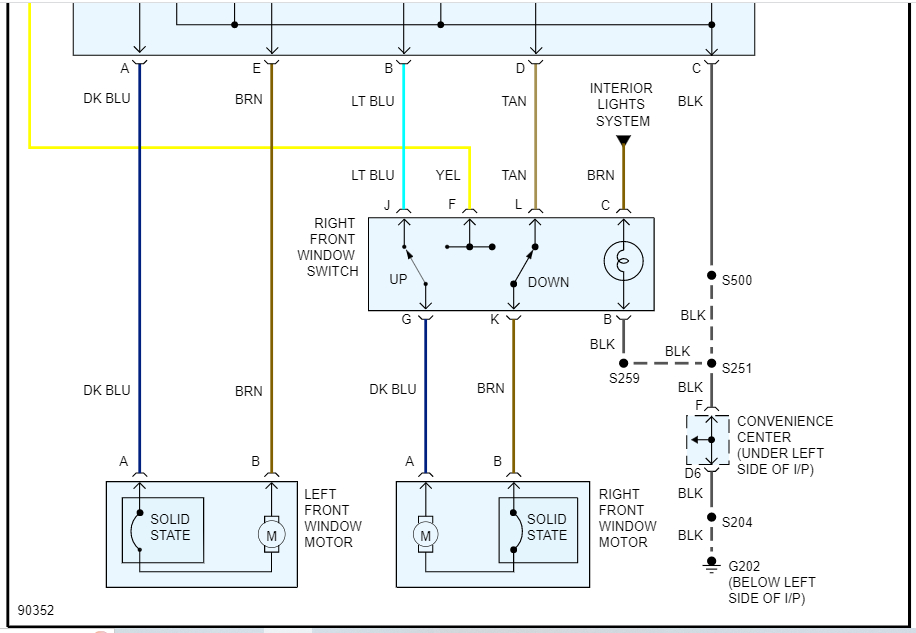

Swapped door from 1999 GMC Yuko, how do I wire in the door switches?
Feb 8, 2023 at 11:23 AM
  • 110,194 POSTS
Do you mean the door didn't come with a power window and you need directions, or it did, but the old one didn't have a power window?
Also, I am basing this on a regular cab and not a 4 door. If that is incorrect, let me know.
Take a look through the wiring schematic below. Let me know if that is what is needed or if it is something different.
