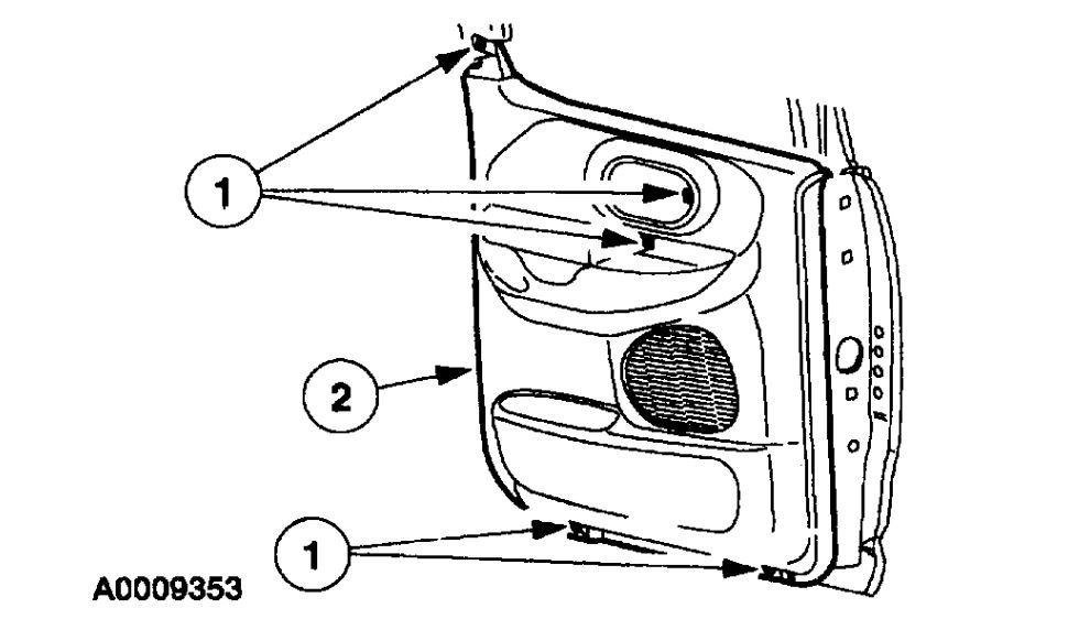

Cab back doors wont open.
Thursday, July 2nd, 2020 AT 6:47 AM
3 Replies
MECHANIC
52,796 POSTS
Good morning,
Please explain?
Do the handles work inside and out?
Do the power door locks release the button?
Please give me as much information as possible.
+1
Thursday, July 2nd, 2020 AT 7:37 AM
ROGERMM65
MEMBER
50 POSTS
Nothing works to open extended cab back doors, started with passenger back door now drivers back door is stuck shut?
Friday, July 3rd, 2020 AT 10:29 PM
MECHANIC
52,796 POSTS

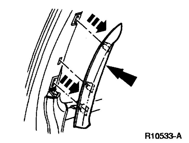

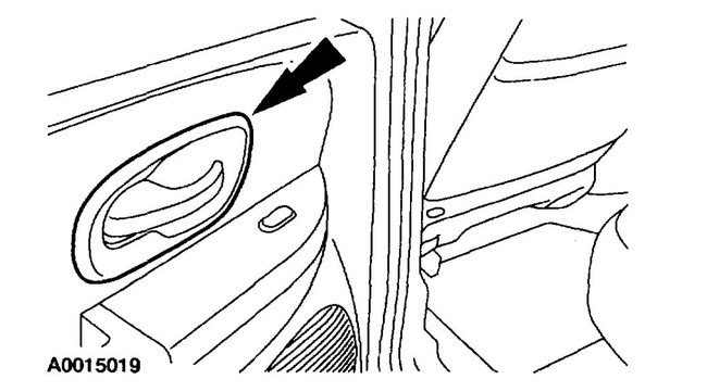

Okay, the only thing you can do at this point is to remove the inner door panels and manually release the latch to open the door.
Then the failures need to be determined to find out why the latch will not release.
