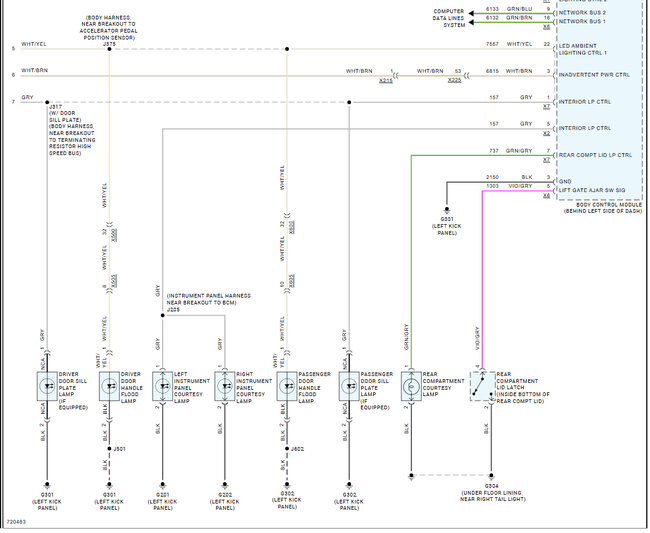

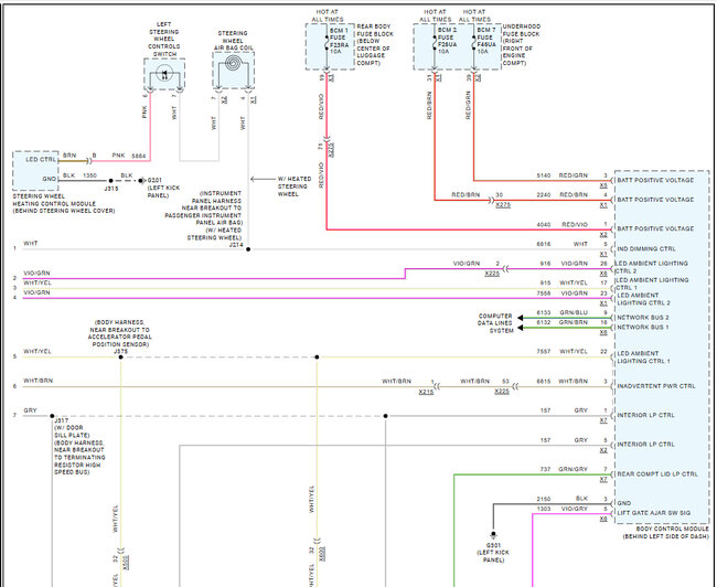

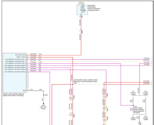

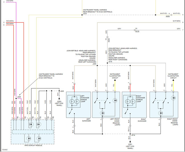

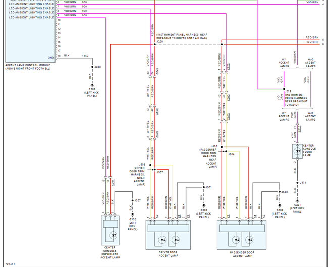

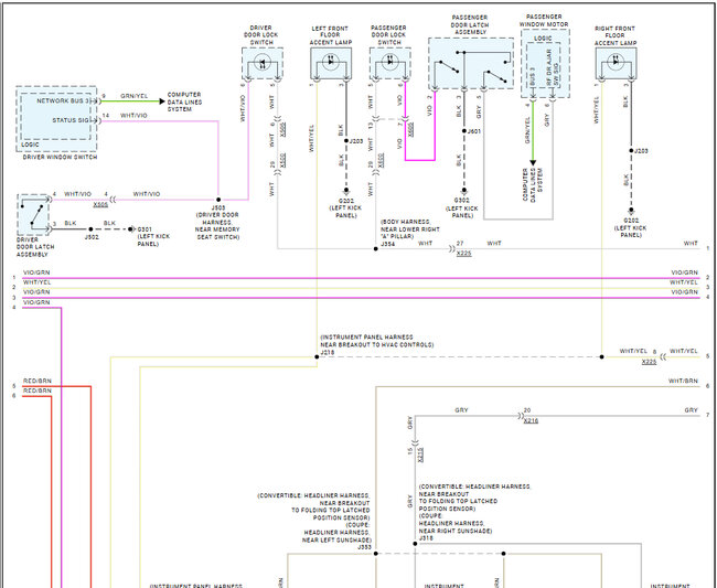

I am in need of an interior wiring diagram for the lighting circuit that includes the illuminated door sills. Any help would be greatly appreciated.
Feb 12, 2025 at 12:03 AM
  • 55,691 POSTS
These lights are run by the accent light control module and the BCM FYI. Here is a guide to help you check the wiring and the courtesy light wiring diagrams as requested.
Check out the images (below). Let us know if you need anything else.
