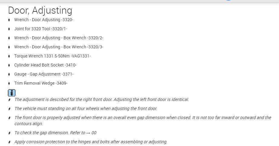

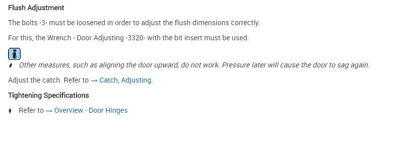

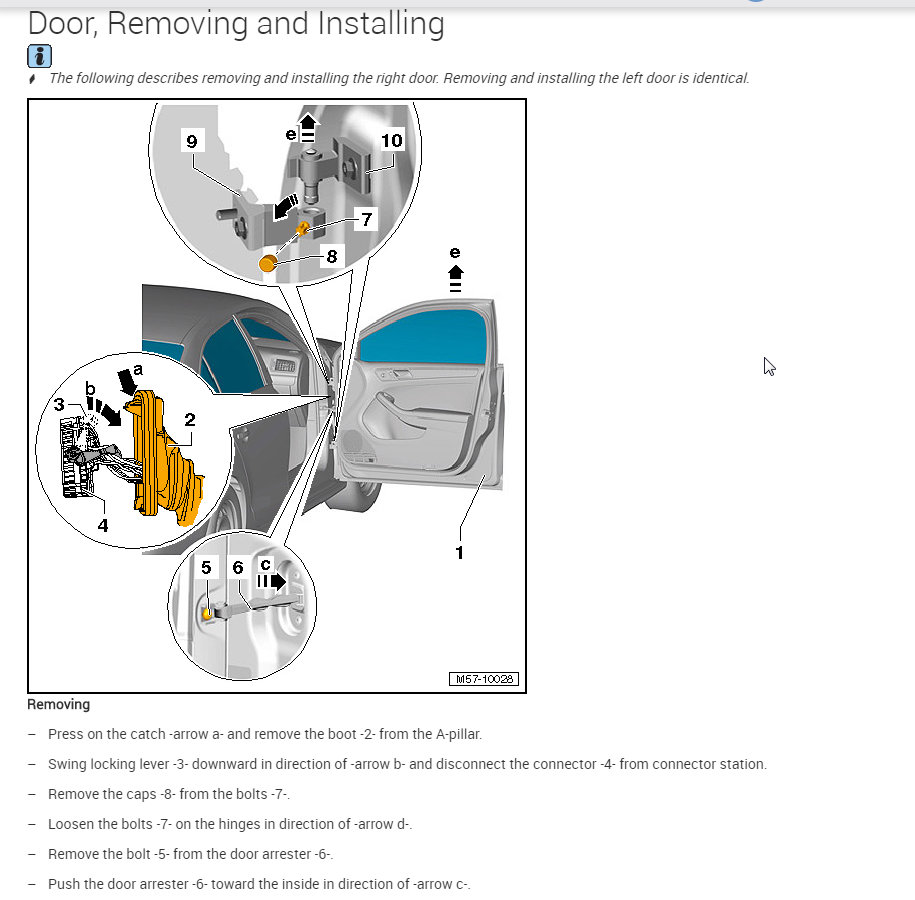

Hey, I’ve looked around and couldn’t find specifics on how to remove an mk6 vw Jetta door . The front driver door to be specific. Any information is helpful thanks.
Jul 31, 2019 at 8:07 PM

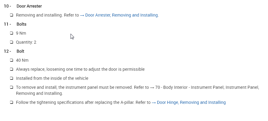

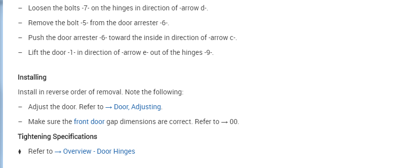

Hi Justin,

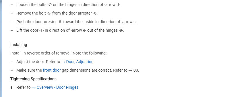

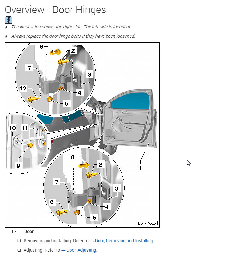

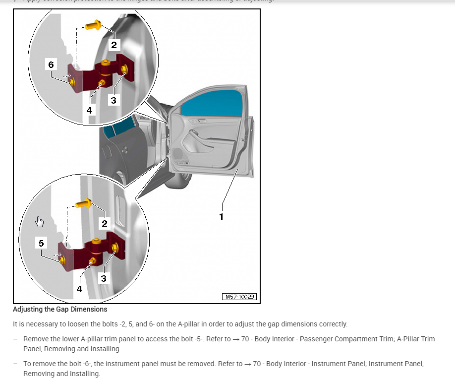

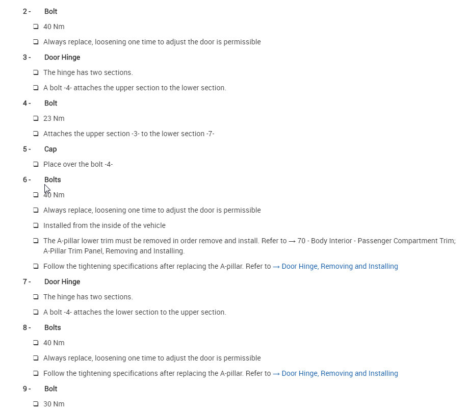

Attached is the detail to remove and install the door. Clearly this is the passenger side but it is the same on both sides.
Hopefully this helps because I don't see any videos out there for your vehicle. Let me know if you need more and I can try to find a similar car.
