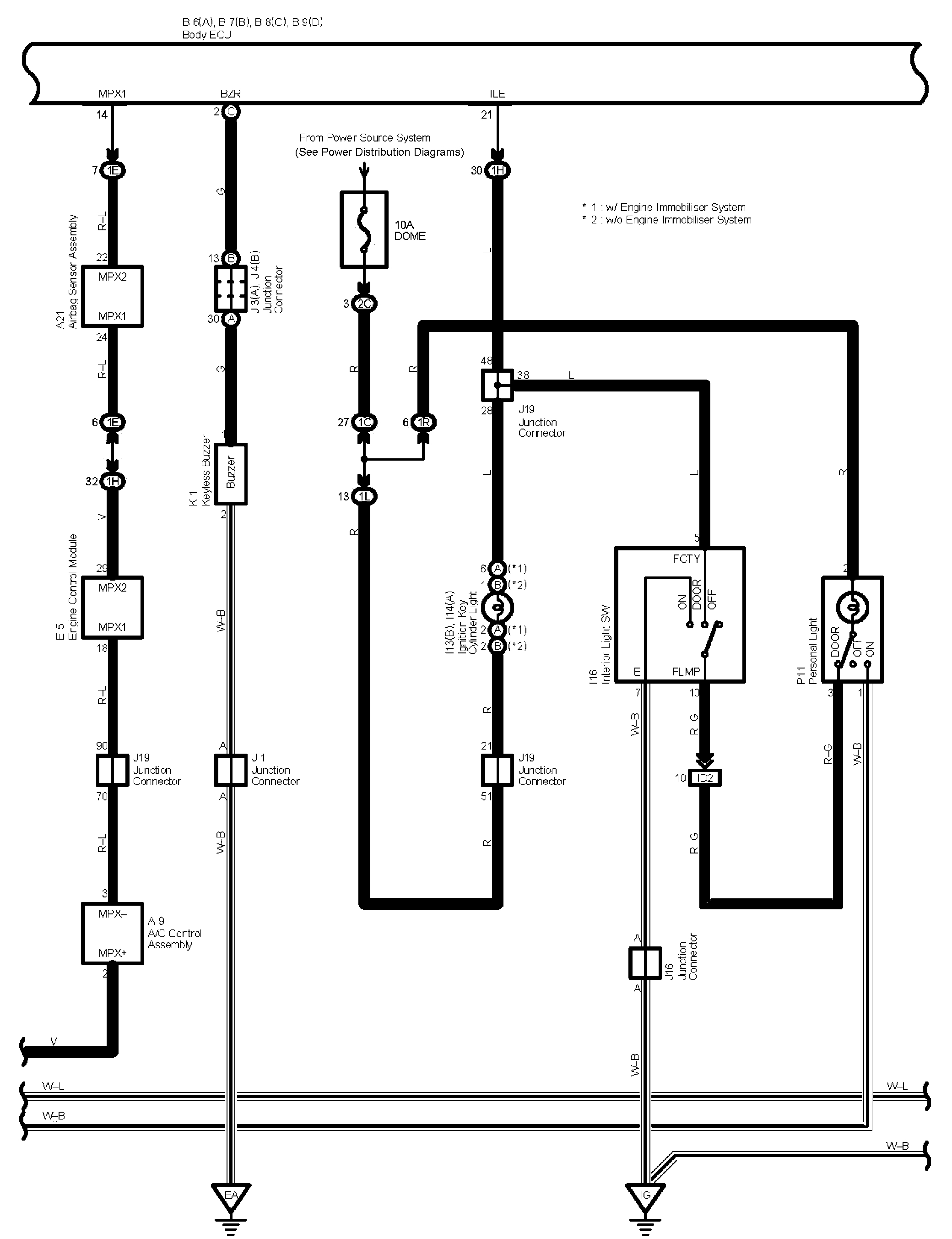

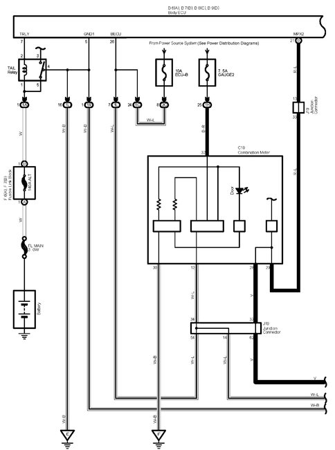

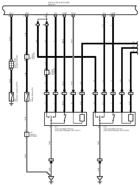

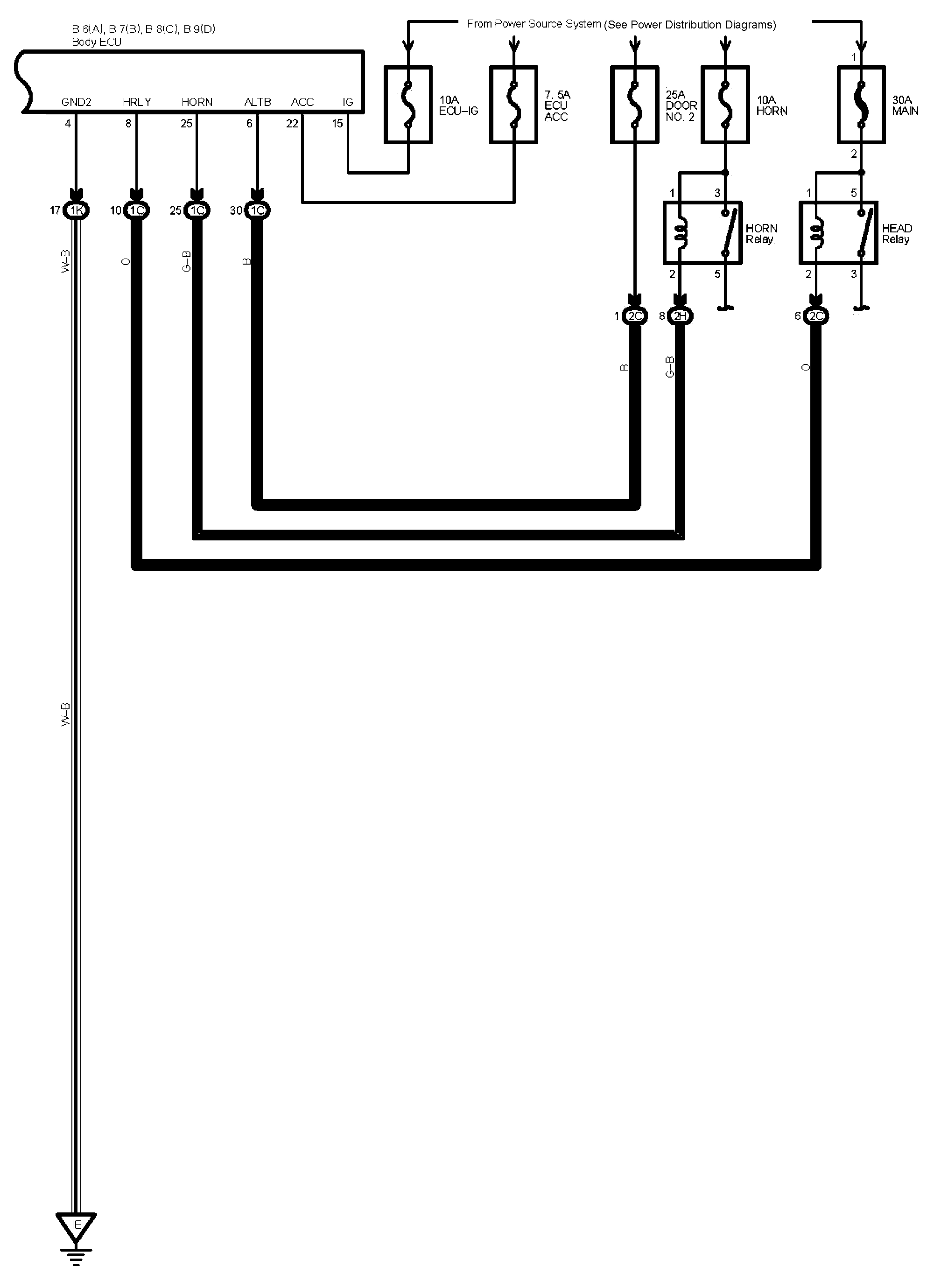

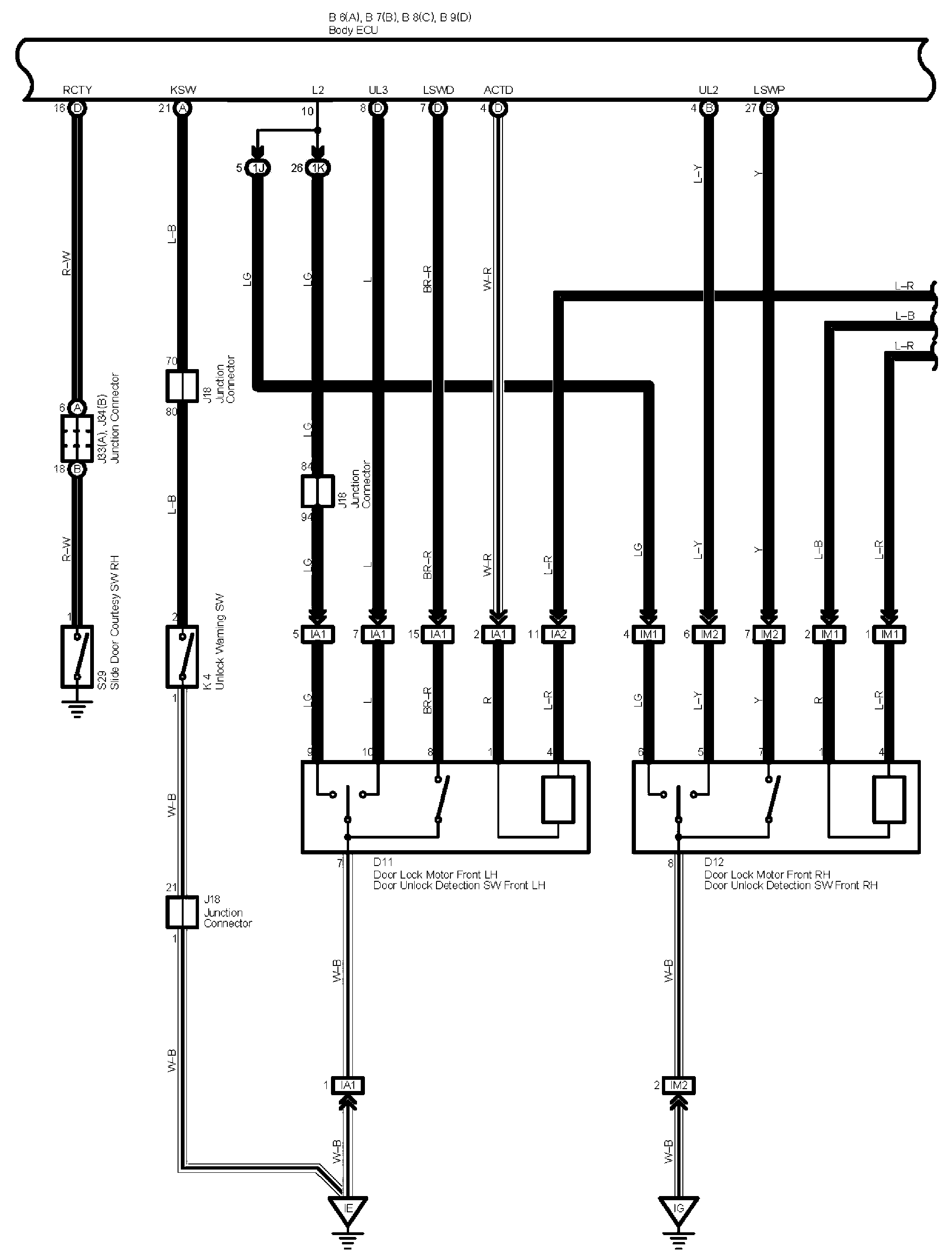

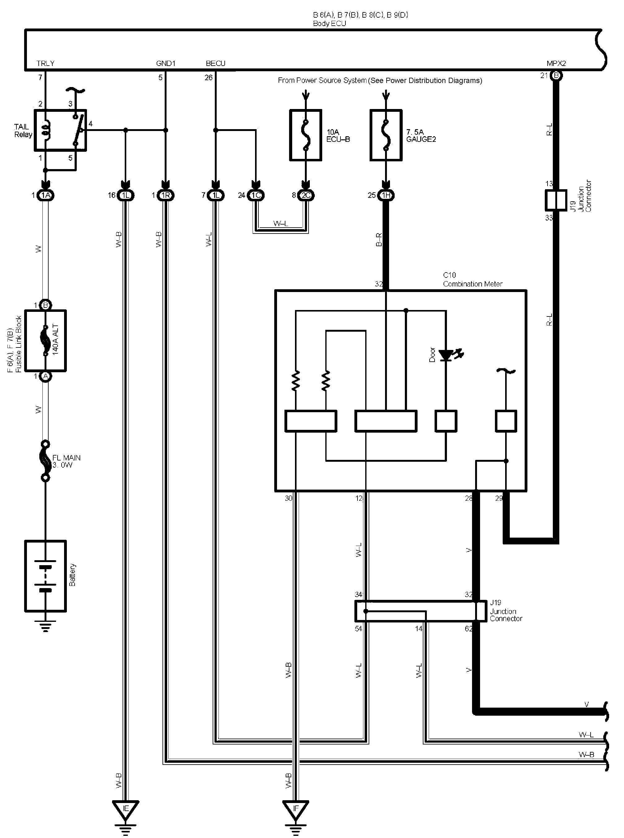

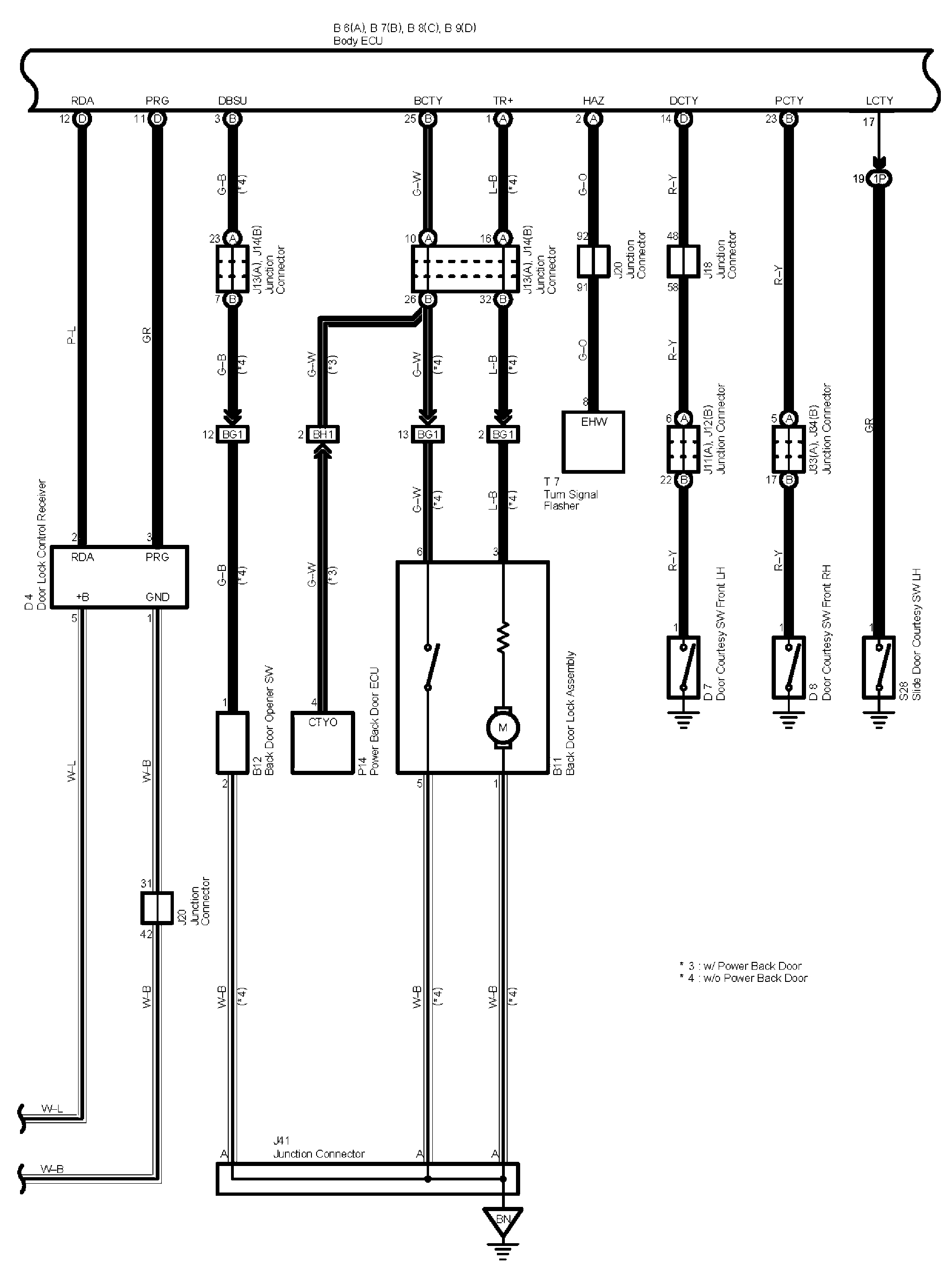

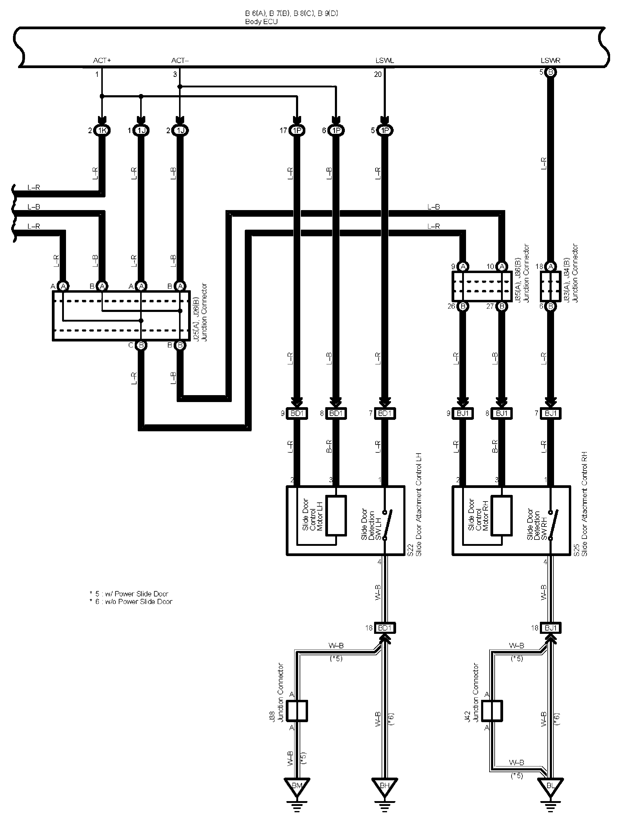

Good morning, I thought it was a weak battery but I replaced it yet it not it is not coming up. I decided to purchase new remote control but the wires are not the same with the ones that came with the vehicle. Could I have a diagram or pinout of the control unit?
Dec 30, 2020 at 1:46 AM
  • 110,194 POSTS
I have attached the wiring schematics for the keyless entry system. As far as the problem, did it start all at once? Does any function on the fob work?
Dec 30, 2020 at 10:54 PM
BLESSING EWOBOR
  • 753 POSTS
The problem start at once and none of the function work on the fob.

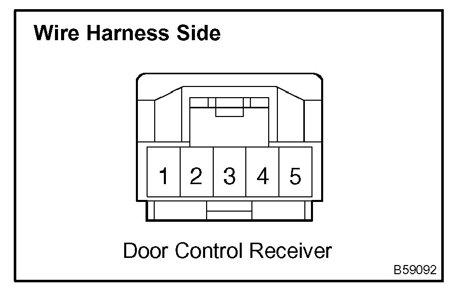

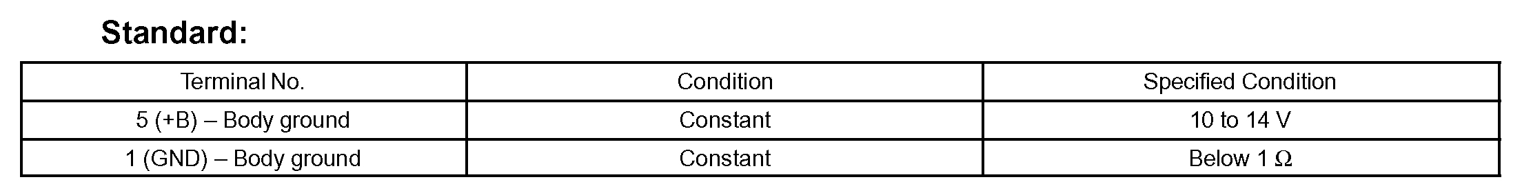

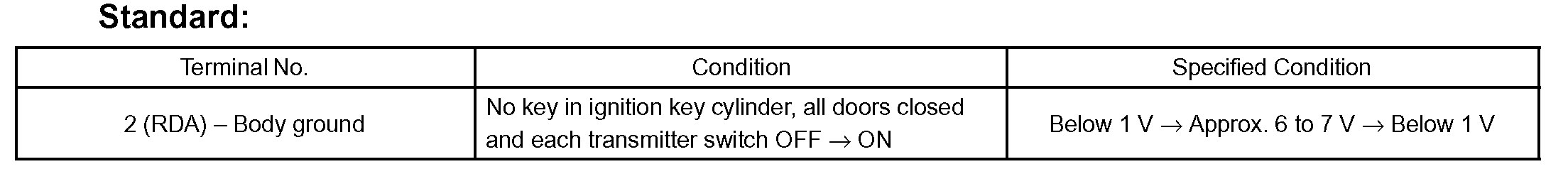

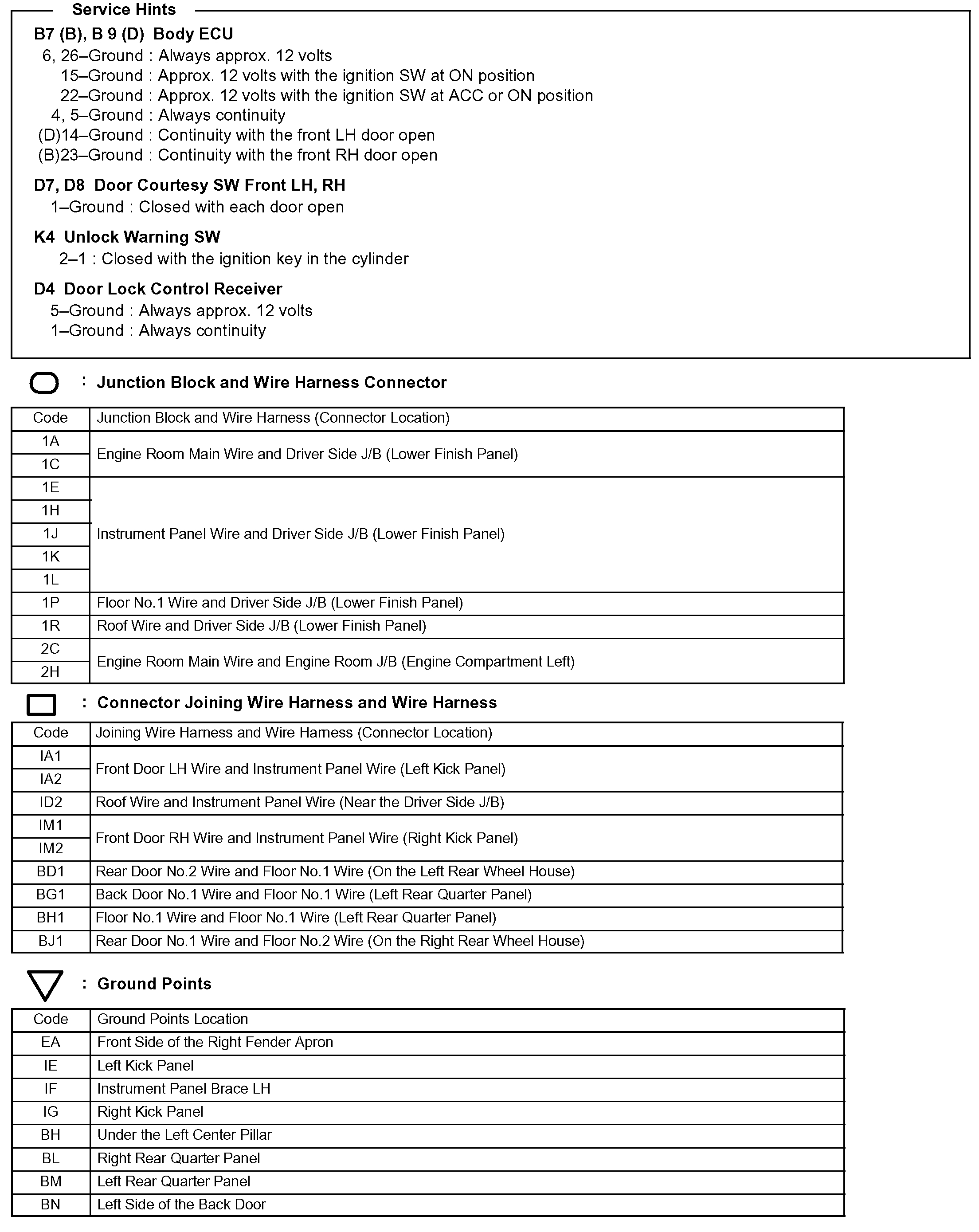

Have you checked all fuses? Also, if nothing is working, I question if the keyless entry receiver is working. Here are the directions for testing it. The attached pics correlate with the directions.
_________________________________________
2004 Toyota Truck Sienna FWD V6-3.3L (3MZ-FE)
Component Tests and General Diagnostics
Vehicle Accessories and Optional Equipment Antitheft and Alarm Systems Keyless Entry Keyless Entry Receiver Testing and Inspection Component Tests and General Diagnostics
COMPONENT TESTS AND GENERAL DIAGNOSTICS
pic 1
CHECK DOOR CONTROL RECEIVER
a. Disconnect the receiver connector.
pic 2
b. Check the voltage and resistance between the terminals of the wire harness side connector and the receiver and the body ground.
If the result is not as specified, there may be a malfunction on the wire harness side.
pic 3
c. Reconnect the connector and check the voltage between the terminal and body ground.
If the result is not as specified, the receiver may have a malfunction.
