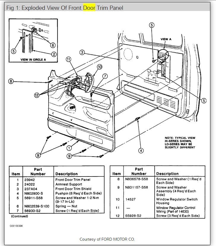

The thumb door release became hard to push and finally would not move. Naturally the inside door release does not work either. What can de done?
Thanks.
Dec 2, 2018 at 6:05 PM
  • 55,746 POSTS
You must remove the inside door panel to get at the door latch which sounds like it needs it be replaced. Here is a guide to help get you started:
https://www.2carpros.com/articles/door-panel-removal
You may need to remove the front seats. Here are diagrams to help you replace the latch.
