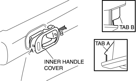

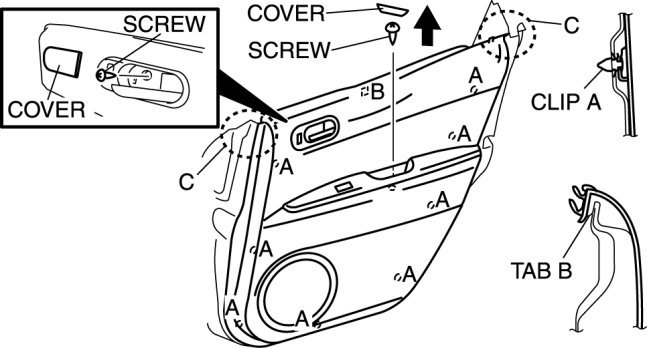

Lets start with the door handle/lock. I suspect the two issues are related. To check, you need to remove the rear door panel and inspect for loose components.
Here are the directions for removal of the door panel. Place the window in the full up position before removing the panel.
2010 Mazda Truck CX-7 FWD L4-2.5L
Removal and Replacement
Vehicle Body and Frame Doors, Hood and Trunk Doors Rear Door Rear Door Panel Service and Repair Removal and Replacement
REMOVAL AND REPLACEMENT
REAR DOOR TRIM REMOVAL/INSTALLATION
1. Disconnect the negative battery cable.
2. Remove the sail garnish. See: Trim Panel > Removal and Replacement > Sail Garnish Removal/Installation
3. Remove the covers.
See pic 1
4. Remove the screws.
5. Detach clips A from the door trim using fastener remover.
6. Pull the door trim upward and detach tabs B from the door.
CAUTION:
- Remove the rear door trim being careful not to scratch areas C of the sash film.
7. Disconnect the power window sub-switch connector.
8. Disconnect the door lock switch connector.
See pic 2
9. Remove the inner handle cover.
10. Remove the rear door trim.
11. Install in the reverse order of removal.
__________________________
Once that is removed, inspect the latch and handle assembly to see if something is just loose or broken.
Let me know what you find.
