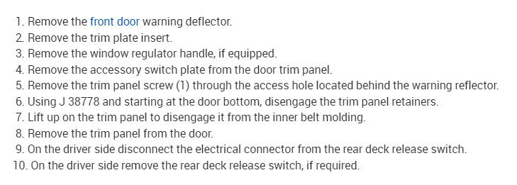

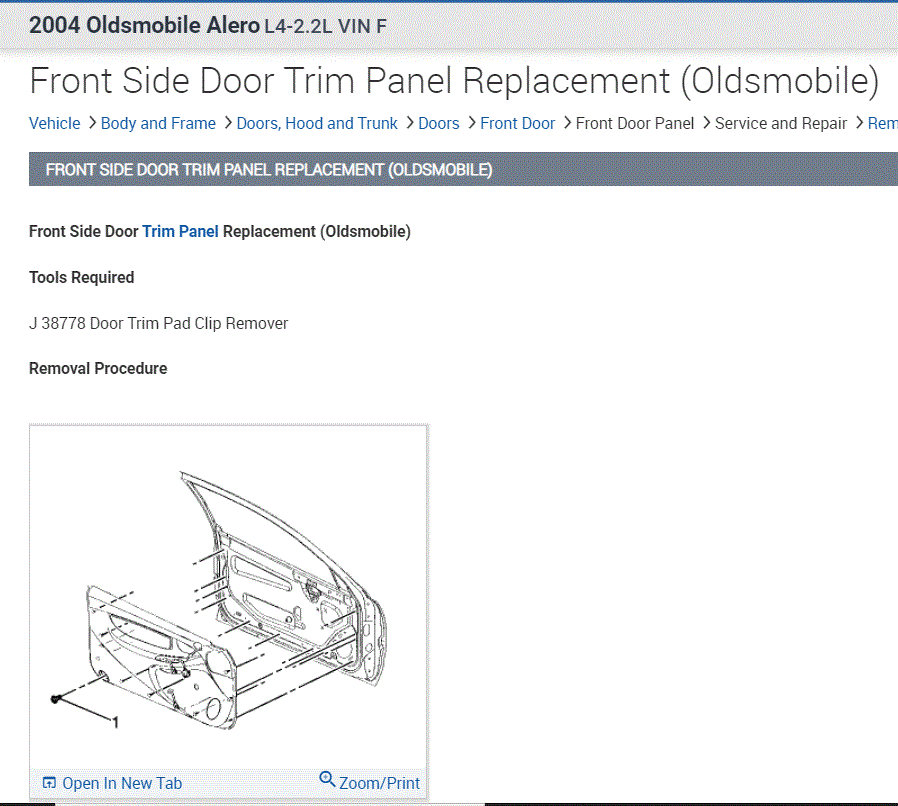

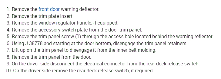

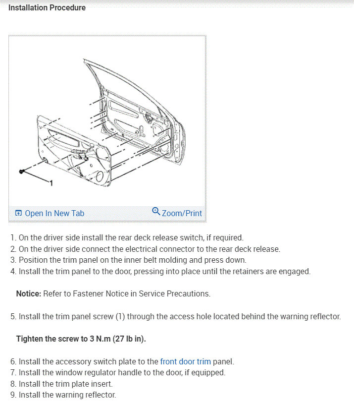

Trying to remove door panel to replace window actuator on power windows.
Dec 30, 2021 at 9:38 AM
  • 110,241 POSTS
If you look below, I attached the directions for the removal and replacement of the front door panel. There is one screw behind the reflector on the panel and several plastic clips that hold it in place. If you don't have a plastic fastener removal tool, you may want to get one. Otherwise, you may end up with a lot of broken clips.
