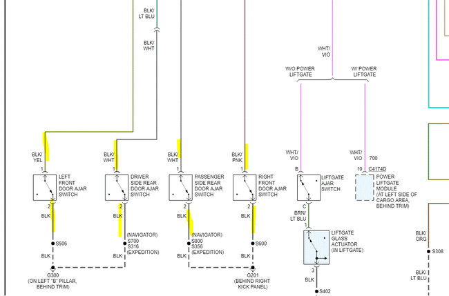

How do I find out which door sensor is faulty because the door open warning is always on?
Sep 12, 2020 at 8:58 PM
  • 110,194 POSTS

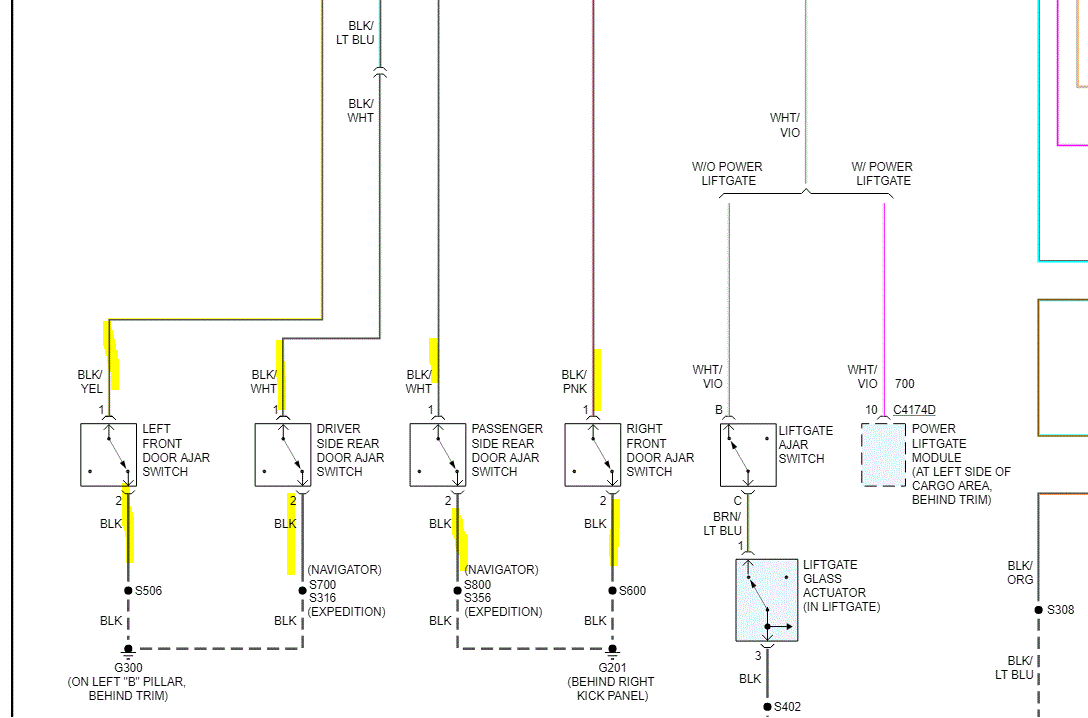

In most cases, the door that is used most often is the problem. However, you can check it. I attached a pic below that shows the wiring at each door switch. What you need to do is simply disconnect each of the switches, one at a time. That will open the circuit from ground and should turn the light off.

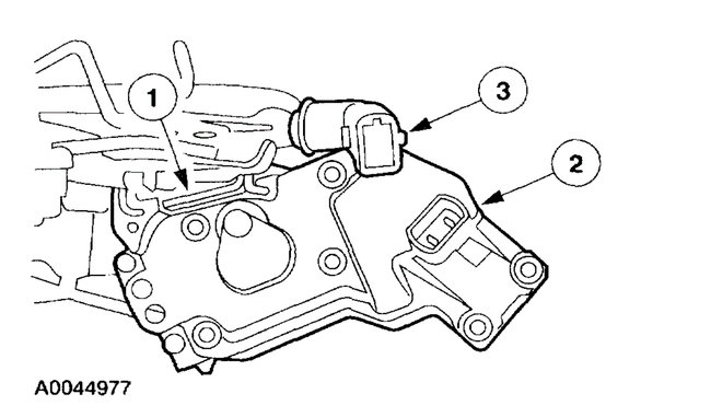

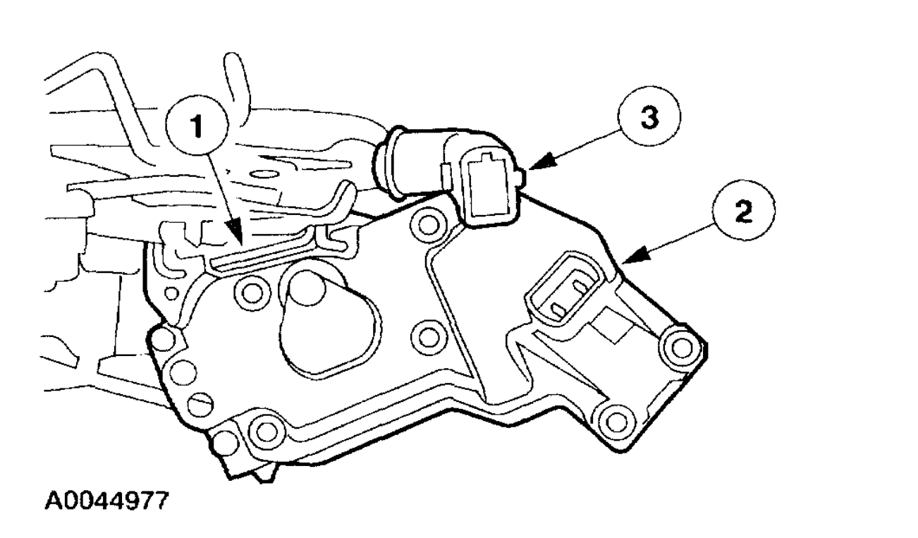

The switch is part of the latch assembly. You will need to remove the door panels to access it. Again, only do one at a time and start with the driver's door simply because it is likely the most used door.
I attached two pictures. The first shows the door switches and hot the power flows. The second is the latch assembly.
