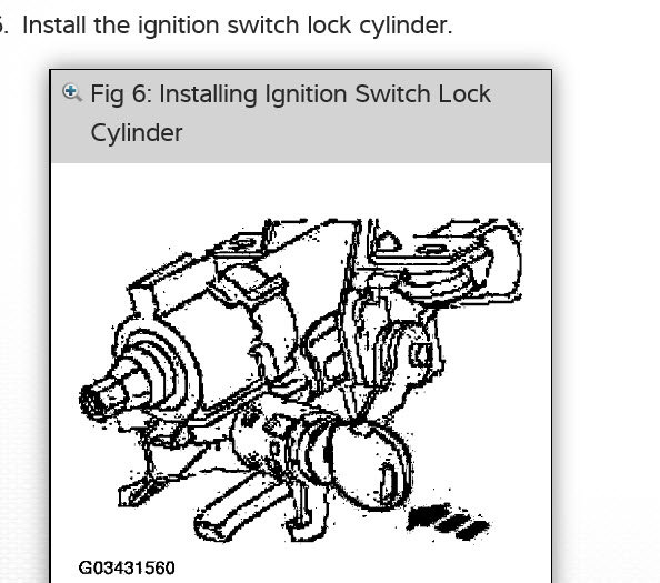

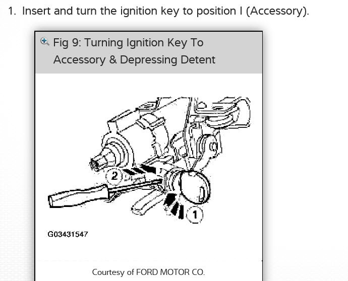

Hi, did GEM test, door switch no response, light remains on. However, I found the key-switch does not lock in key ( pulls out easily, ) when engine is on. Also seems pushed in a bit until the key is removed in the off position. Could this be the problem? Any way to repair this without changing switch assembly? Your help is much appreciated!
May 31, 2016 at 2:17 PM
HMAC300
  • 48,601 POSTS
see pics
