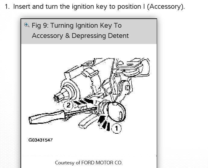

I have taken a good door closed switch from my 2000 focus and swapped it out with all four doors on the 2002. Interior light comes on. I have checked the trunk, the light is on when opened, off when closed. Even swapped the trunk latch mechanism with my spare. No fix. Removed door panel, no electrics, ( except for speaker wires ), to door latch.
I am a bored IBM retiree and I am fixing up this focus as a project. Lots of fun so far, but this little thing has me awake at night.

check the gem module and battery saver relay, although I think it is the gem. that may need to be scanned by a professional to fix and also programmed to your car see this link on how to test it.

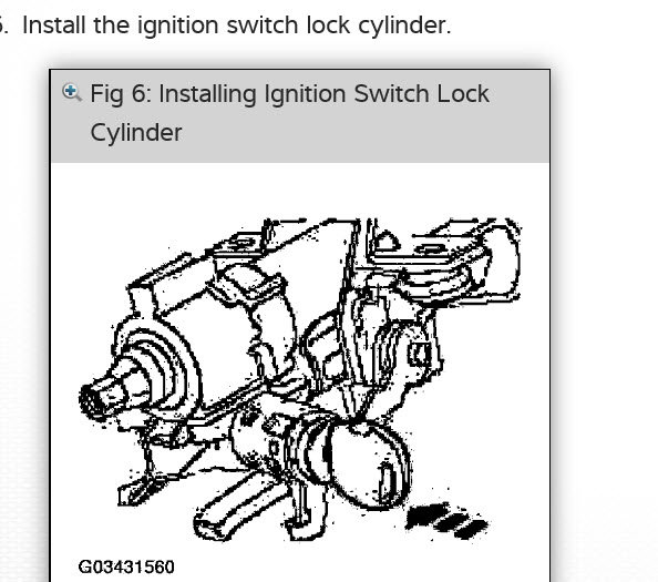

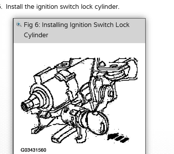

Hi, did GEM test, door switch no response, light remains on. However, I found the key-switch does not lock in key ( pulls out easily, ) when engine is on. Also seems pushed in a bit until the key is removed in the off position. Could this be the problem? Any way to repair this without changing switch assembly? Your help is much appreciated!

HMAC300
  • 48,601 POSTS
see pics
