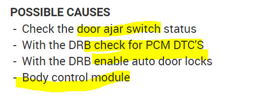

The door lock mechanism is constantly going up and down and staying on.
Oct 26, 2021 at 9:28 AM
  • 110,194 POSTS

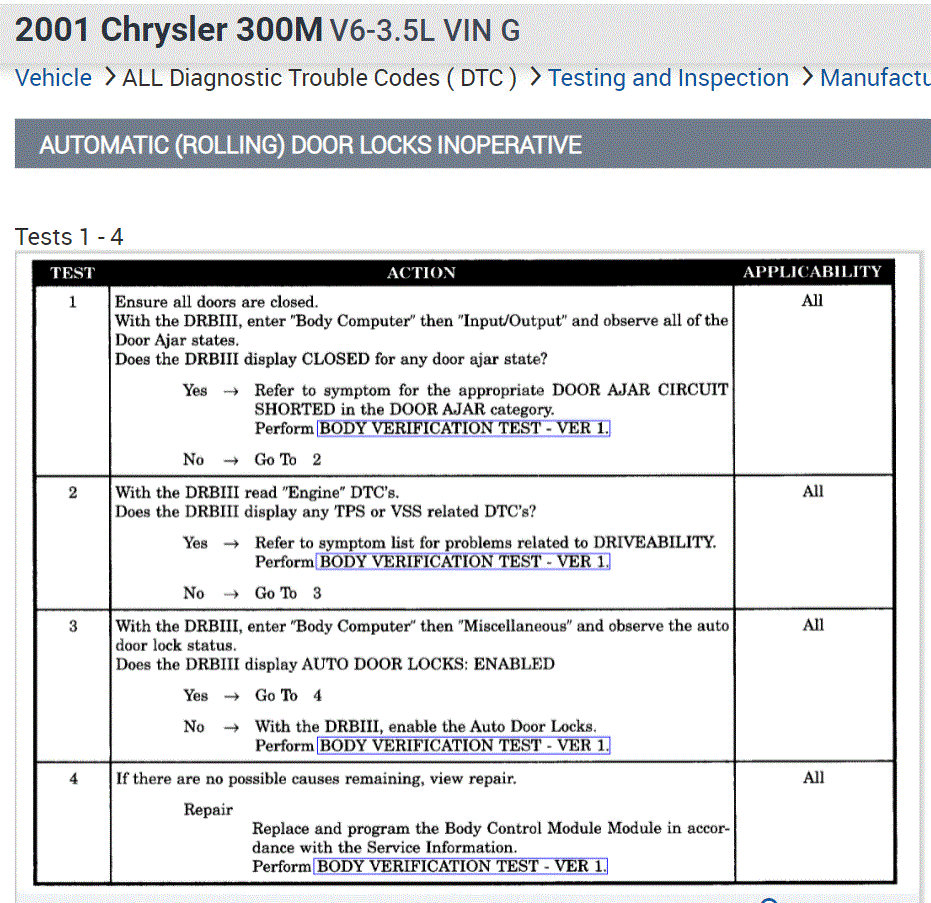

By chance, does the door open light flicker when this happens? I ask because it could be a switch, an issue with the body control module, or even a wiring issue.
Do me a favor. Take a look at the diagnostics below related to inoperative automatic rolling door locks and let me know if you are comfortable performing them. Also, let me know if this affects all locks or just one.
