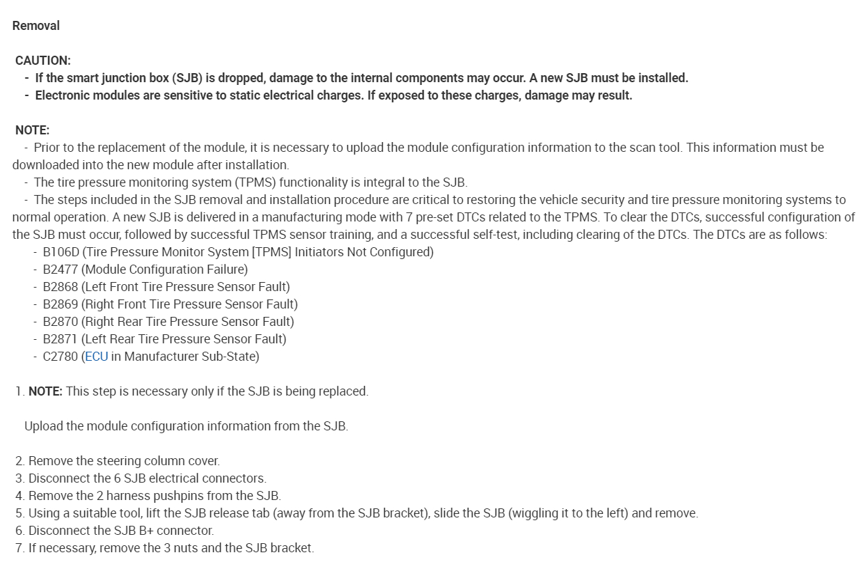

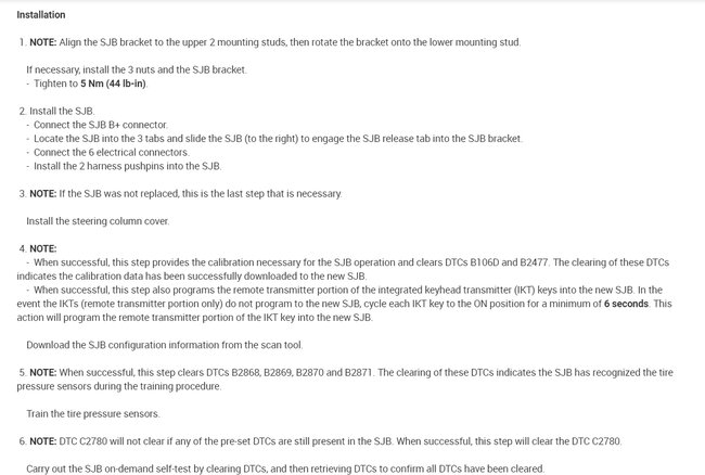

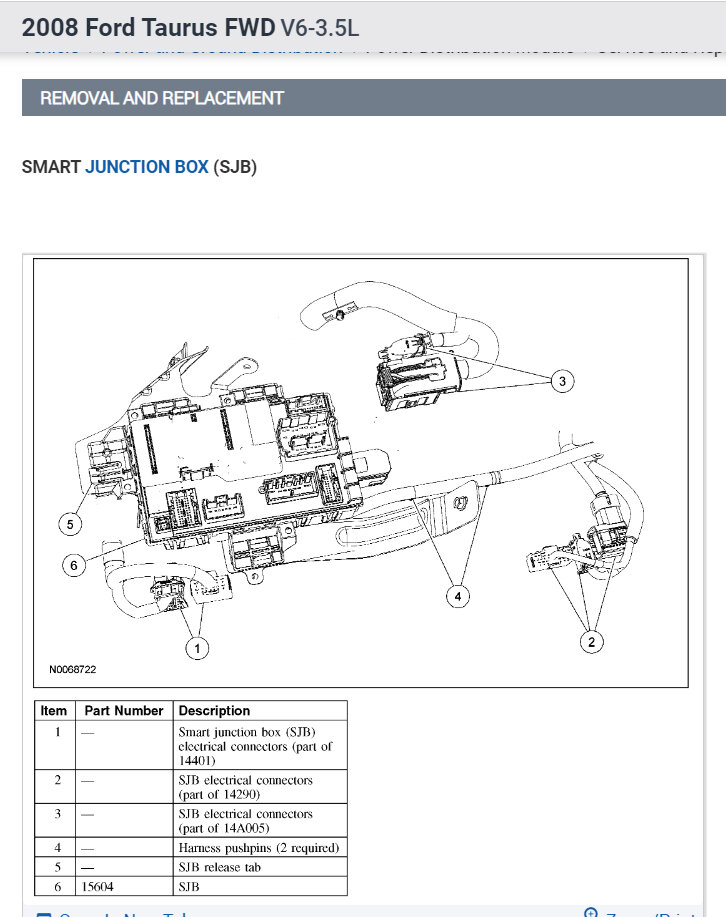

This happens when the SJB goes out, but to be sure you should do a CAN scan. You can get a CAN scanner (Controller Area Network) which will work on most cars from Amazon.
https://youtu.be/u-4syLc-ifQ
Here is how to change the SJB out in case you need it. Check out the images (below). Let us know what happens and please upload pictures or videos of the problem so we can see what's going on.
