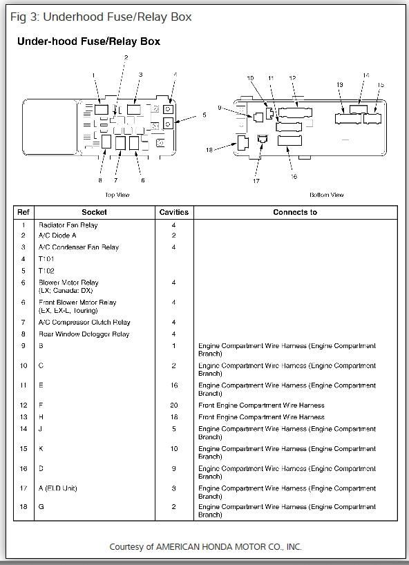

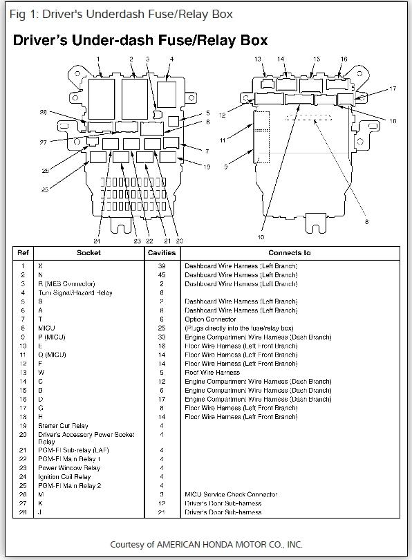

Here are the diagrams, and what the fuses go to, check the main fuses as well, One is under the hood, and the other under the dash on the drivers side, you might have to remove a small panel to access it.
Use this guide to check, follow the diagrams below.
Please let me know what you find.

I got a tester light. I tested all the fuses in the driver side panel. the light came on except for #24, 25, and 26. I pulled the fuses out and they are still good. wondering what the next step should be.
