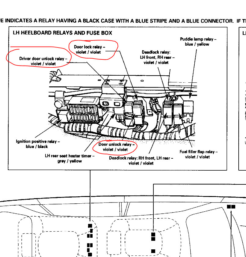

Good afternoon, I’m trying to locate the correct fuse block and fuse first on my vehicle listed above 4 door. FYI, the trunk button on the deck lid doesn’t work either. They quit about the same time. Can you help? Thank you, Chris
Aug 21, 2021 at 6:45 AM
SQM
  • 6,383 POSTS

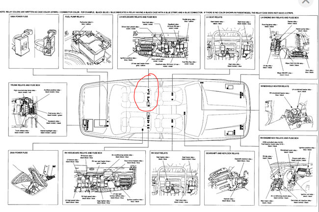

The door locks are control by relays. There is a fuse block on the LH side rear floor. (see diagram). There are few relays that controls the door lock on that vehicle.
First do a visual inspection of the relays.
You can also test the relays as well:
Let me know of any questions.
