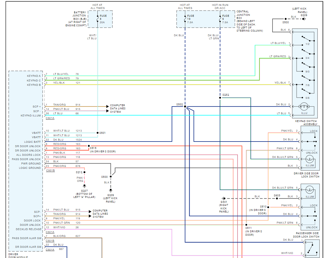

my door locks,fob, trunk, and door lock switch not working.

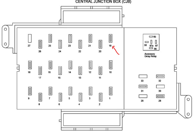

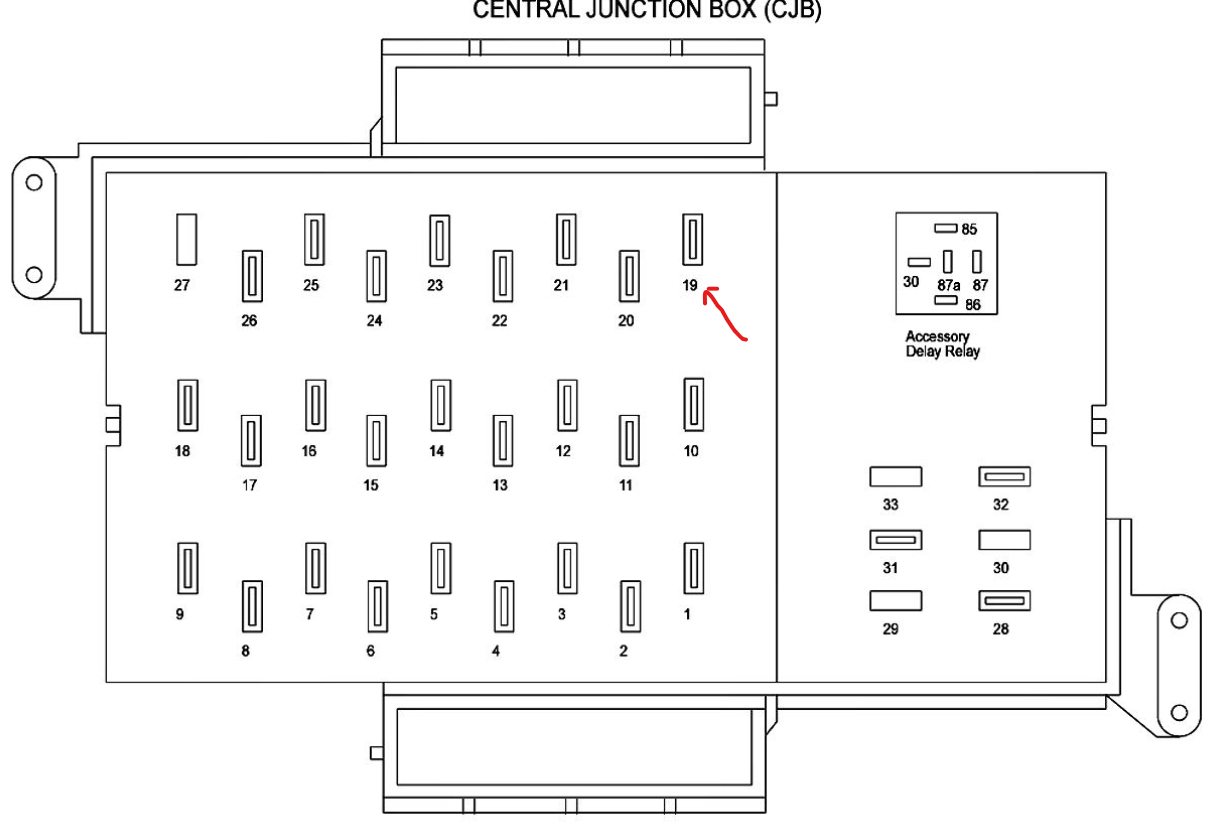

I would start by checking fuse #19 in the central fuse panel inside the car, here is a guide to help and the fuse locations as well:

We checked all fuses. number 19 also. all fuses good. thank you

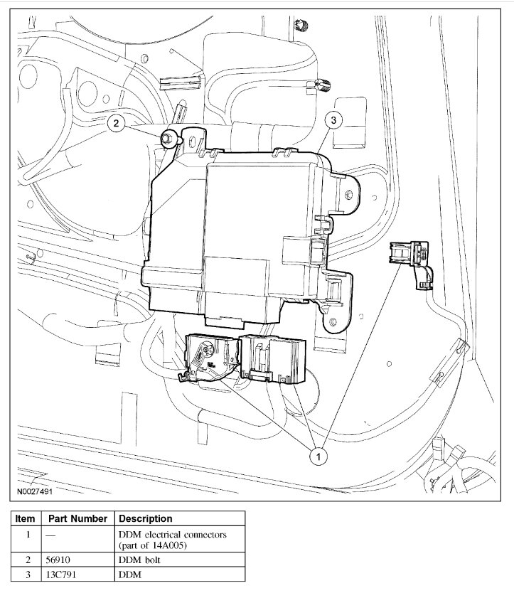

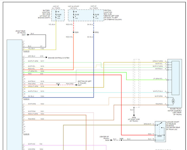

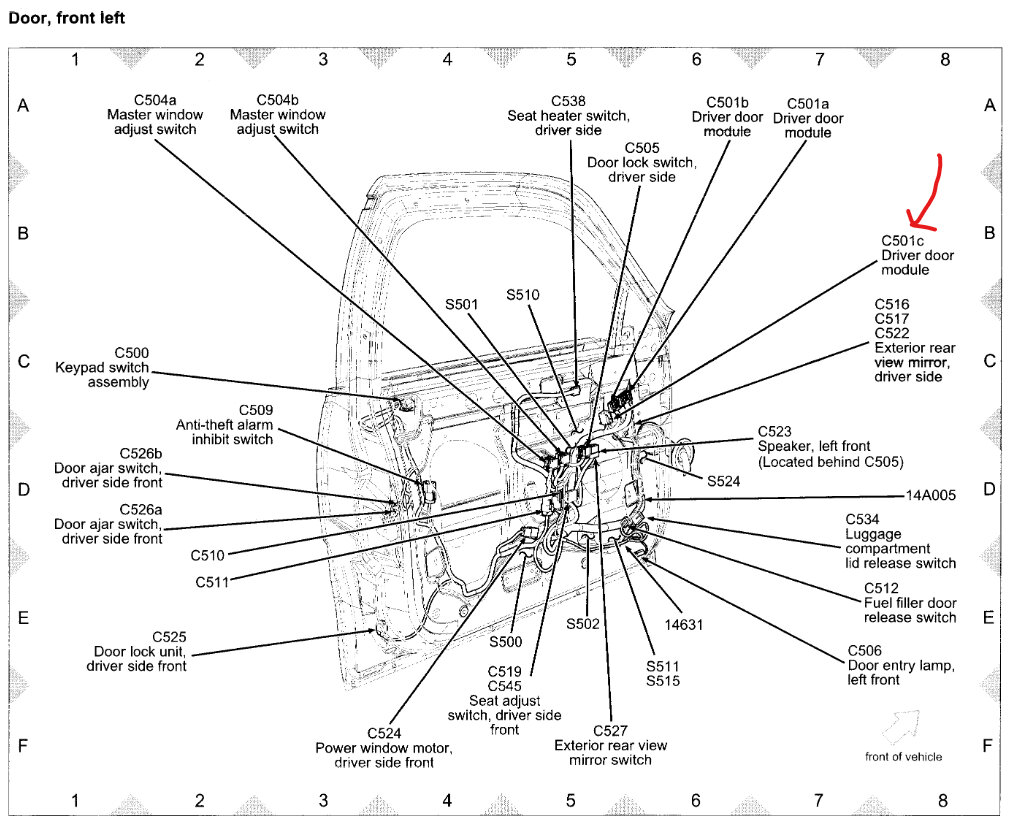

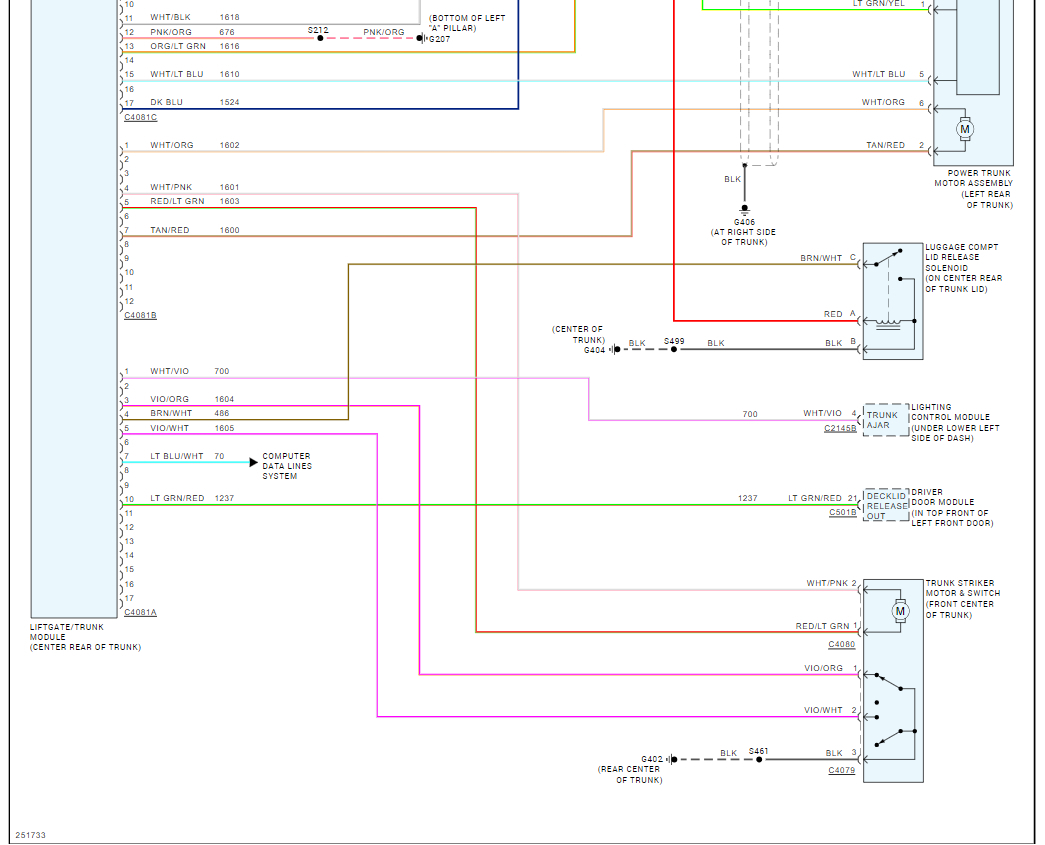

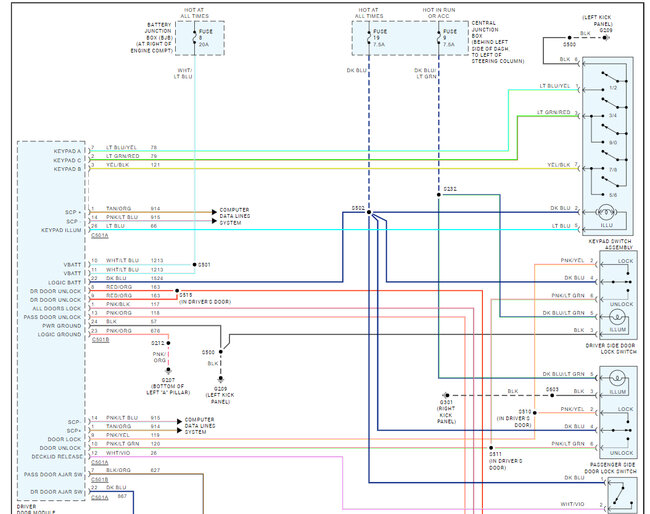

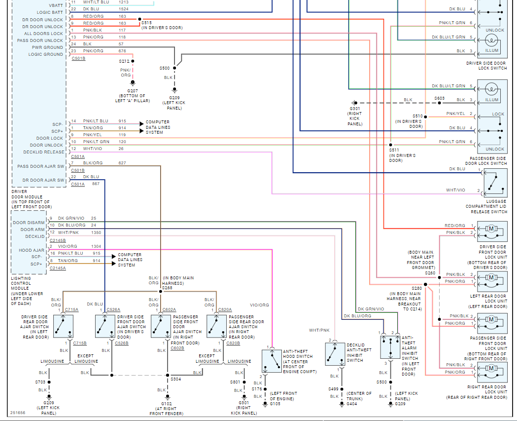

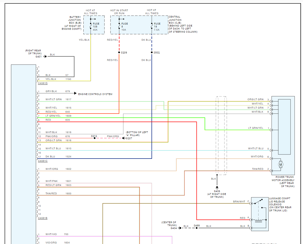

Okay, I was hoping for fuse #19 because both systems share that fuse. Did the fuse have power? So, it looks like the driver's door module has gone out, but I would check the other fuses as well. Here are the other fuses in the system and the wiring diagrams so you can see how the door lock and trunk work. Here is the location of the DDM so you can swap it out if the fuses are good. The wiring diagrams have the fuses you should check. Check out the images (below). Let us know how it goes.
