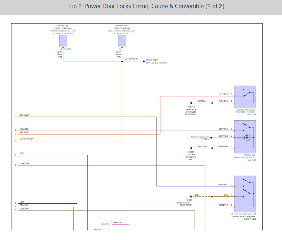

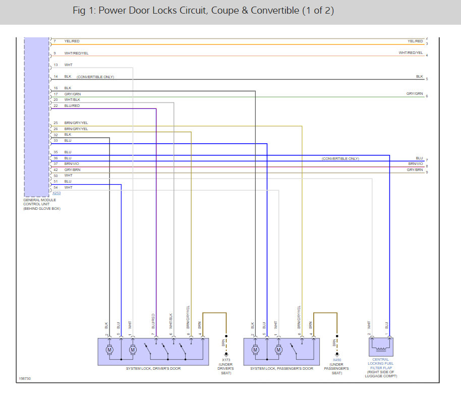

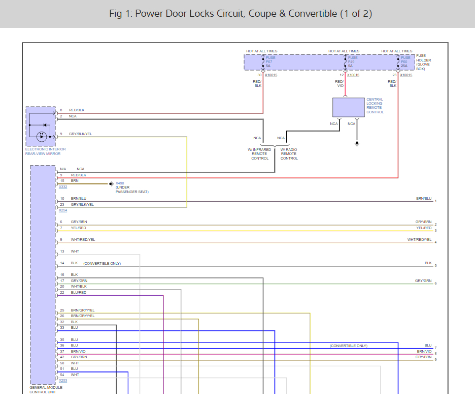

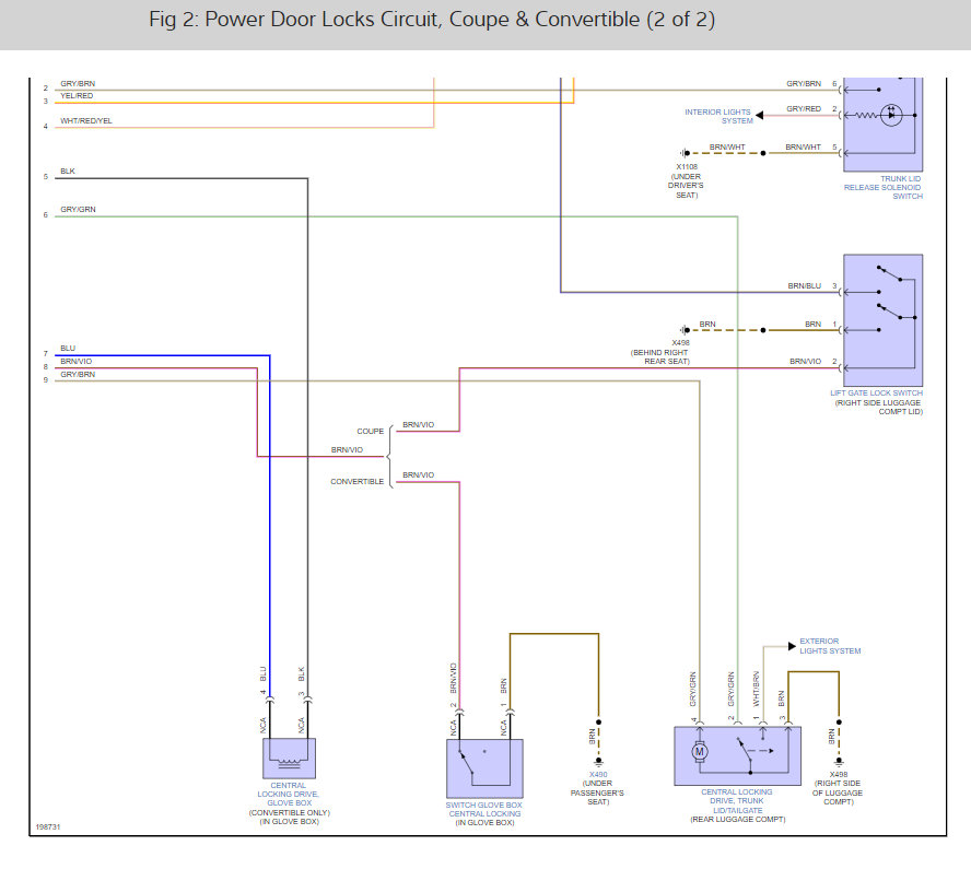

I did put the BMW e36 318i m43 engine. After the doors are locked, I can only open from the driver's side. when I did bypass the ews 2.
Jul 8, 2022 at 4:31 PM
  • 55,710 POSTS
Let's start by checking the fuses #f67, f49 and f60 int her glove box fuse panel, here is a guide to help and I have included the door lock wiring diagrams so you can see how the system works.
