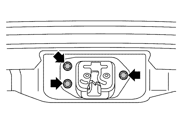

Lock to my hatchback stopped working
2009 NISSAN VERSA
75,700 MILES
CYNIMEN
Can I repair it myself?

I am attaching the directions for lock replacement. It shouldn't be too difficult to do, but let me know if you need help. The attached picture correlates with the directions.
________________________
2009 Nissan-Datsun Versa L4-1.8L (MR18DE)
Removal and Replacement
Vehicle Body and Frame Doors, Hood and Trunk Trunk / Liftgate Power Trunk / Liftgate Lock Actuator Service and Repair Removal and Replacement
REMOVAL AND REPLACEMENT
BACK DOOR LOCK
Removal and Installation
BACK DOOR LOCK
Removal
1. Remove the back door finisher lower. Refer to See: Trunk / Liftgate Moulding / Trim > Removal and Replacement > Back Door Trim.
pic 1
2. Remove the bolts, disconnect the electrical connector and separate the lock from the door.
Installation
Installation is in the reverse order of removal.
