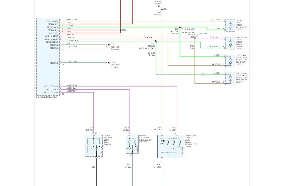

Could someone give me some insight on where to start with an issue with my door locks please? The doors will not lock or unlock anymore with the lock switch. I have replaced the master lock switch on the driver's side door but that did not help. I do not know if the is a relay or a fuse for these switches. The last time I checked I still was getting power to the switches. Thanks.

Recheck for voltage to the switch. The switch is fed through the instrument cluster. I attached a diagram for you to view to check for powers.
No, there is no relay for this control.
