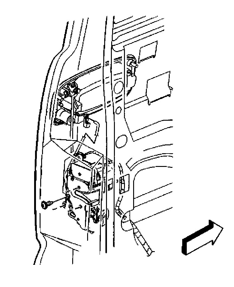

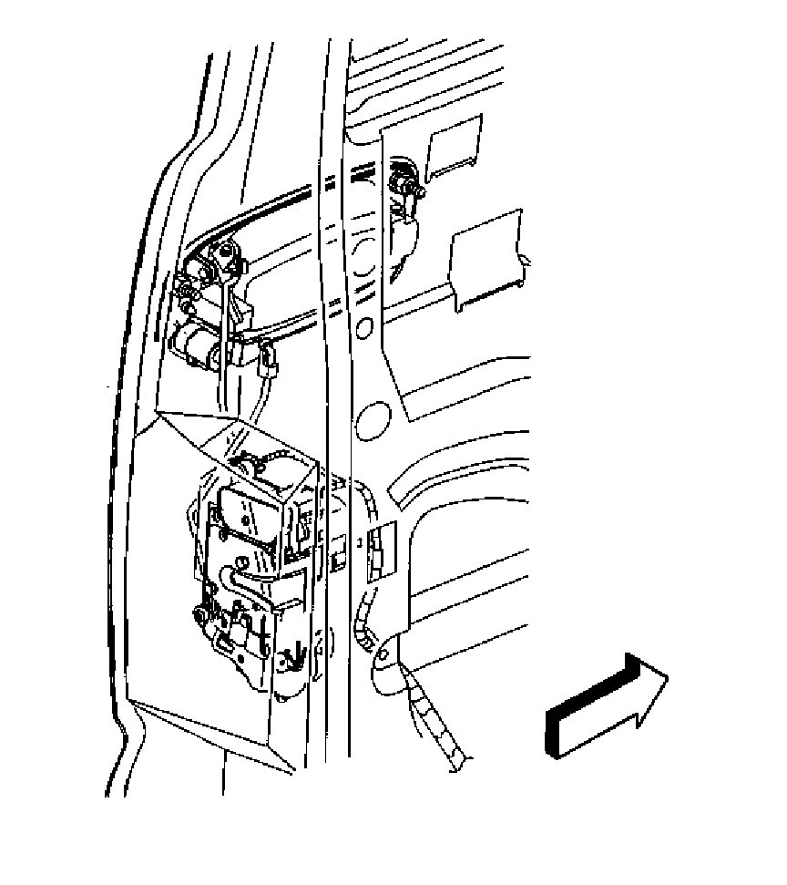

After replacing both window regulators, the doors wouldn't lock using the key fob or door switch. I can hear it trying to move.
Apr 24, 2019 at 1:15 AM
  • 110,244 POSTS
Welcome to 2CarPros.
If you can hear it trying to work, then you may have jammed the lock linkage in some way. It isn't hard to have happen. You need to remove the door panels again and inspect the linkage. Something is stopping it from moving, especially if it won't lock with the key.

Here are directions specific to regulator replacement. Picture 1 correlates with these directions.
___________________________
FRONT SIDE DOOR WINDOW REGULATOR REPLACEMENT (POWER)
Front Side Door Window Regulator Replacement (Power)
Removal Procedure
1. Raise and support the window glass.
2. Remove the trim panel. Refer to Front Side Door Trim Panel Replacement See: Front Door Panel > Removal and Replacement
3. Remove the water deflector. See: Front Door Window Glass Weatherstrip > Removal and Replacement
4. Disconnect the harness from the electric window motor assembly.
5. Remove the 2 bolts that hold the window glass to the regulator.
see pic 1
6. Remove the bolts from the window regulator.
7. Remove the window regulator assembly from the door by folding both sides of the window regulator assembly together.
8. Remove the window regulator motor. Refer to Front Side Door Window Regulator Motor Replacement (See: Front Door Window Motor > Removal and Replacement > Front Side Door Window Regulator Motor Replacement).

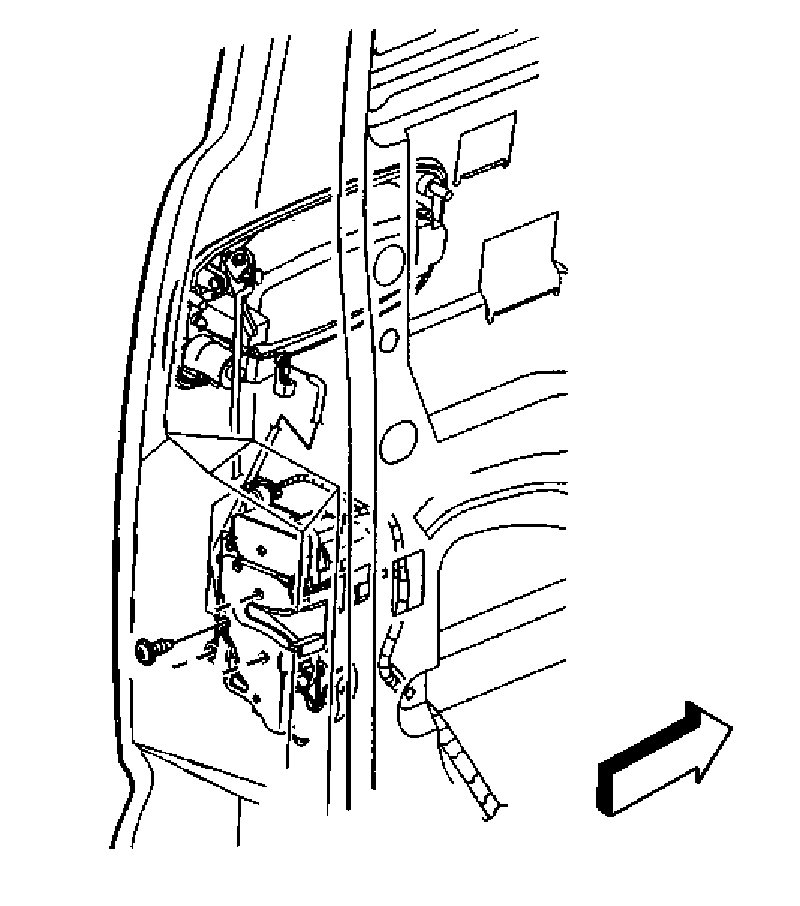

Here are the directions for replacing the actuator. I'm adding them so you can see all the linkages. Also, make sure the one which connects at the inside door handle is properly routed and movable.
LOCK ACTUATOR REPLACEMENT - FRONT DOOR
REMOVAL PROCEDURE
1. Raise the window glass.
2. Remove the door trim panel.
pic 2

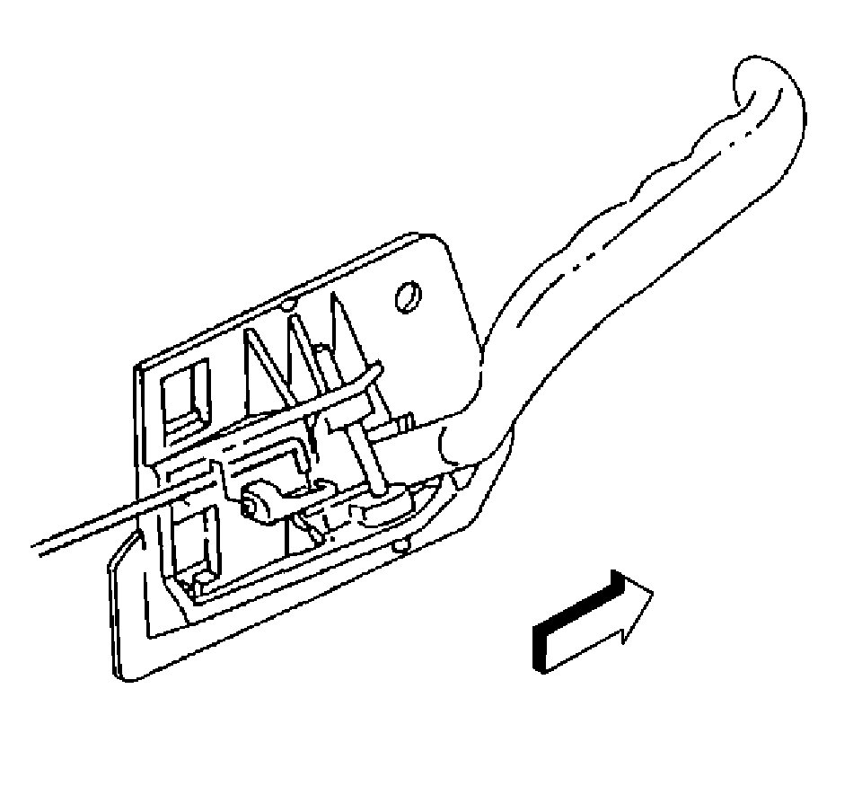

4. Disconnect the inside door lock rod from the handle retainer clip.

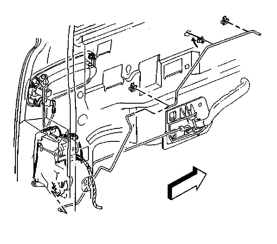

5. Disconnect the manual door lock rod from the door retainer clips.

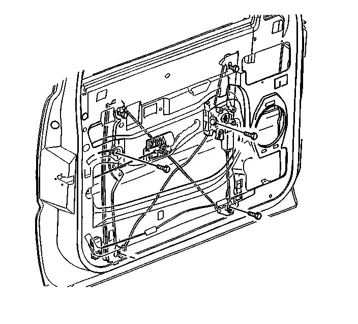

6. Remove the rubber plug in order to disengage the outside handle rod retainer.

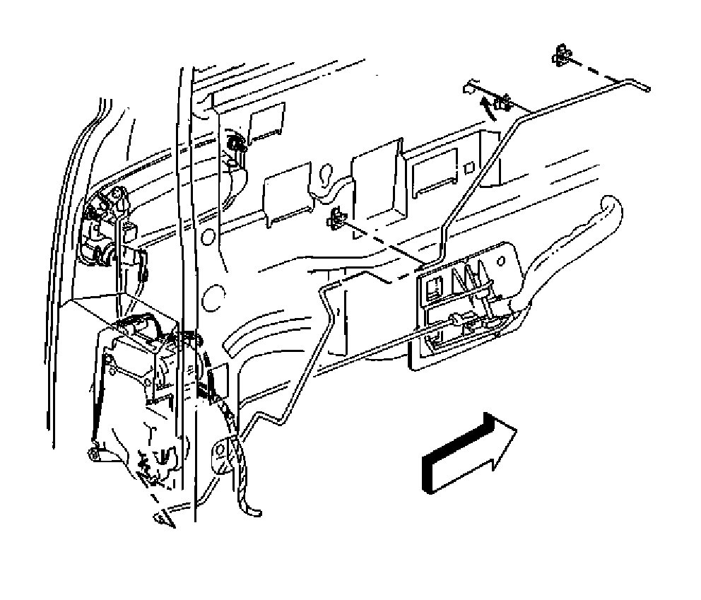

6. Install the bolts which retain the door lock actuator to the door.
Tighten
Tighten the screws to 9 N.m (80 lb in).
pic 6

Either one of the linkages is jammed or was left disconnected. Check that and let me know what you find.
