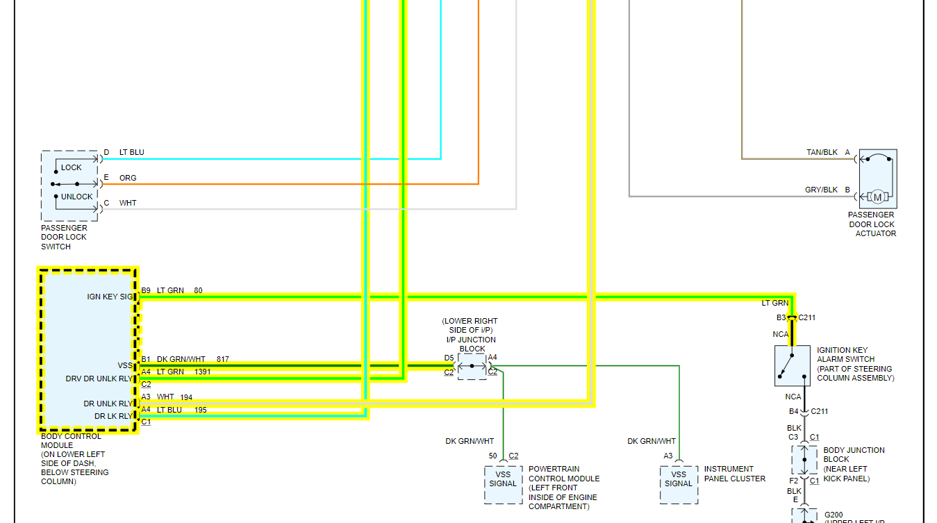

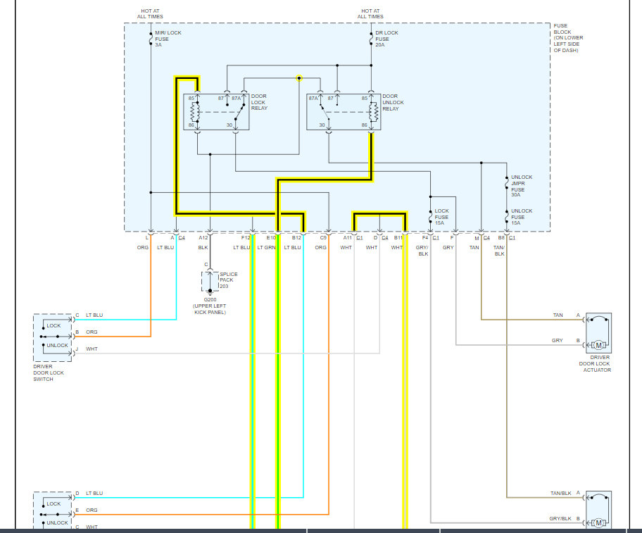

When I put my truck in drive the door will not lock it self for a minute or two when we are driving it. When we stop and put in park it will not open the lock have to unlock have to use electronic lock button. I also cannot get it program to reprogram my new remote lock key.
Apr 7, 2021 at 6:40 AM
Good afternoon,
The body control module. controls the operation of the door locks in gear.
Good possibility the body control module is bad. I attached a wiring diagram and high lighted the wires for the locks. You need an advanced scan tool to monitor the operation of the locks.

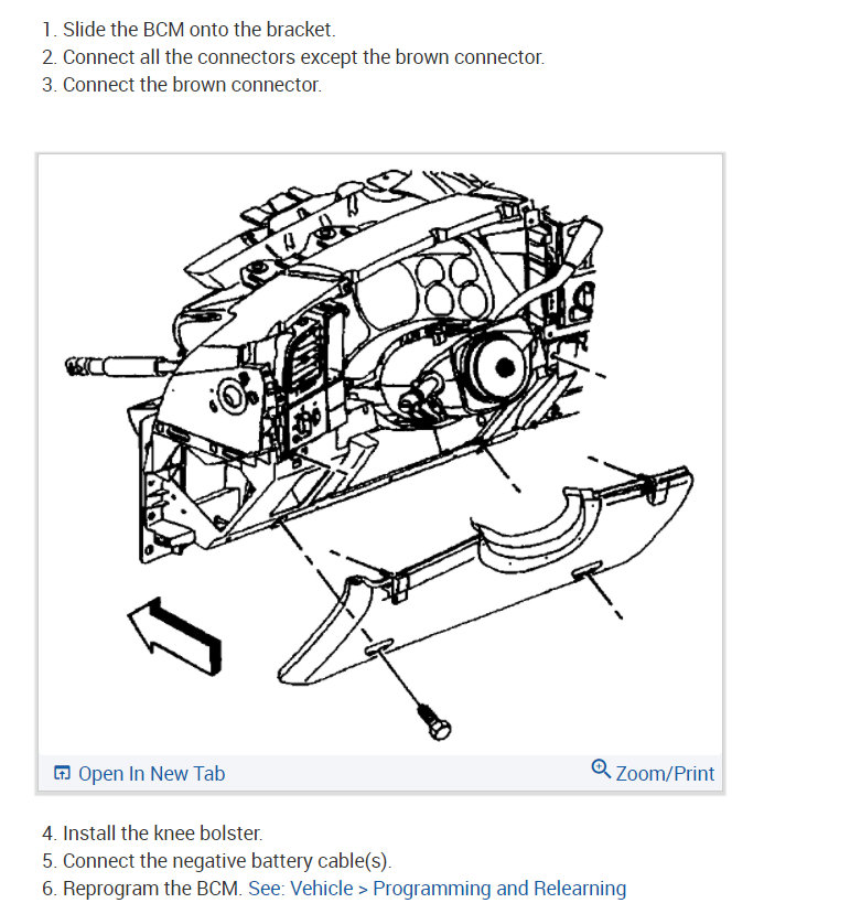

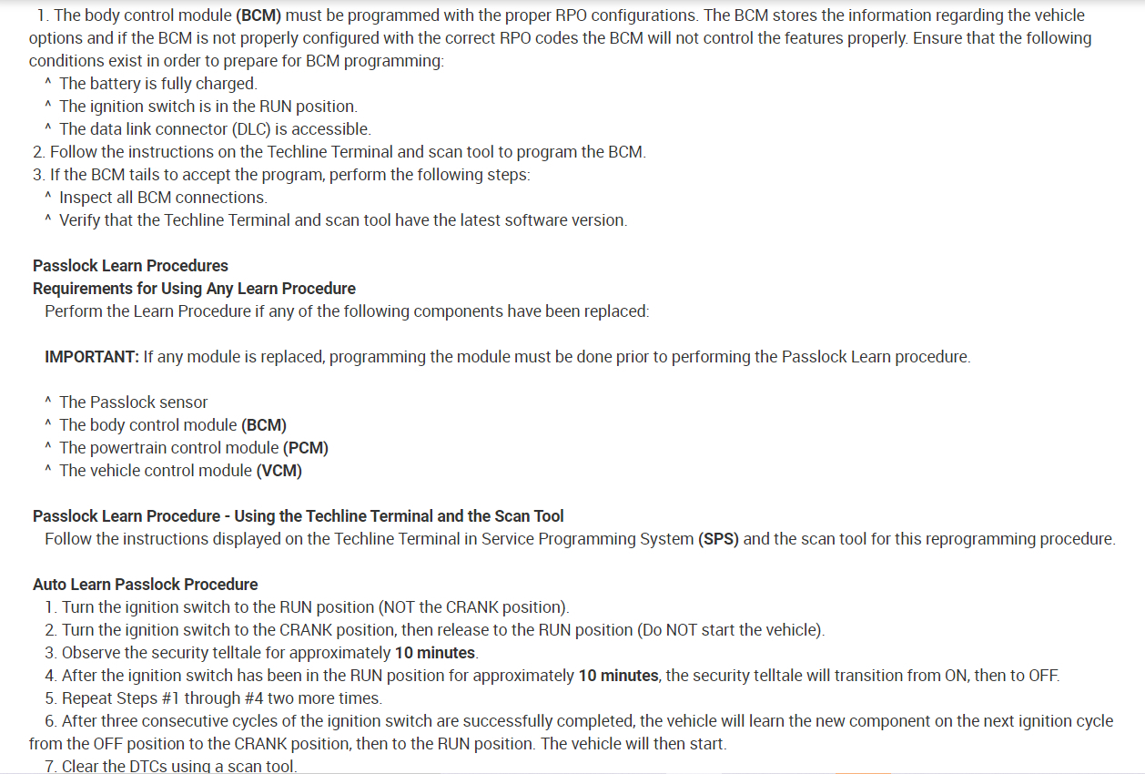

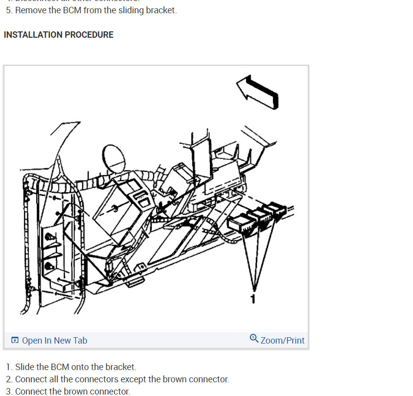

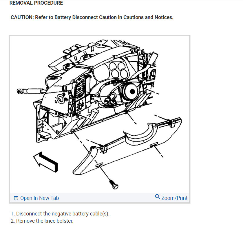

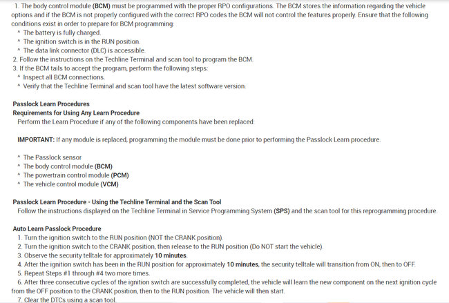

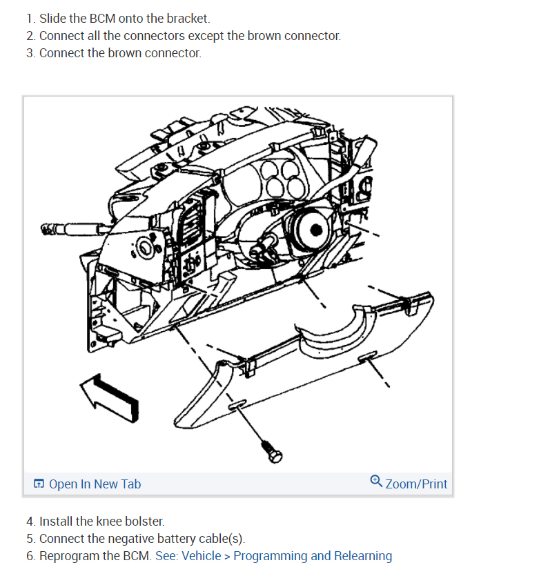

I attached the procedure for replacing and programming for you if it is the BCM.
https://www.2carpros.com/articles/how-to-replace-a-bcm-body-control-module
