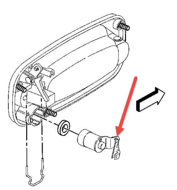

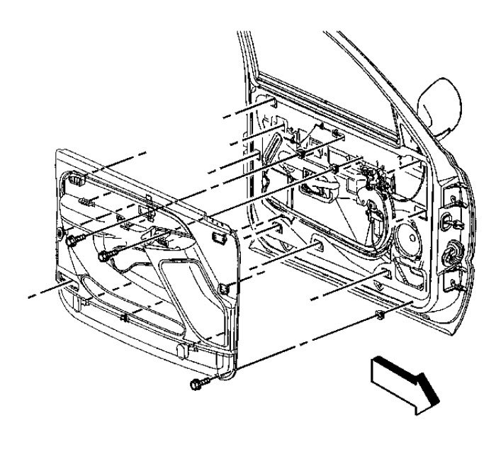

2001 chevy subarban door lock problem. driver door will not lock or unlock anything same with the other 3 but the automitic locks work and the keyless works as well so its not the actuator. i have looked into this and there is so many different fuse boxes on this thing. one works the command door ie driver door one is for the keyless it works fine one is for the automatic locks it works fine one is for on star. can anyone help me. thank mike.

if the automatic and keyless work then it's not an electrical problem. it may be a key lock problem on door or a broken clip/rod. you'll probably have to pull the door panel off and check for this
