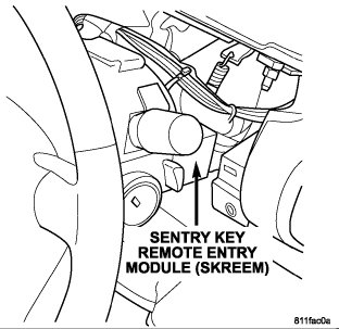

Can you tell me where i can locate the key remote entry module?

The SKREEM module is inside the steering column and is part of the security system that ID's the key. If you need to replace it you need to be able to reprogram it and the PCM to recognize the keys or the vehicle will not run.
