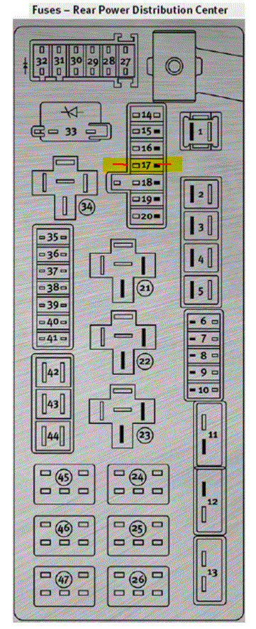

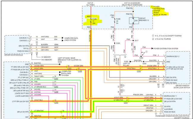

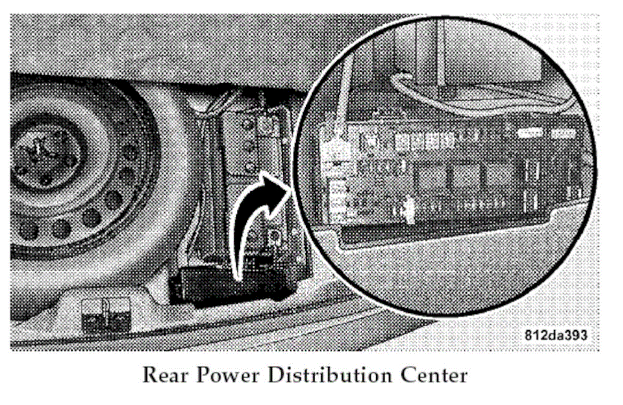

If you can't lock them with the switch in the vehicle, there is likely a power problem. The first thing I need you to check is fuse 17 in the power distribution box located in the trunk.
In addition to checking the fuse, I need you to confirm there is power to and from it. Here is a link explaining how that is done:

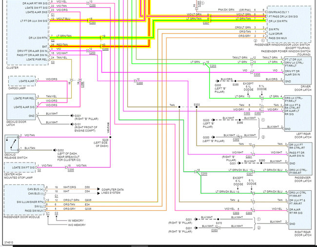

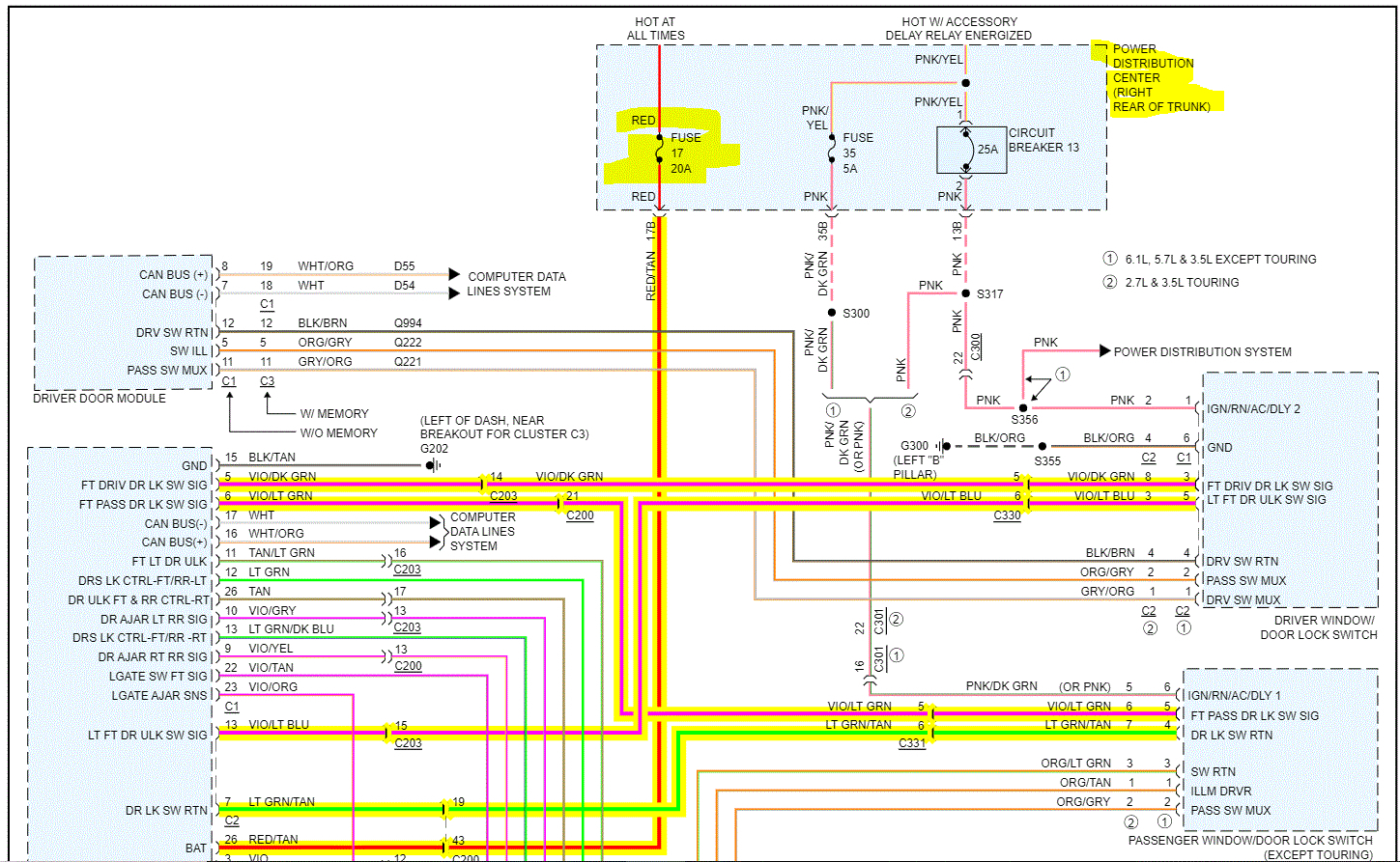

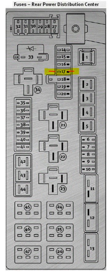

I attached the wiring schematic below for you to review. Note I highlighted the fuse and many of the power supplies related. Additionally, pics 3 and 4 show the fuse location and orientation in the box.
