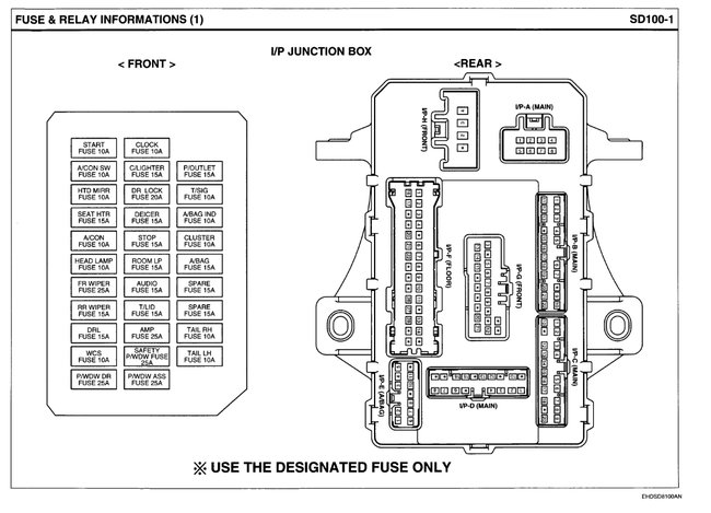

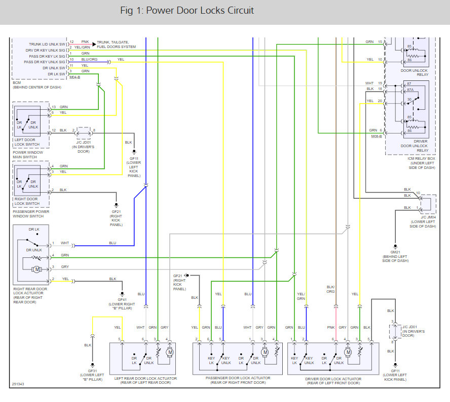

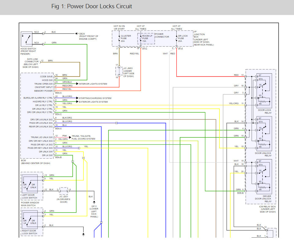

There are 3 fuses that run the system we need to check. here is a guide to help and the fuse location with the door lock wiring diagrams so you can see how the system works and which fuses to check:

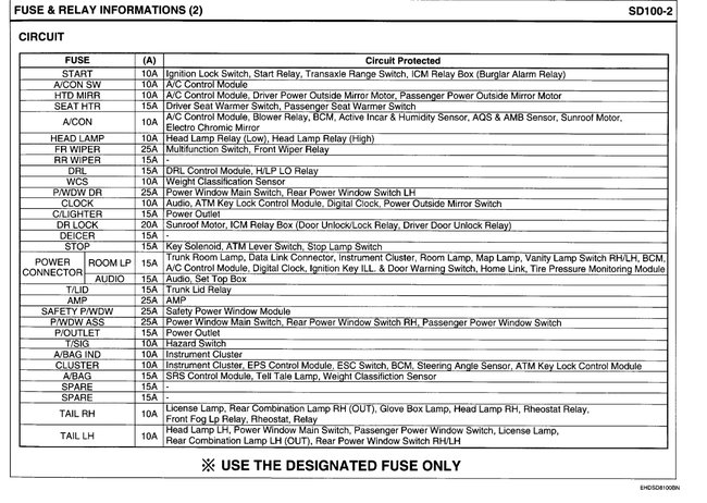

Which fuses on the diagram shall I check? I just went out there and checked ones that I thought and they all look good. But maybe looking at the wrong one(s).
Oct 21, 2019 at 8:12 AM
  • 55,732 POSTS
The Cluster, room LP and DR Lock. Check the fuse power with the key in the on position. Let me know.
