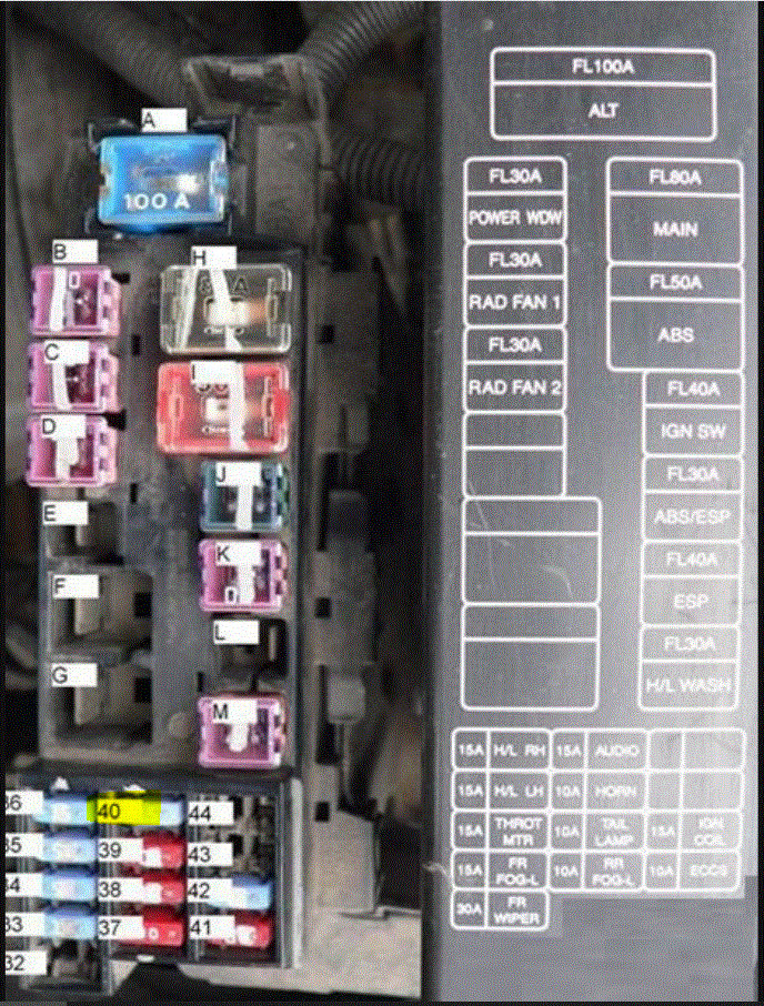

I have problem with my car listed above. I'm no more lock my doors and boot with the doors locked button in the driver door. I think is the fuse but I don't know where is that fuse located. clock in the cluster doesn't display any more. help please

First, this vehicle isn't offered in the US, so I have no manuals specific to it. However, I looked online and found fuse box info. Now, for some reason, they do not list a door lock fuse. However, often times they are in conjunction with the windows power supply. I attached a pic. It is the under hood fuse box and I highlighted the window fuse.
Let me know if that helps.

I found lock doors fuse but if I put on doors locks keep on locking and unlocking continuously until I take the fuse out.

Are you able to check for a good ground? I feel bad I have no schematics to look at to guide you. However, that would be the next thing I would check as well as the switch itself.
