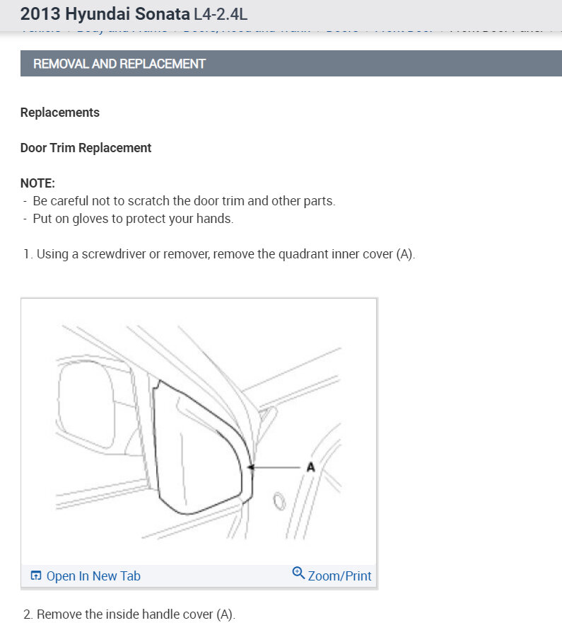

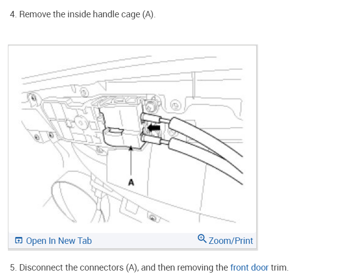

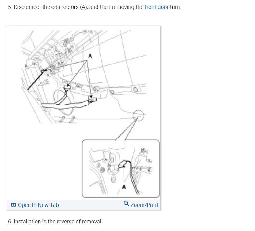

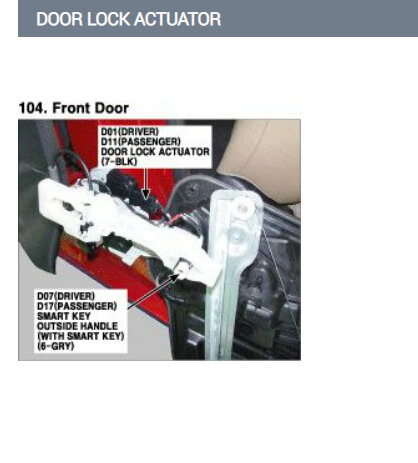

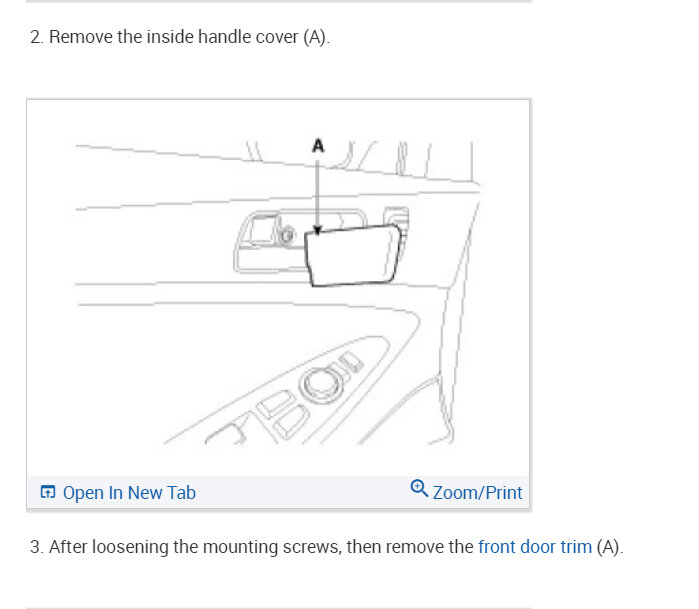

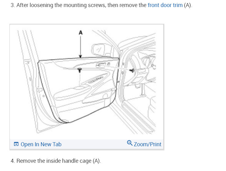

Please give detailed steps and pictures on how to replace a door lock actuator for the passenger door listed above. Thank you
May 6, 2023 at 2:23 PM
  • 55,770 POSTS

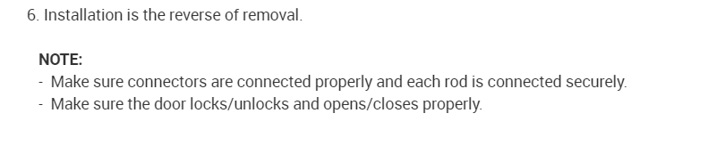

Sure, here is how to change out the door lock actuator on the passenger side first you must remove the door panel. Check out the images (below). Please let us know if you need anything else to get the problem fixed.
