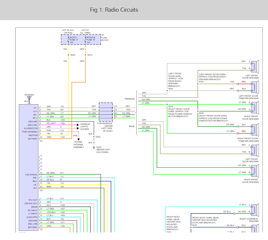

Stock amplifier loses power when door lock button is pressed. I bought the replay that is needed, but do not know where it is located.
Sep 20, 2018 at 12:50 PM
  • 55,423 POSTS

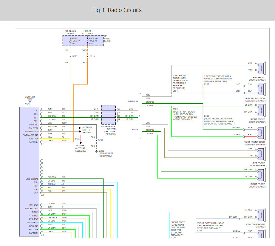

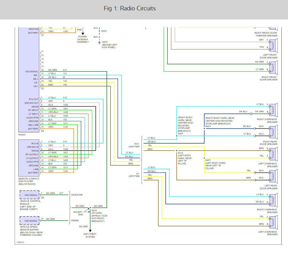

I do not see a relay in the system, but I do see the convenience center and VSS inputs. Here is a wiring diagram for the radio so you can see how the system works. This guide can help as well.
Sep 22, 2018 at 5:28 AM
JONATHAN JUPITER
Thank you, turns out door tweeter cable was loose and touching metal on the door causing stereo to go on protect mode. Diagram was very helpful.
